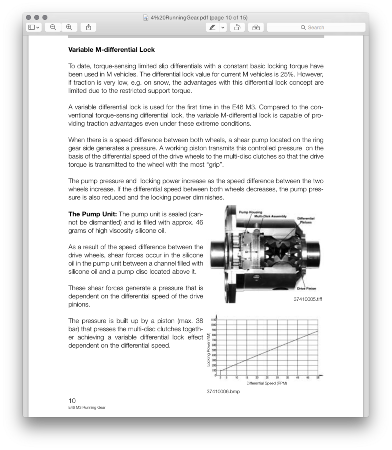

          It is a unique clutch-type design which also features a shear pump. Click image for larger version

            I'm no diff expert, but I'm still reading that it depends on the viscous fluid inside that "pump" to engage the clutches.
            viscous fluid breaks down and wears out over time. it's "lifetime" just like the service interval of most BMW trans fluid.
