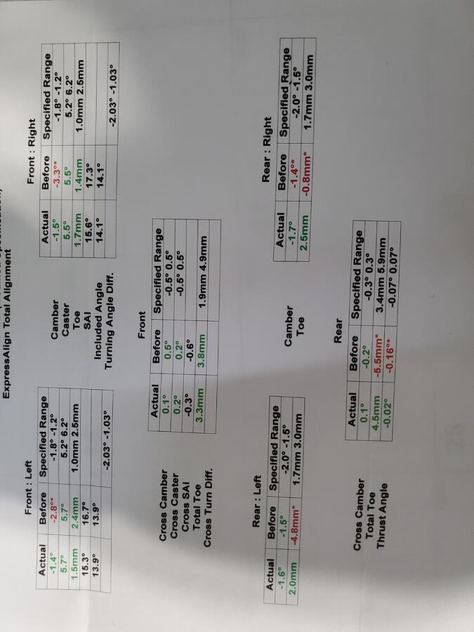

            Will ajusting camber only trow off other alignment settings ? Having to get another alignment?
            had my car alignment done. On paper the camber adjustment numbers are same but looking on the car driver side is tucked looks more cambered than passenger side. Any advice would be nice. Thanks!

                Yeah it's on bc coilovers , this is for the rear of the car tho. I do have ajustable lower control arms as well.
                does ride hight play a factor when doing alignment?

                    Yes ride height is a big factor. What does the print out from alignment shop say? Were they not able to get same values side to side because something is bent and maxed out?

                      This is what the print out sheet says.
                        That says your passenger side has slightly more camber, not the driver side. They didn't get the camber or toe the same left to right, though not a huge delta. I don't like the toe in in the rear, 2mm isn't too bad, but then the other side is 2.5mm. Should have done like 1.5-2mm both sides evenly. And more camber in the rear than the front.
                          Yeah, kind of anoyyong with these so call race shops that "know what they doing" cant do it 100 percent. They easily could of gotten everything perfect. I have all the items installed on car for full ajustment.
                            Ya I hate when they claim "oh BMWs are tricky." No, I have camber plates, tie rods, trailing arms and adj LCAs; you can do it.
                              Yeah exactly, that's what I'm saying. They charge a pretty penny as well. I'm going take it to another shop just for a check and have them print out spec sheet. Prob need to find someone with same alignment machine tho.
