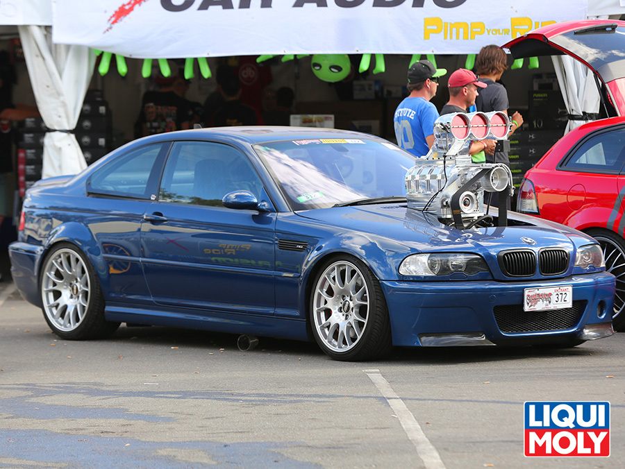

                        In terms of who originated the idea of a topside reinforcement that credit actually goes to a guy in South Australia named AJ. He had an incredible M3 that he super charged, then swapped for twin turbo's and eventually pulled the lot out and went with blown 7 point something litre LS from memory. If I recall correctly he did it way back in 07 or 08?
                        I discovered this when I was part way through working on my own topside reinforcement and sharing progress on some Australian E46 Facebook pages.
                        Here's a pic of his car from a while back from a summernats event. I don't believe the blower was on their for too long.
                        Click image for larger version  Name:	M3_21.jpg Views:	0 Size:	287.2 KB ID:	68431
                        As eacmen said, I believe the original underside plate manufacturer for the E46 chassis was Turner as I recall reading about them having to slap something together over night in order to make a race weekend and that's the product they ended up selling. In saying that, I suspect it was inspired by the underside plates for E36's so maybe the original credit lies with BMW?
