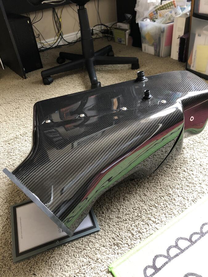

Streamline CSL finally received

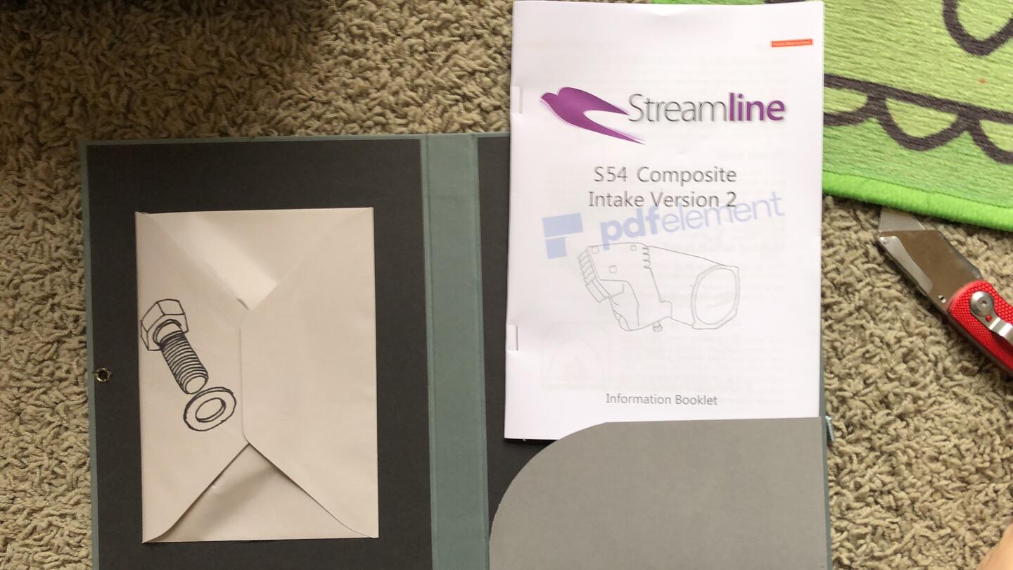

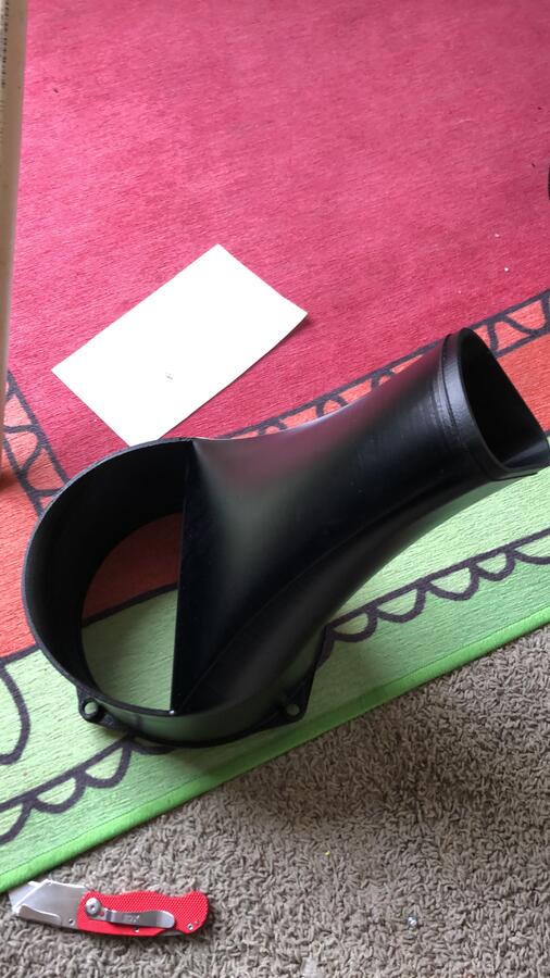

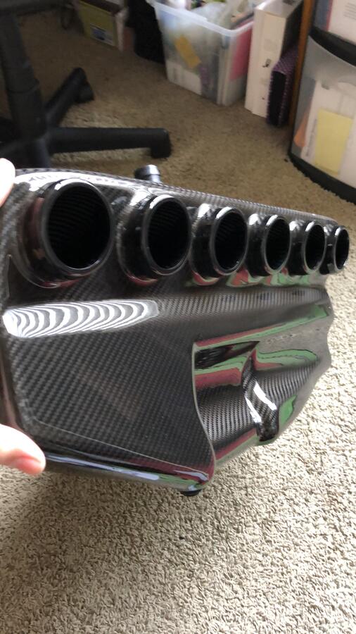

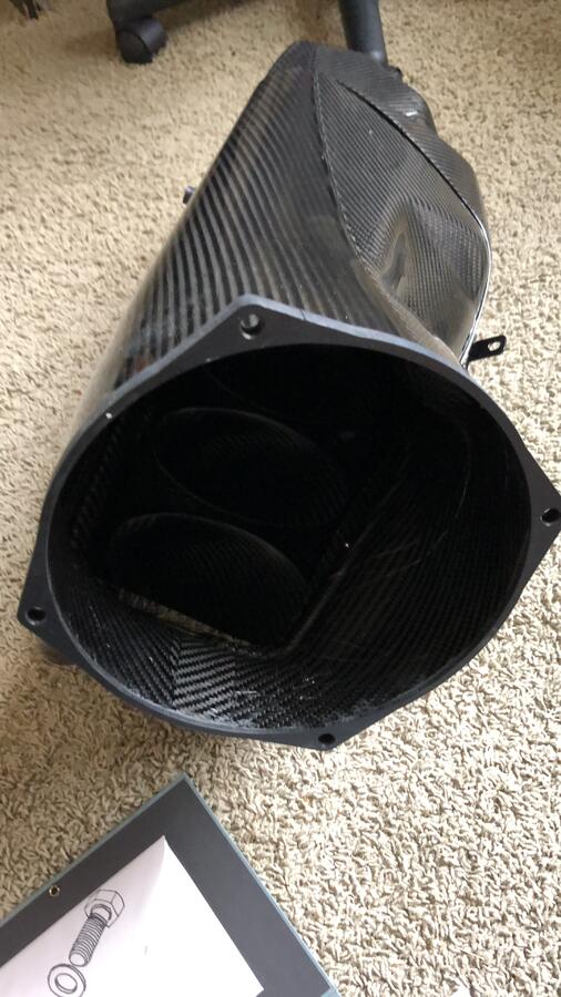

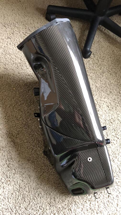

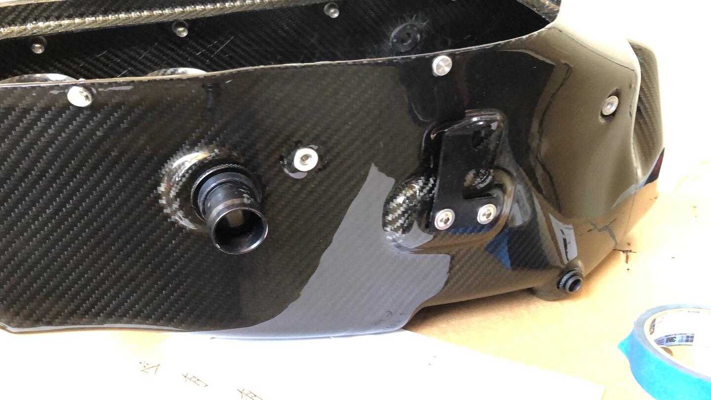

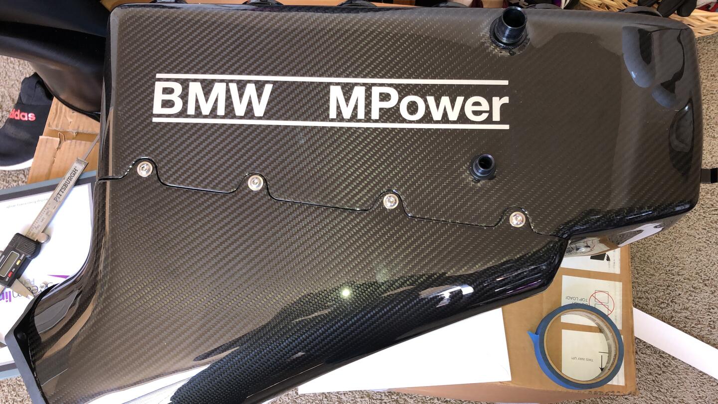

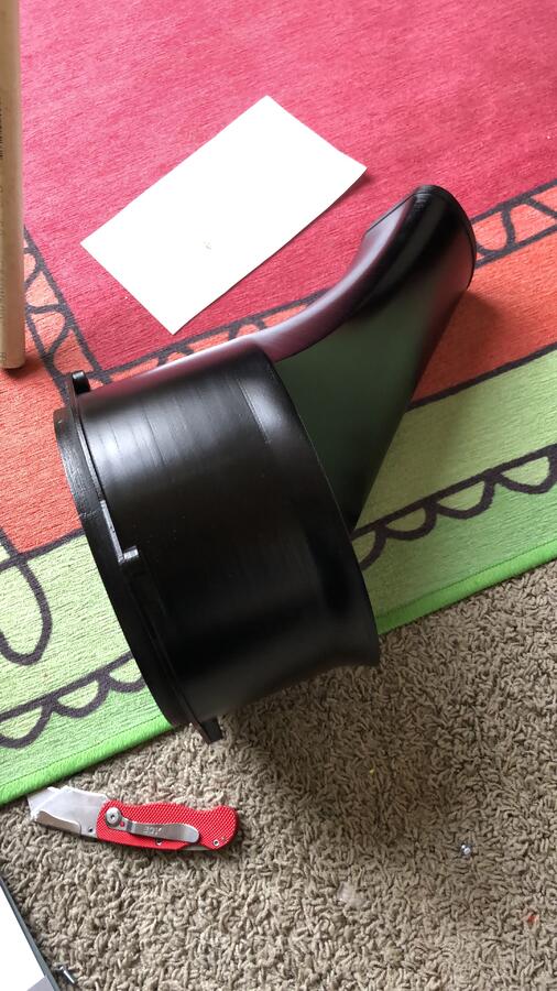

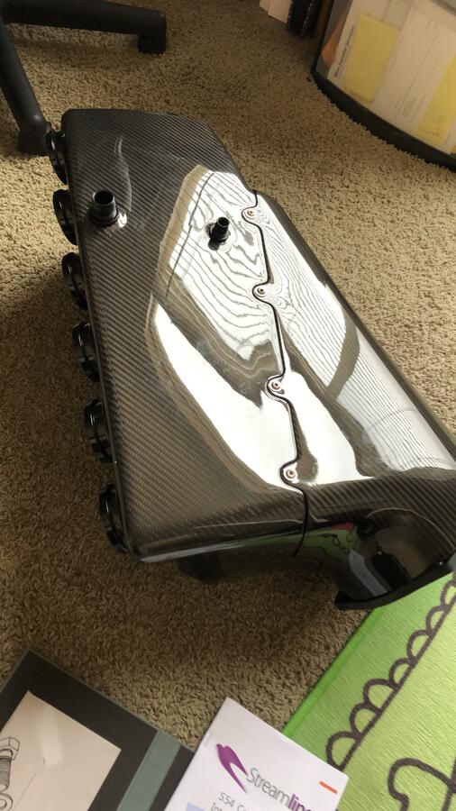

That's not that bad considering everything was forced to shut down. The piece looks nice. I don't see any obvious downsides or major compromises. What's the MSRP on this kit? What hardware do they actually include?

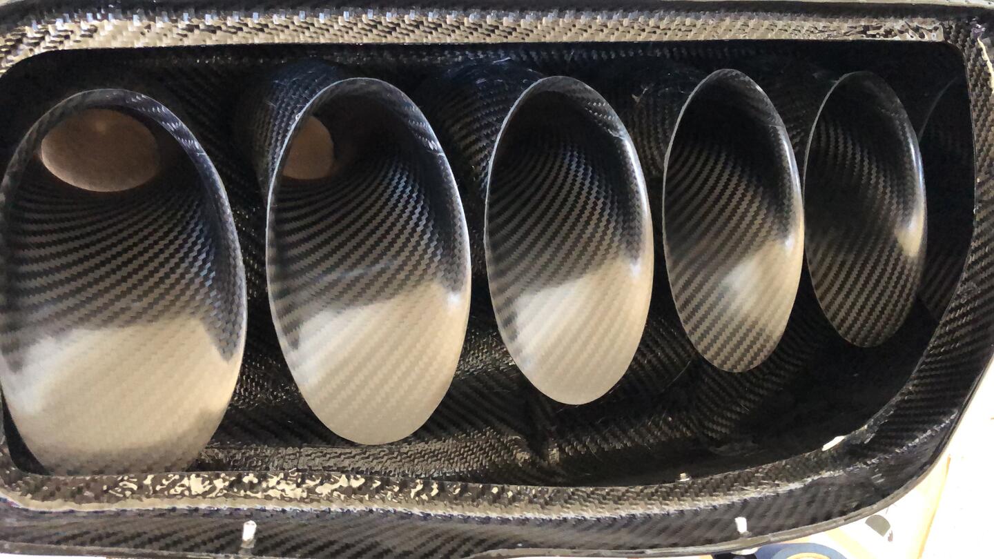

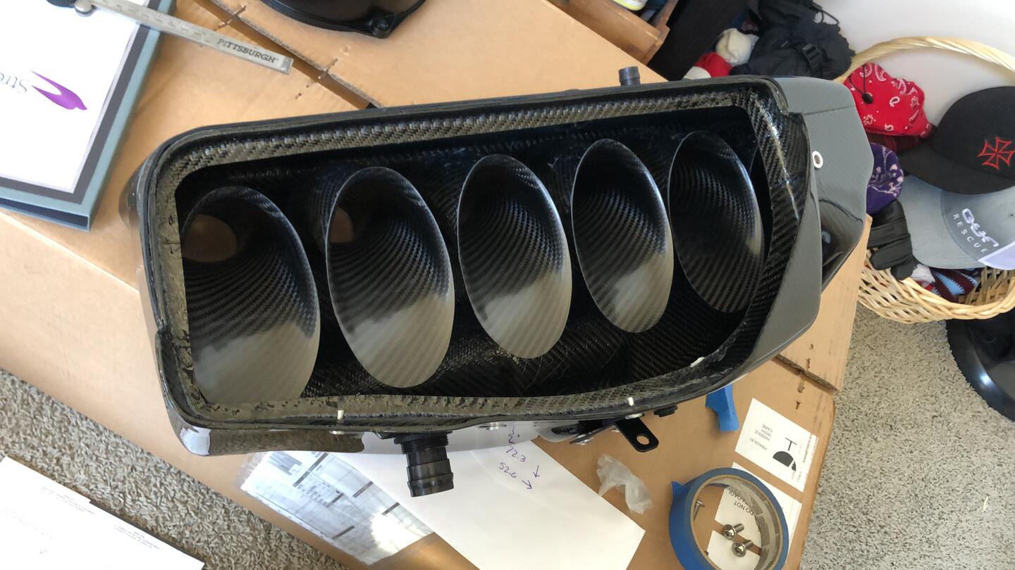

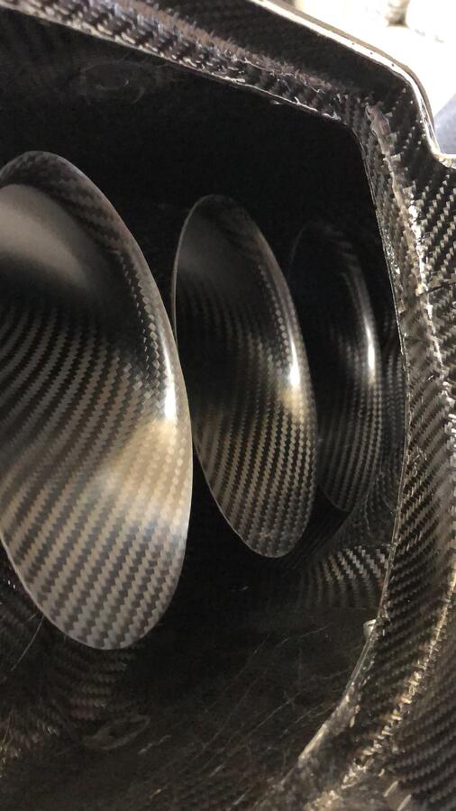

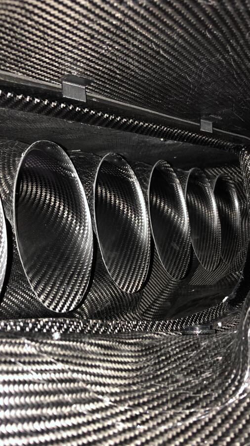

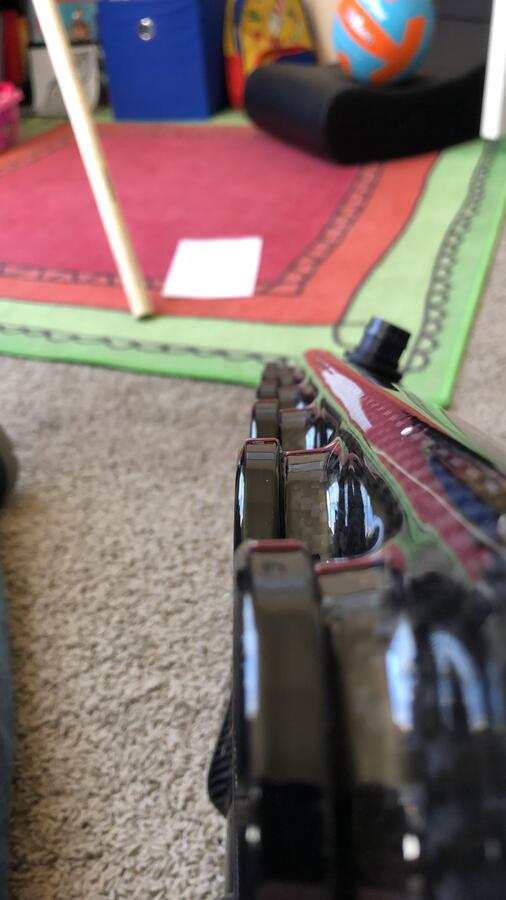

Looks nicer than my 1st gen version! Those trumpets!! Such a shame they get hidden away :/

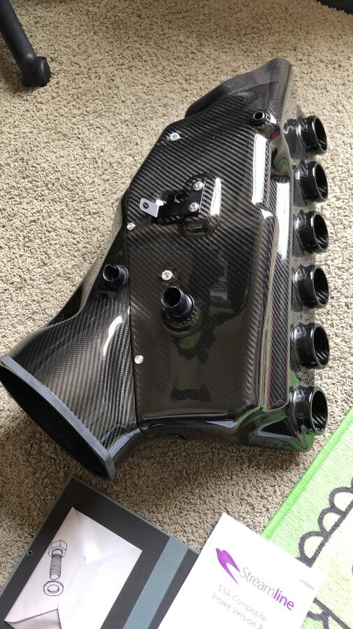

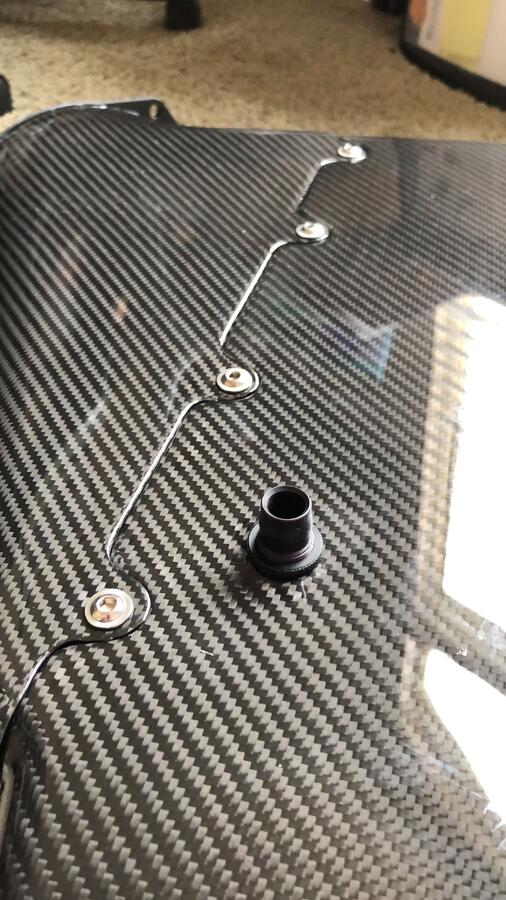

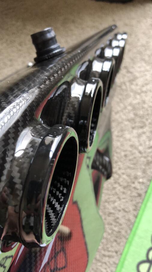

Mine fit nicely onto the ITB's but it was a tiny bit stubborn, I'd recommend ample silicone lube to help the boots slide over them when fitting, also, my vacuum line fittings on the box were a bit tight, I'd also recommend you trial fit these before finalising, would be a bummer to push one of these loose and have to wait for glue to dry so close to the finish line.
