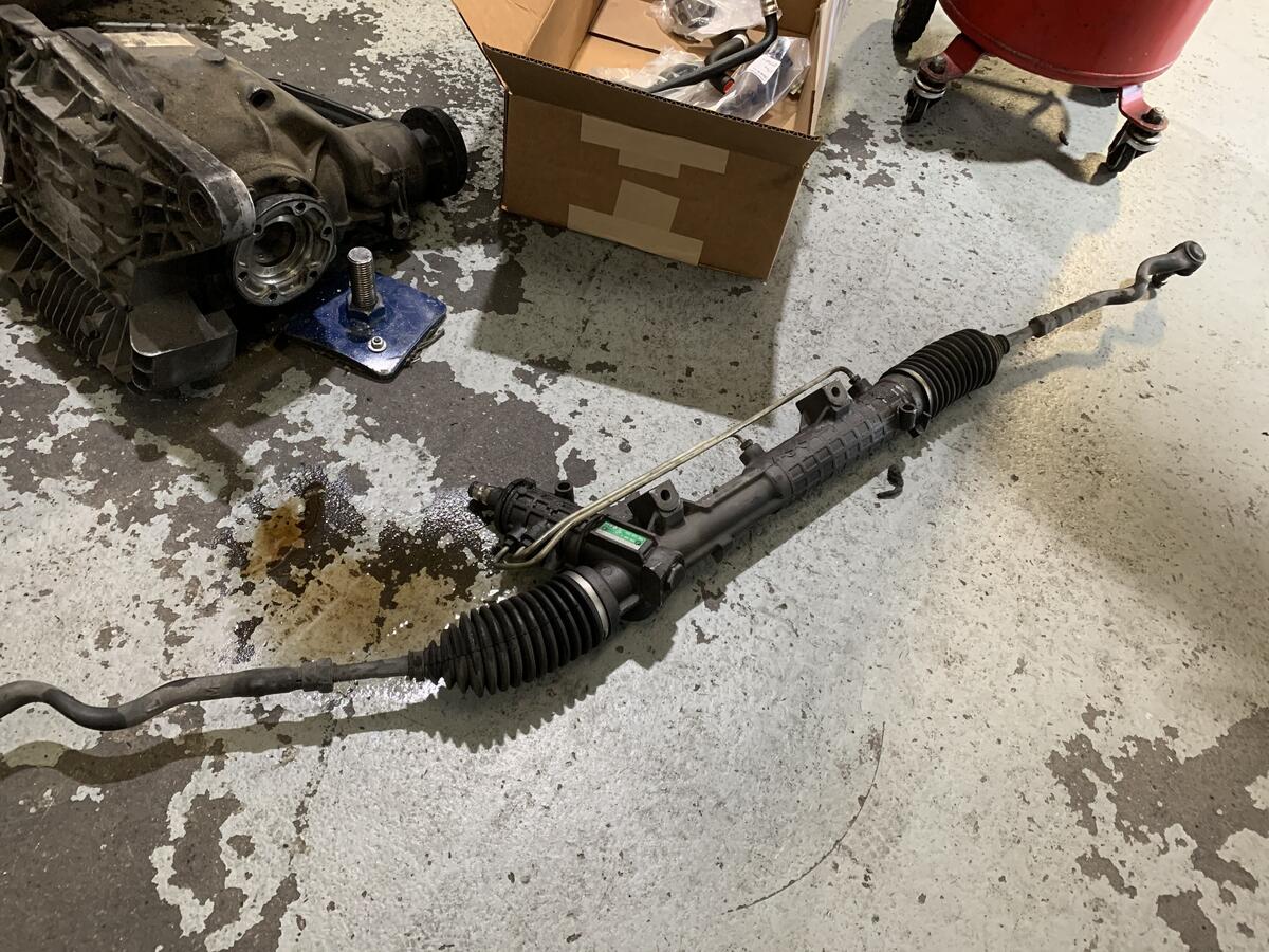

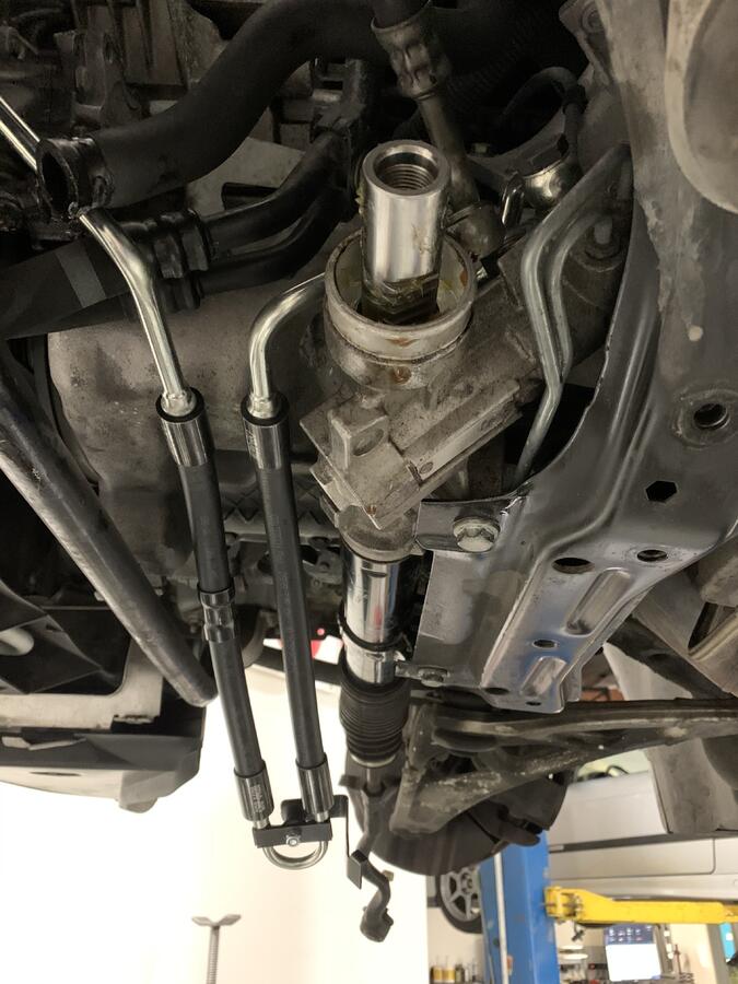

    I recently installed a "green tag" Z3 rack (out of a 1.9L) into my E46 M3. The good news is that all the M3 tie rods hook right up, all you need is the rack itself. I sourced the rack on ebay and had it installed by Edge Motorworks in Fremont, CA (shout out Derek & co!
    The reason I selected the rack is based mostly on recommendations read on other forums. While "yellow tag" and "purple tag" both sounded like improvements, the Z3 "green tag" was unique in that it was quick & linear (EDIT: Turns out all those racks are linear, but Z3 is quickest). It seemed like fellow owners who had performance oriented builds spoke the most highly about this feature, since it nullifies that "dead spot" feeling as you begin to turn the wheel.

        Your first picture is an M3 rack. Does look like that last picture is a a Z3 rack with its half stamped steel body.

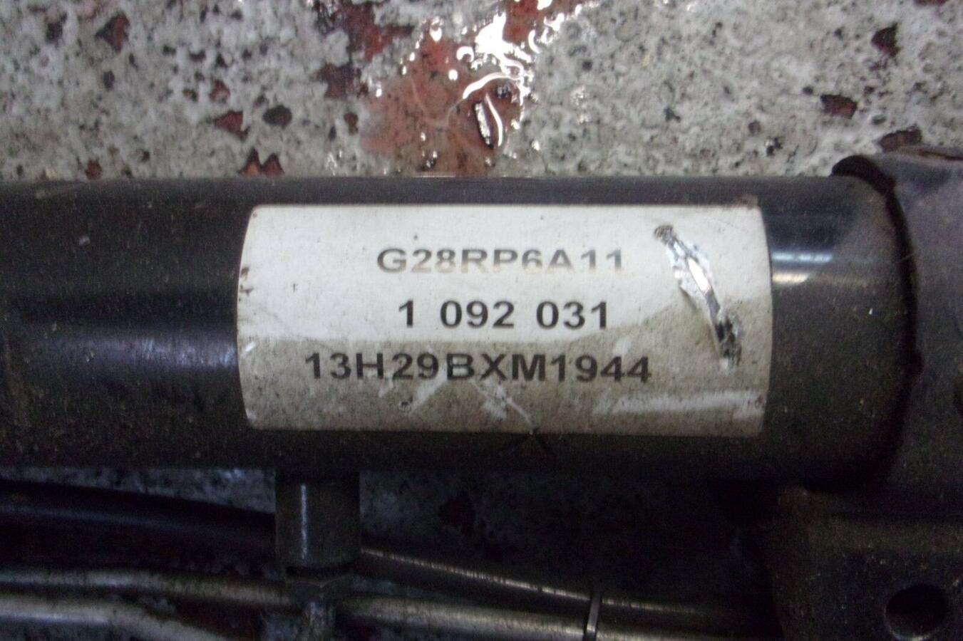

                  Also, would you mind sharing the part number of the Z3 rack? The 455 rack in the picture is M3, no? Is the 1.9L Z3 part #32131095575?

                              Originally posted by ridebikes View Post
                              1999
                              Interesting, I’d swear tag shows ā€˜04?
