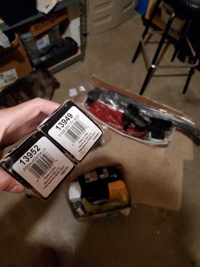

    Those are the correct sensors for pre-cat, just went downstairs to check the boxes as I replaced them when I did my headers.
    I would say to go ahead and change out the post cat sensors if you have any doubts as they are no longer accessible in the Euro sec. 1 without dropping the exhaust.
