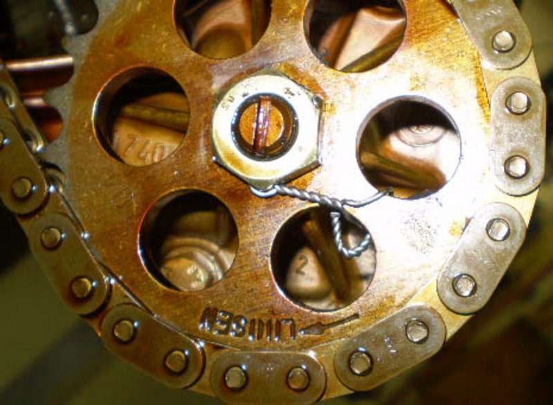

                            Out of curiosity, what do you affix the safety wire to after it's looped through the nut when doing the oil pump nut?
