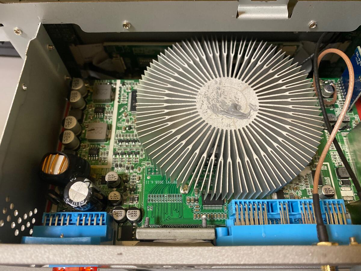

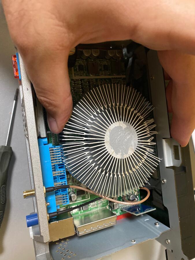

                      It's a pity, of course the technique is a little damp, but after spending literally a day looking for answers in Google, you can solve 99% of all problems, and then the radio will become very convenient and good, but you also need to finish it with handles, for example, adding cooling Click image for larger version
