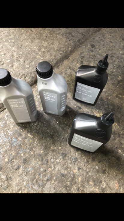

          I almost went with different transmission and diff fluid. I was going to do redline or liqui moly. I ended up going the OEM route instead. Sorry to hear about your situation bro.
