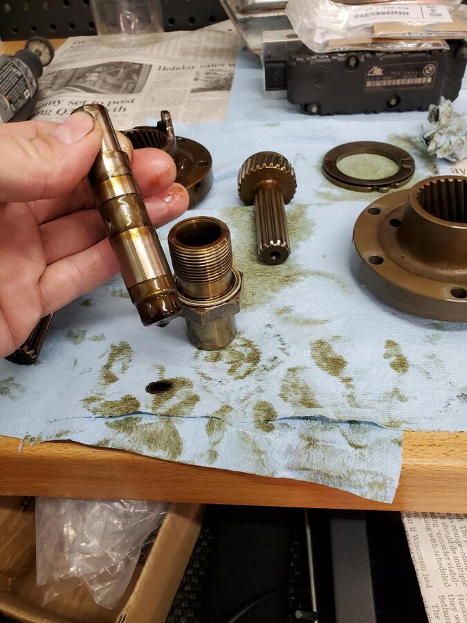

    I took out the timing chain tensioner so I could remove the exhaust sprocket from the timing chain.
    When I removed the tensioner curiosity got the best of me and I pulled the "piston" out and a decent amount of oil drained out as I had the tensioner held sideways.
    I reinstalled it (using my only one and only new crush washer) and now I am wondering if it needs to be removed and filled with the oil that I emptied out of it to prevent damage upon startup.
    I didn't see that there was any type of spring inside of it, just seemed purely hydraulic.
    Should I be removing this and putting motor oil in it or am I overthinking this? It didn't empty it ALL out, but still makes me wonder if during initial startup this may cause a problem.

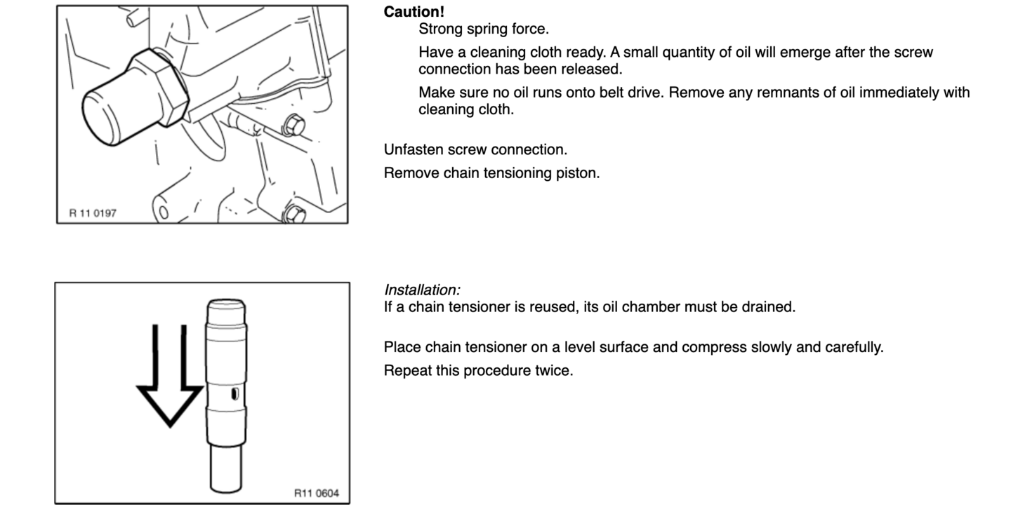

      Very helpful, thank you.
      I would say I emptied the vast majority of oil from the tensioner but did not compress it 2x like denoted above. I guess I'll have to wait for a new crush washer and do this correctly.
      And just for peace of mind, there is no spring in this assembly, only oil, correct?
      I took it apart and just want to be sure I didn't drop a spring out of it and somehow not see it drop to the floor.
        Pretty sure it has a spring (document even says "Caution, strong spring force"). I'd double check.
          It must have spring inside in order for the piston to expand after collapsed by the chain; the cycles repeated as needed, automatically as engine idling until it filled with oil.
          Dont need to remove and compress the oil out 2x; you had drain the dirty oil already. It’s not crucial to do this step. You’re sure the spring didn’t fall out?
          Run engine at idle and if the chain slack noise doesn’t go away after a short time then time to remove and look for the spring.

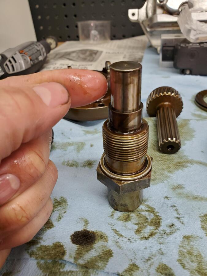

            Pulled it out...there is a spring, just not visible. The spring is inside the section my finger is pointing to.
            Meh, now I need a new crush washer, but peace of mind is worth the few days of setback waiting for a new crush washer.

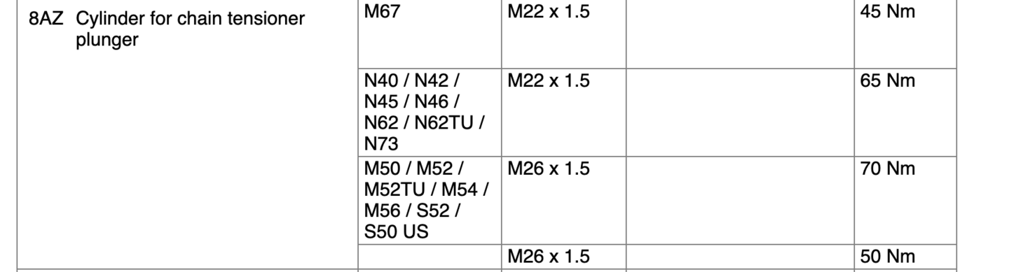

                Not sure. Beisan instructions just said to reinstall it without releasing the oil. And the tightening torque is unclear

                  Well I did the 2x compression and a bit more oil came out, it looks as if introducing new oil into the cylinder would be difficult to say the least. I hope it fills up quickly upon startup..hmm.
                    There is a spring in the thinner cylinder which usually comes out all as one.
                    Torque is about 50 Nm, 37 lbs ft.

                      ​​​​​​Post #8, says m26x1.5
                        Originally posted by M3powerzz View Post
                        https://nam3forum.com/forums/forum/m...sioner-w-o-oil
                        I noticed that too; can you measure the male threads diameter?
                          I will when I get a chance.

                              TIS instructed to empty the oil to avoid breaking chain guides if the tensioner somehow shucked in more oil and caused the plunger extending too long.
