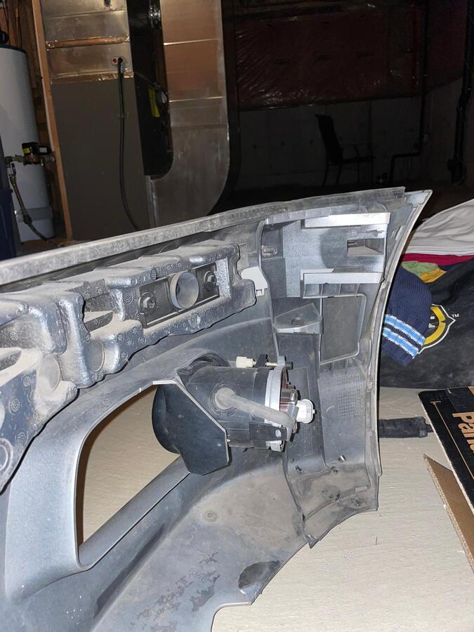

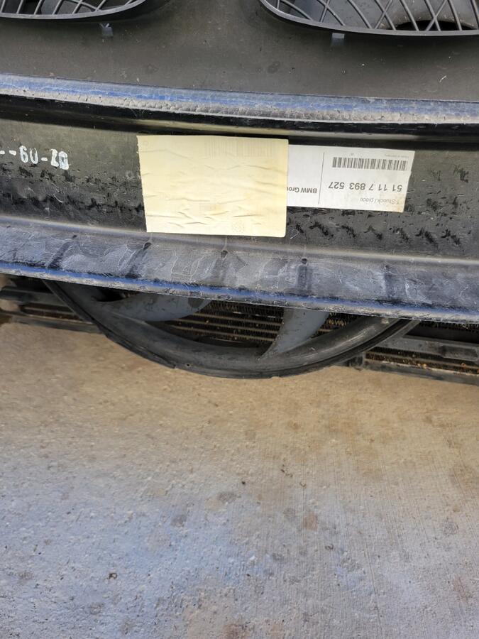

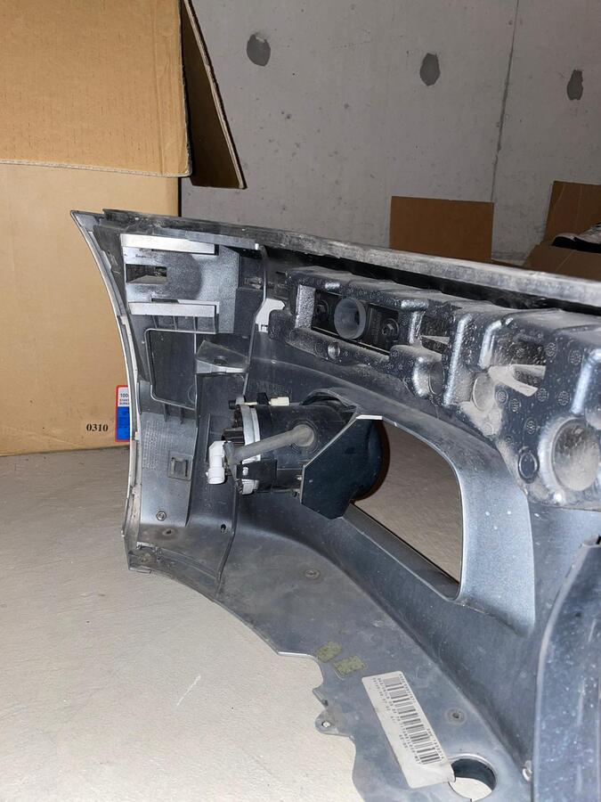

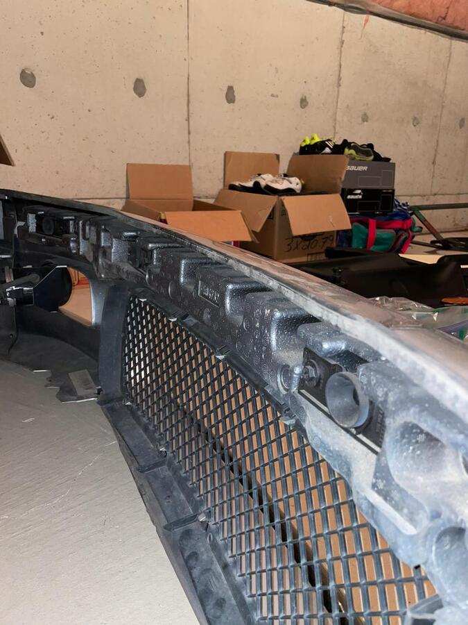

    Here are a few pics. Is this bumper for the aluminum or Kevlar carrier? It’s off a 2002 so could go both ways
    Looks like the Kevlar version as it has the fixed foam insert with the ball socket mounts
      That’s what I thought. Thank you for the confirmation
        Kevlar.

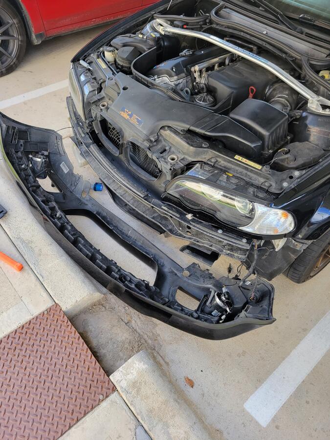

          I have a 2002 M3 that needs a new bumper. The car had the carrier replaced in the past. Does this look like the kevlar version? Looking up the part number I don't see it listed. The bumper has mounting screws in the bottom which looks to be contrary to kevlar but could have been a body shop error. Photos attached.
            Hard to tell since it’s dirty but the Kevlar carriers will have a noticeable weave pattern and non glossy finish. Seems like maybe an aluminum carrier painted black
