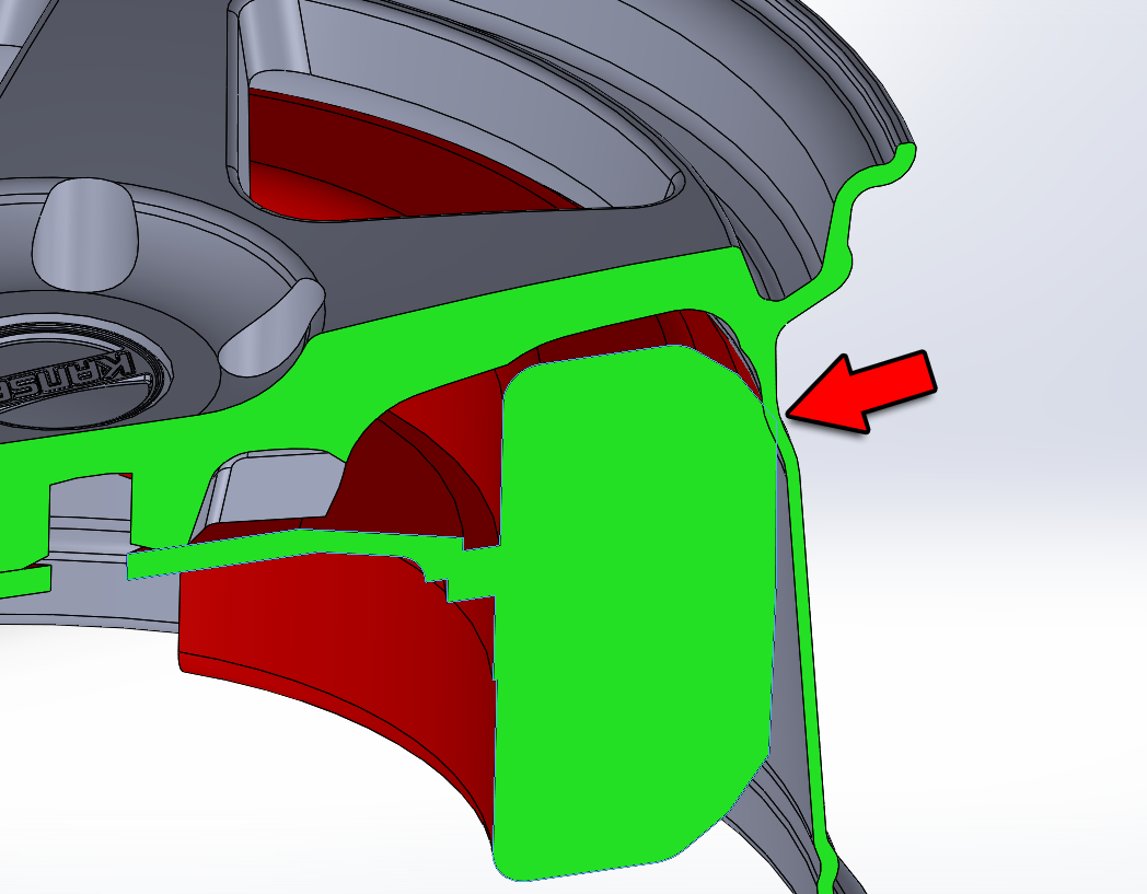

    FYI, I have been working with KANSEI to see if the 17x9 ET35 (5x120 of course) KNP will work with the Brembos. I generated a model in CAD based off the cross section drawing from Brembo and had KANSEI assemble with the wheel. They believe the brakes won't work with a 17" wheel (see attached) but I am a bit skeptical as the Brembo drawing doesn't clearly define the caliper edge in question.
      My Forgelines are 17x10 and they clear my Brembo GTR setup up front with 355mm rotors. Options are out there.
