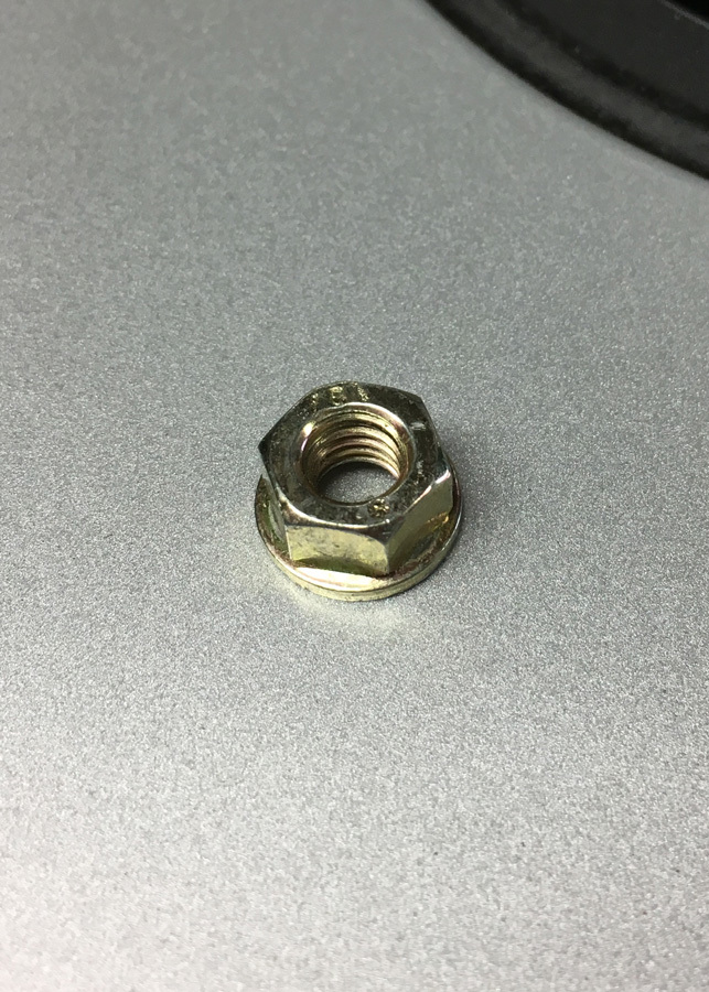

Here's what the bolt looks like:

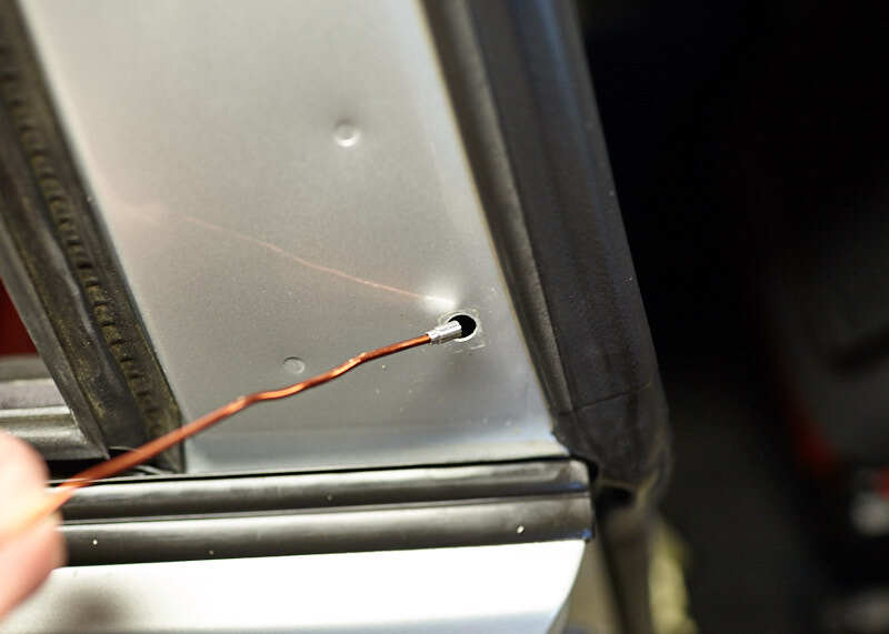

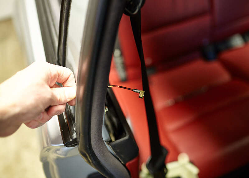

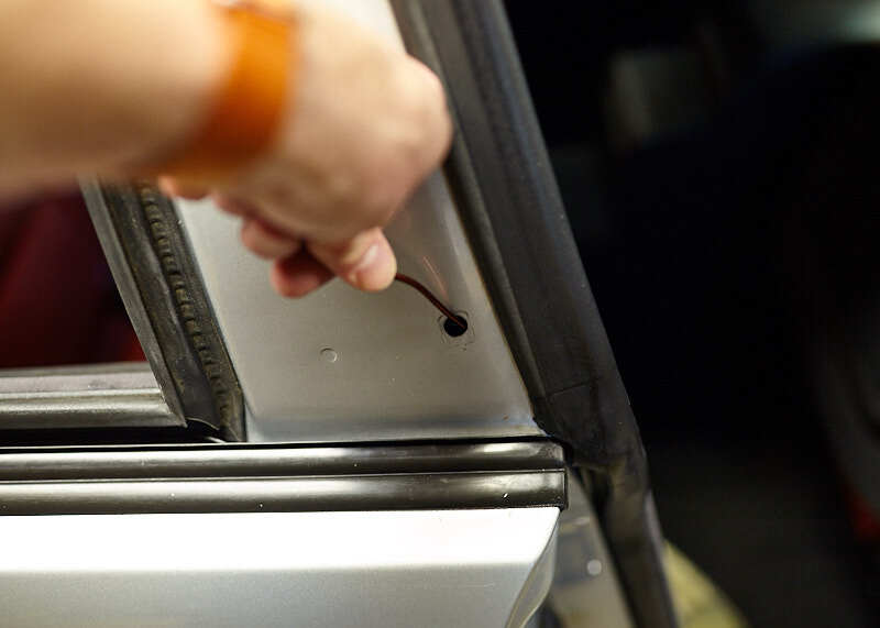

I inserted the magnet from the outside lower hole of the car.
