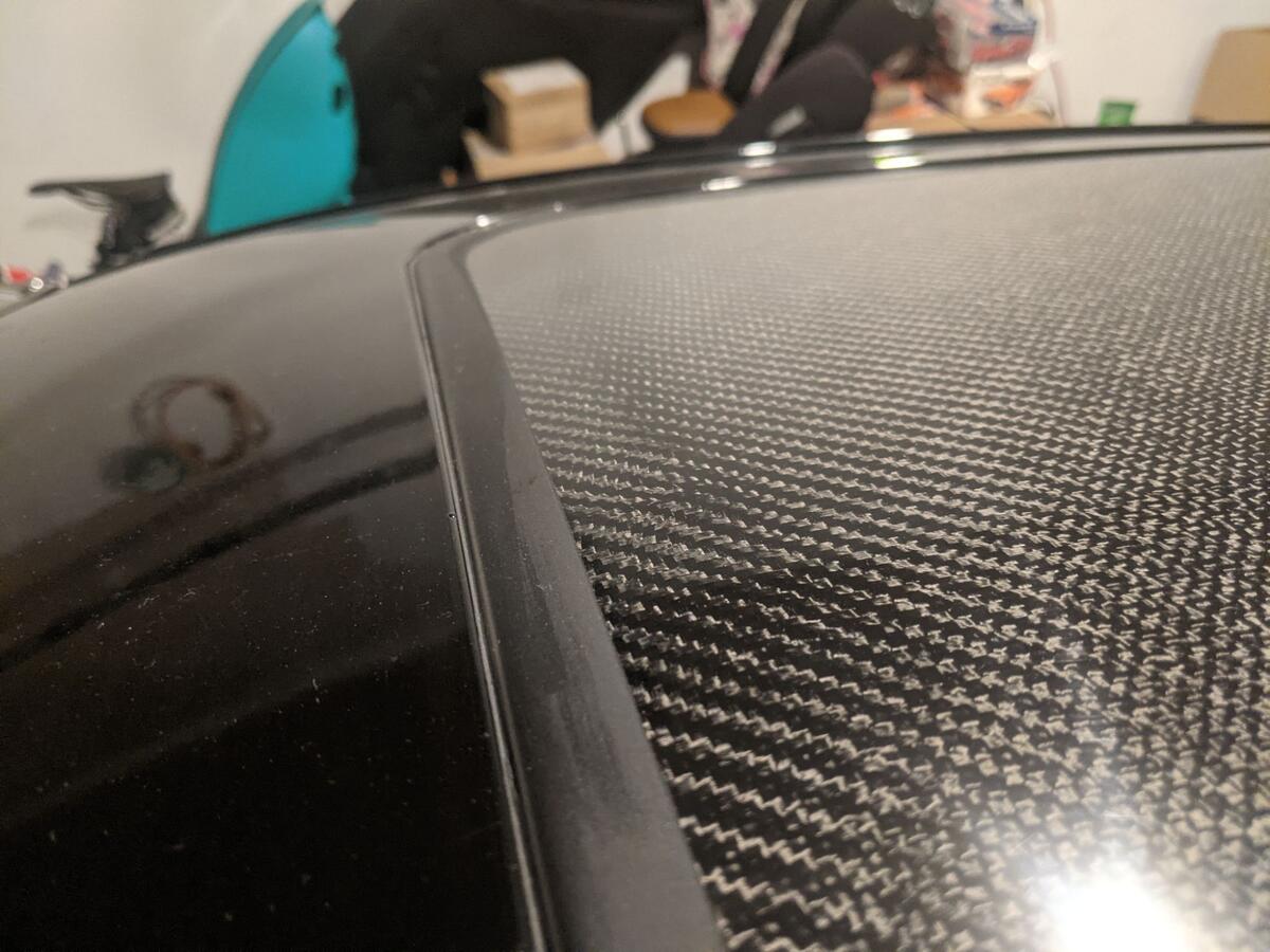

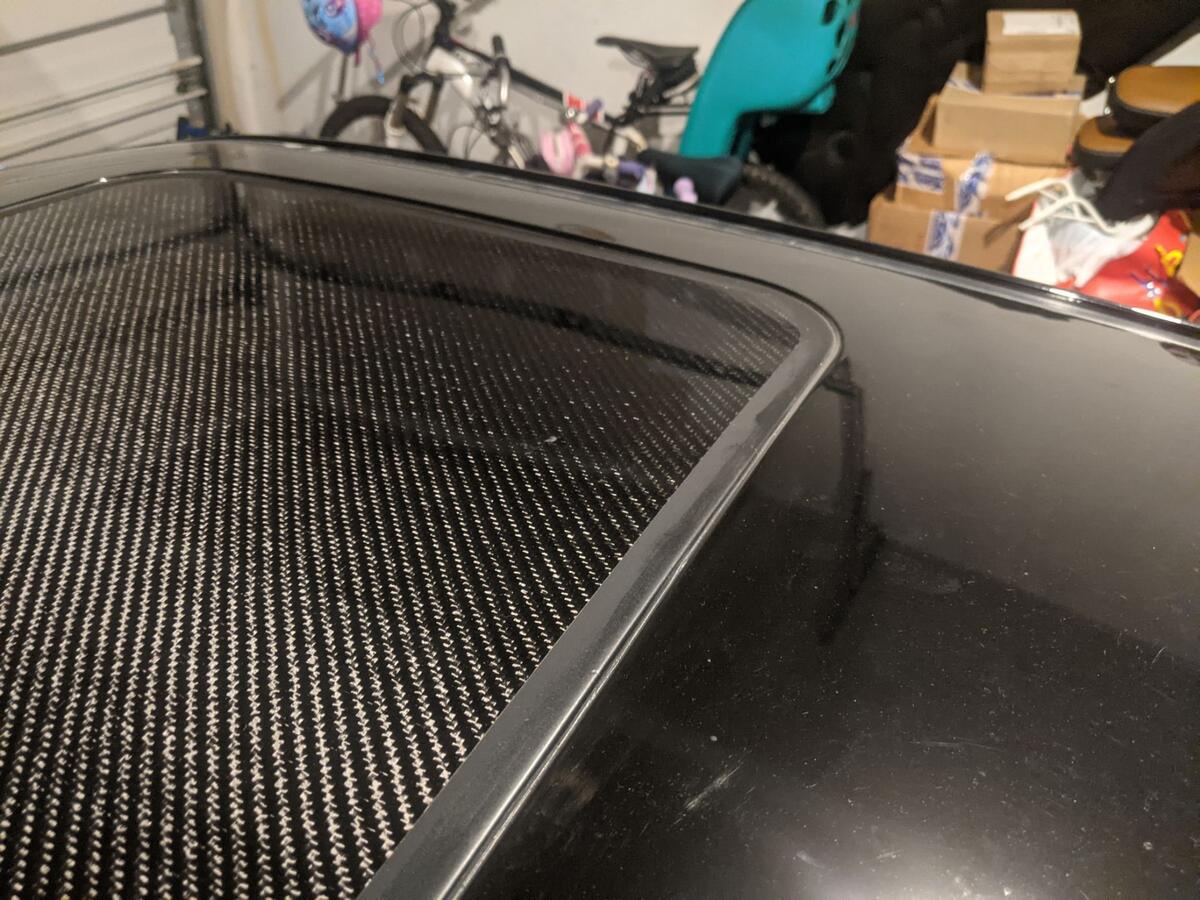

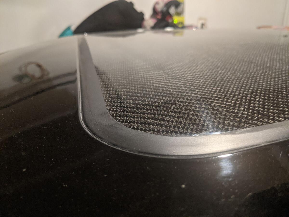

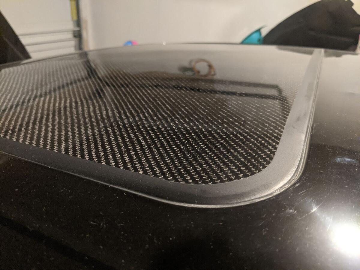

                    Well, I can tell you that the black you see in the image isn’t CF. That’s fiberglass. And the underside of the CF is fiberglass too. I still think it’s worth it to avoid the hassle of painting but it’s 100% not all CF.
                      As far as your comment on fit - mine had a full half holes drilled right at the edge. One hole was drilled into the edge making it an open "C".
                      I had to create stacked washers to secure it. No way screws would secure it at the edges.
