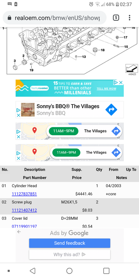

      On the front of the engine there is a plug that is pressed in but its covering an oil passage, not coolant. Maybe it was a leftover hole from casting?
      Calling it a freeze plug is probably incorrect, but it certainly looks like a freeze plug and installed the same way.

        You appear to be correct. Looks like is may be the oil feed to the cams or something. It covers something up rather than it having any purpose as a freeze plug.
