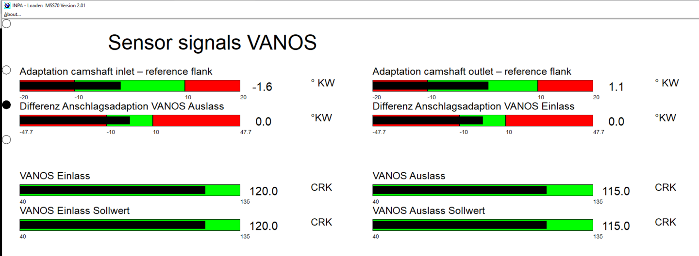

              Click image for larger version  Name:	Pos-Rebuilt-VanosAdaptation.PNG Views:	0 Size:	142.5 KB ID:	79598
              For reference, below is what I had before doing the VANOS, it wasn't "perfect" either, on the image below the engine was not running, so you see there is not variation from what the ECU requested, vs what it was getting, on the image above, engine was running, and with the adaptations, you can see that the ECU gets pretty much what she wants.

              Don't lose sleep on this, you may actually break something trying for perfection, and then you will hate yourself (been there!!)
