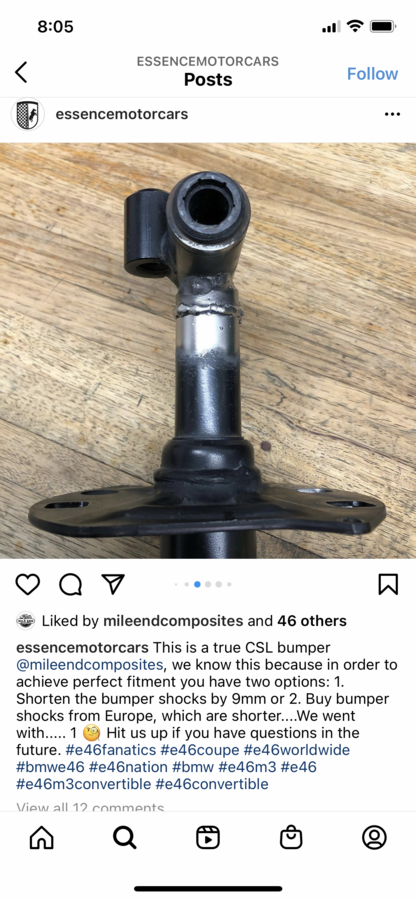

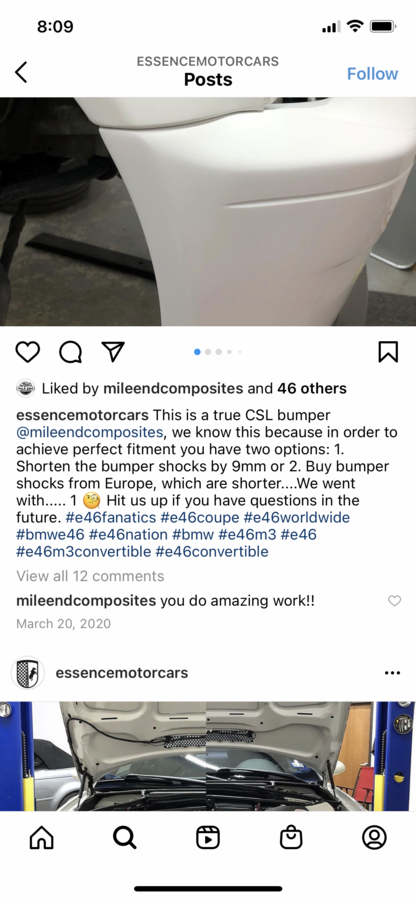

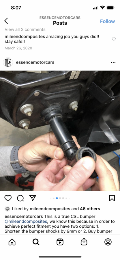

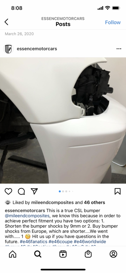

ID:	80061 While browsing on Instagram, I noticed this shop say the euro bumper shocks are shorter by 9mm than US version. Why are euro ones shorter?
    After cutting the US version by 9mm, the fender to bumper fitment looks 100% better. I noticed many csl bumpers, even factory ones have this issue where it looks to be too far forward.
    Looks like the euro ones they are saying to use are rated to 4KM/H while the US spec ones are 8 KM/H.
