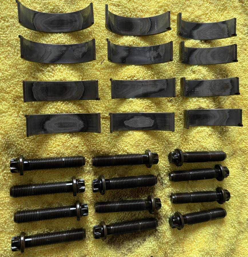

    Originally posted by skylinekin View Post
    2005 with 134k on the original bearings, a bit of copper showing on a few. Oil pump upon inspection had wear marks enough to require replacement.
    These 134K bearings are in the same conditon as the previous posted bearings at 85K, a 50K miles difference. Maybe this car was on longer trips with less wear.

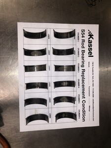

  • ~CSL~
    replied
    Adding my 2006 ZCP Bearing Replacement pic to this thread. 85K miles - no Blackstone report to load, but was told by the previous owner, "all good"

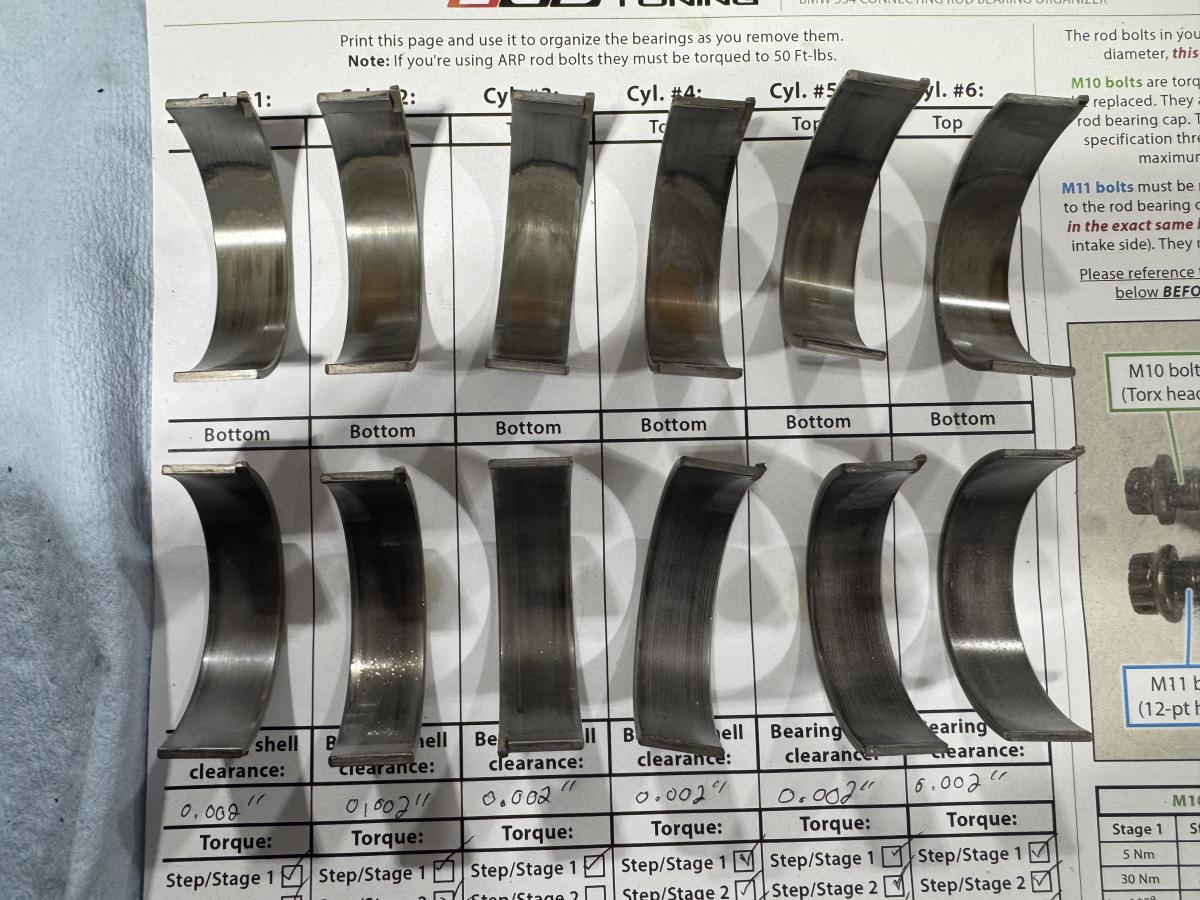

  • 0-60motorsports
    replied
    Originally posted by Ramage View Post
    My 2004 Vert at 135000km / 83000 miles - I am the third owner having picked it up in 2012 and there is no doubt my car was treated like crap prior to my ownership. The number of half assed repairs and simply wrong things I had to correct in the first 3 years of owership was nuts.
    Click image for larger version Name:	image.png Views:	0 Size:	857.4 KB ID:	360748
    Number 5 definitely spun at least once, given the witness marks on the back of the bearing. Near as I can figure, the tangs kept it from spinning more than a few times since they're still intact. I got incredibly lucky twice: first, that I didn't grenade the entire engine, and second, that nothing blew up after I completely missed those witness marks, threw new OEM bearings in, and buttoned it back up.
    Click image for larger version Name:	image.png Views:	0 Size:	91.6 KB ID:	360749​
    Since then, I've put 20,000 km (13,000 miles) on the car and while the very first oil analysis after the replacement showed elevated Copper(12ppm) and Lead(19ppm), the last three reports have come back clean with nothing in the filter and no cold start knocking.
    Nice save.

  • Ramage
    replied

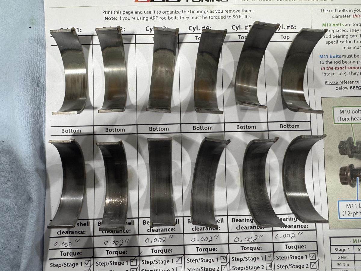

  • M3Mino
    replied
    Here is mine done around 89K miles with about 15K VF570 supercharger miles on it.

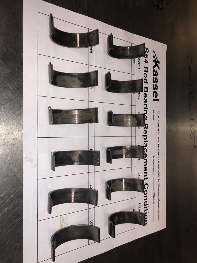

    Originally posted by nsa View Post
    '06 car, 105k miles on the odometer. Rod bearing history is unknown, I assume they are the originals.
    Nicely done at the right time.

  • old///MFanatic
    replied
    True you don't know if anyone replaced before. But I agree that it's unlikely (if that engine is original @105k) that they were replaced already with that wear showing.

  • sapote
    replied
    '06 cars didn't have bearing recall, so these are original, your timing is perfect for a new set.
    Leave a comment:
  • nsa
    replied

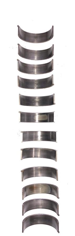

  • E46 M3
    replied
    showing copper are the top halves. A bit surprised that they worn this much for 67K miles.
    Agreed, my old M3 had over 130kmiles and the new owner recently did them and they looked better than mine...
    I do know however that previous owner was an exec lady that had a huge commute and seemingly drove it well.
