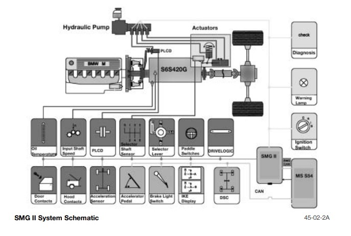

          Check for water or damage to your SMG control unit and the harness. See if anything cut a wire. The connector could've slipped out of the bracket and was never put back in previously. This is a communication issue with the unit so I don't know why a brake switch wouldn't throw a CAN fault. The brake switch isn't on a CAN line unless BMW does it weird. Still worth checking anyways. I would say something isn't talking to the SMG tell it to go. Possibly a DME issue. Can you see any PIDs in the TCM through INPA or can you even connect?
            Actually the brake switch is on can.
              Click image for larger version  Name:	SMG Logic.jpg Views:	0 Size:	63.8 KB ID:	80724
              Of course it would be. BMW: 1 Me: 0
