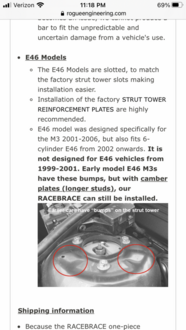

  • RoyalFlushness
    replied
    Click image for larger version  Name:	47D99BD7-DA37-43B8-89C0-C3498F0FF16C.png Views:	0 Size:	271.9 KB ID:	83080
    As per Rogues website, early model e46s would also need the front reinforcement plates in order for the rogue strut bar to fit. The strut towers are a bit different than newer model e46s.
    Interesting. I just ordered a DMG Bar so we will see. I fully forgot that the early models were mushroomed. I searched BAT fro some 01 Models and looks like a strut bar can be installed (looks like the mounts are barely threaded on in this picture) Wonder if it still provides the same structural support as it would sitting flush to the strut tower.
    Leave a comment:

  • old///MFanatic
    replied
    That should not require the "reinforcement plates" to make it work. Just longer studs. Reinforcement plates fit underside of the strut tower on E46. Think they're just saying because of the "bumps" on the earlier tower tops it sits higher up and has less threads of the stock studs exposed to attach the nuts to.
    Leave a comment:

  • DropTopKingM3
    replied
    Originally posted by RoyalFlushness View Post
    Anybody have any input on how much of a difference a strut bar makes on our vehicles? I have an early 01 pre LCI with no strut bar and have been eying the Rogue Engineering bar as my car starts too see more action.
