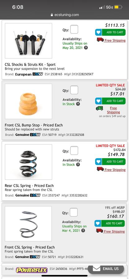

    looking for suspension upgrade. I was looking at Bilstein B16 PSS10 or Ohlins’ but then saw the CSL sport kit. Anyone has any experience w/ the CSL shocks and struts? How’s the ride/ handling and stance???
    my car is mostly just regular driving, (not a daily)
    might see a track day every once in a while - just for fun.
    thanks!!!!
    It will be very close to a ZCP suspension, if you dont want to go coil overs I would do Koni yellows with Dinan or H&R springs. You will get a little lower but the koni will allow you to not destroy the ride with lowering spring.
      I dont have direct experience. But ive heard that our much heavier "normal" m3 would not respond well to a CSL suspension.
        I would not expect the CSL suspension to work well on the heavier non CSL M3.

          🤔 did not think of that but makes total sense. (heavier non csl)
