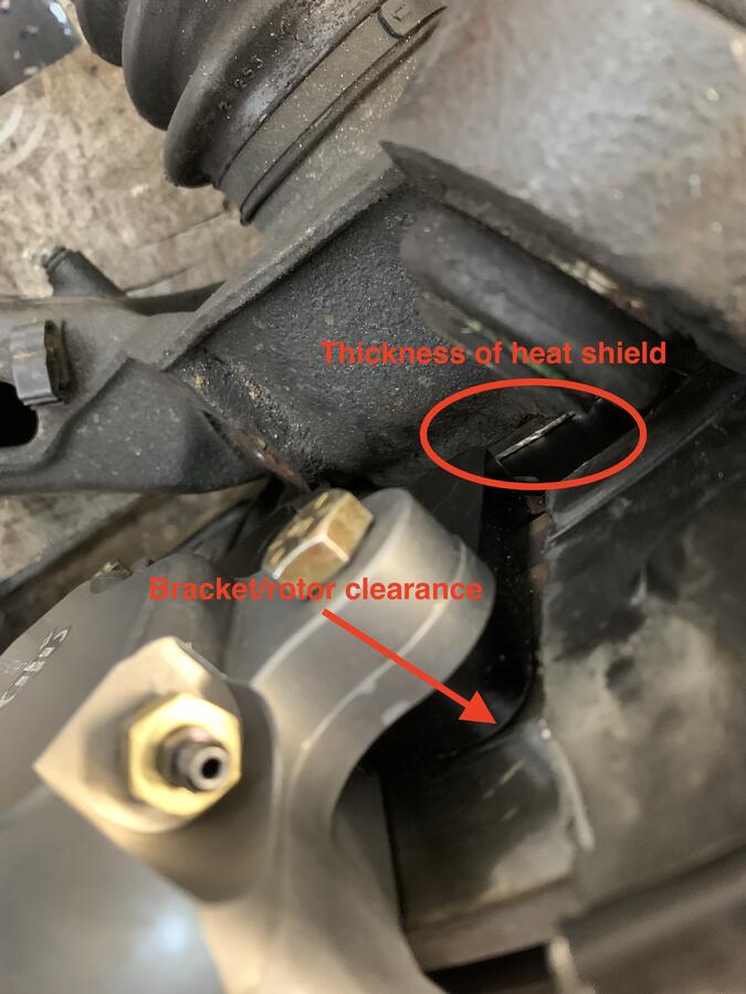

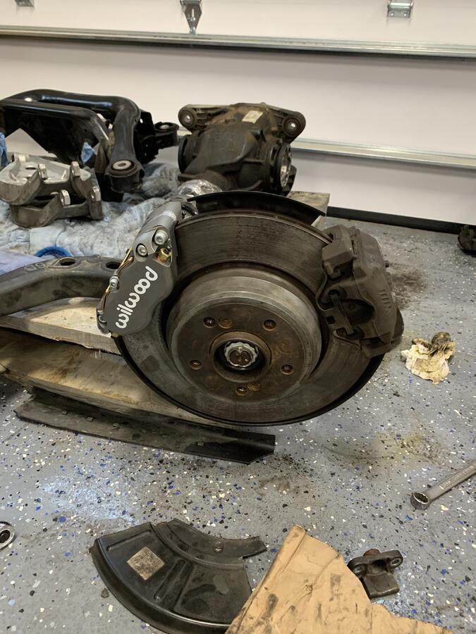

I'm working on my rear end rebuild and have encountered a bit of a blip in the road, as one may expect. I'm mounting up a set of Wilwood calipers using the Chase Bays dual caliper kit. Chase Bays has specified to run the kit without heat/dust shield, but it seems to me easy enough to cut out the shield so that it is compatible with the Chase mounting bracket. Anywho, I got it all cut up and mocked up, everything fits well except the caliper/bracket are now offset by the thickness of the shield (don't have digital calipers with me but around one mil?) such that the bracket/caliper assembly is closer to the rotor. See images below.
My question is: can I shim the stock rear rotor by ~1mm between the rotor hat and hub, to increase this clearance? I would think the stock sliding caliper has enough movement to tolerate this. Just wondering if there are any potential issues to consider. Seems like this isn't a totally unusual thing to want to do ... one thing I thought of is my rear spacer (12mm) will lose engagement with the hub by whatever offset I go with, if I shim the rotor.
