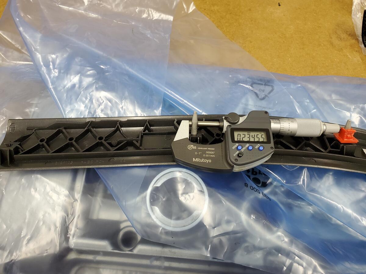

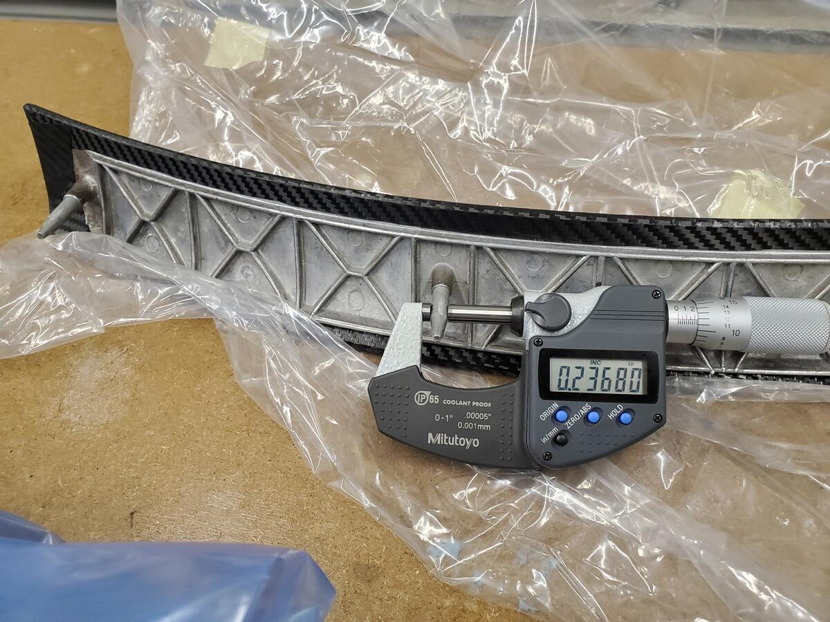

    Out in the garge and had these out...fwiw.
    Click image for larger version  Name:	20210301_184516.jpg Views:	0 Size:	175.9 KB ID:	88276 Click image for larger version  Name:	20210301_184619.jpg Views:	0 Size:	119.3 KB ID:	88277

      Very interesting. According to TIS, the plastic trim has the larger pins (but yours shows 2 thou smaller). I see that your plastic trim also pulled the red clip off the dash. You M car has both aluminum trim and plastic trim, or these came from 2 different cars?
      The plastic trim only goes with the white dash red clips, and the aluminum trim goes with white clips.
        The previous owner had bought a set of the woodgrain metal trim pieces and had them wrapped in carbon fiber effect. I recently removed them in favor of installed stock colored plastic trim pieces.
        I definitely see how one could do damage to the plastic trim during removal so when it comes time to let BMW do the recall I will remove the trim as you did for sure!
          OK. I wish the M3 stock trims have the solid aluminum instead of plastic base; the weight saved is not worth it in this case.

            No big deal but I just wanted to clear this up about your "big pin" on the plastic trim that was measured only 0.23455": The new pin should be around 0.238" and you might happen to measure on the used sides of the pin which had been scraped off by the clip's steel plate. The virgin side of the pin should be larger than 0.2345".
