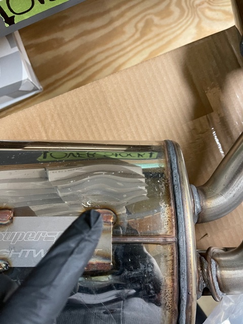

    Yeah, that can happen. Just bolt it up and enjoy

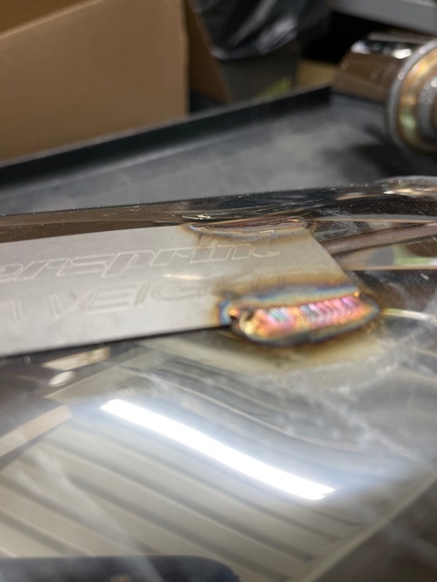

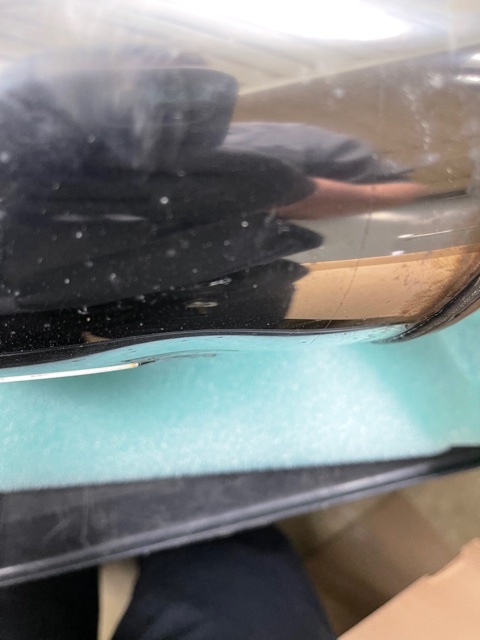

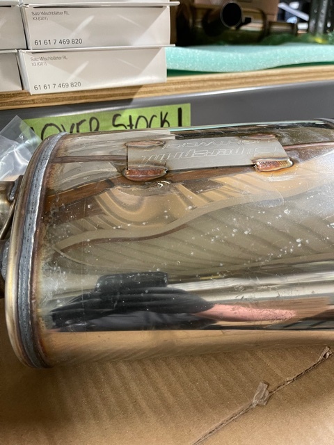

                  That is not warpage from a weld. Clearly looks like a dent.
                  If it was warped then you’d see the color in the weld on the muffler indicating they cooked the metal.
                  If you want to get picky...the best weld on stainless shouldn’t have color. But people like it.
