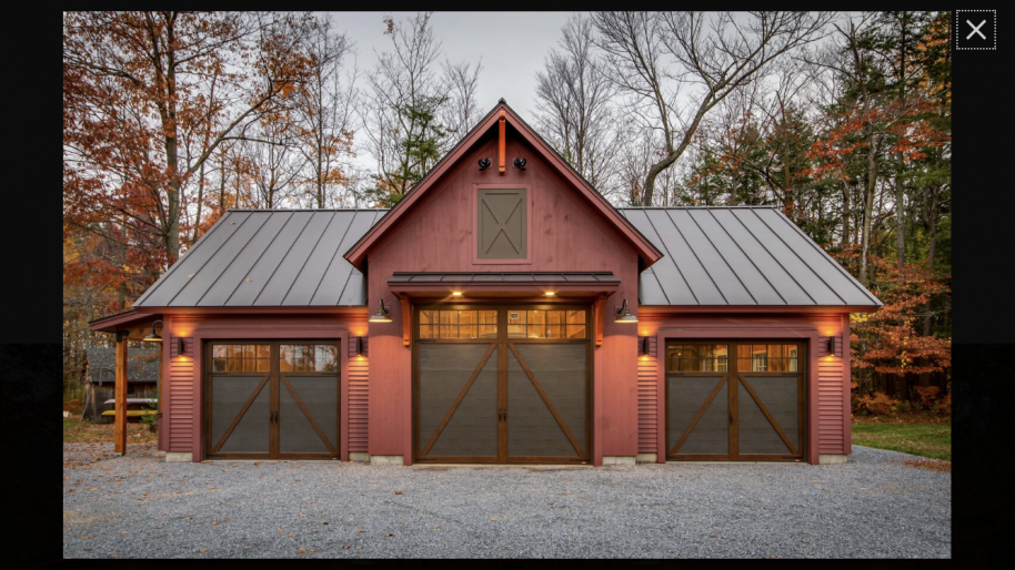

    I just bought a 2nd house with almost 1 acre land. Will put the house for rent now and will build a new one when I move there in the future. But plan for this summer or next year is to build a detached garage on the land. By the city regulation, the max I can build is 800sq-ft and 14.5’ height in middle of the truss.
    I am looking to do a triple cars garage. 9’ ceiling on 2 bays with attic truss and one bay full height/catedral truss with a lift. Should be able to do a 34’x24’ garage similar to the one in my attachment pictures.
    Since I will only do personal work and no commercial garage, I think a Bendpak is a bit overkill (and expensive in Canada it’s like twice the price!) so I am planning to go with a 9000lbs 2-posts Titan Premier like this one:
    https://titanlifts.com/2-post/titan-...or-2-post-lift
    That's a beautiful garage. I would love to build something that nice, but my budget is likely going to land on steel buildings. I've been looking up people who dress up steel buildings with wood, siding, accessories, etc. If anyone has any aesthetically pleasing steel buildings I'm all ears!
