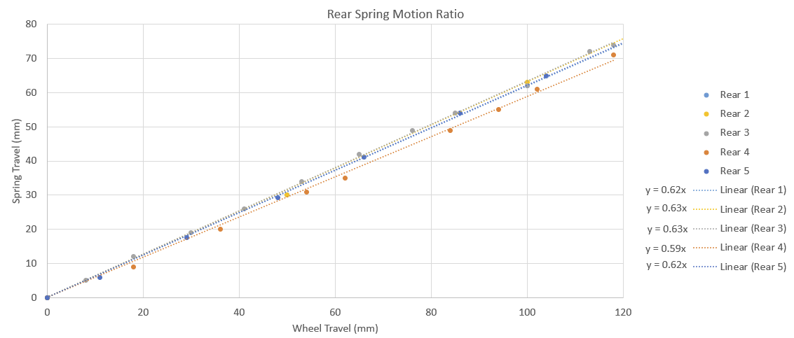

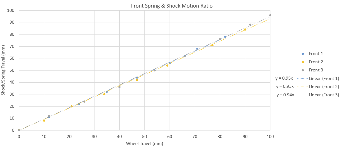

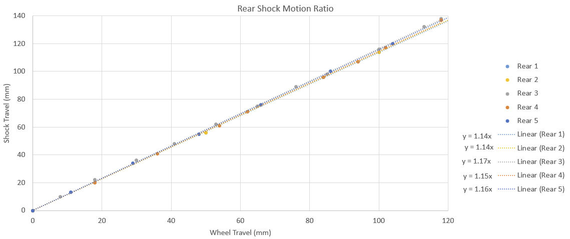

  • cobra
    replied
    Edit: I redid my measurements tonight more carefully. I did them multiple times to account for measuring errors - that's what Rear 1, 2, 3, etc means. The results were pretty dang consistent, and most importantly the rear is different than the values I was referencing which were 0.70 and 1.05.
    Front = 0.94
    Rear spring = 0.63
    Rear shock = 1.14
    Based on this...
    -Ohlins 400/630 spring rates yield 2.1Hz and 1.82Hz, or 86% R/F ratio.
    -With a 630lb rear spring and 300lb front spring, both will be at 1.82Hz.
    I would really love for someone else to do these measurements and make sure we're all using the right numbers. Small differences in spring ratio has a big effect on frequency...
