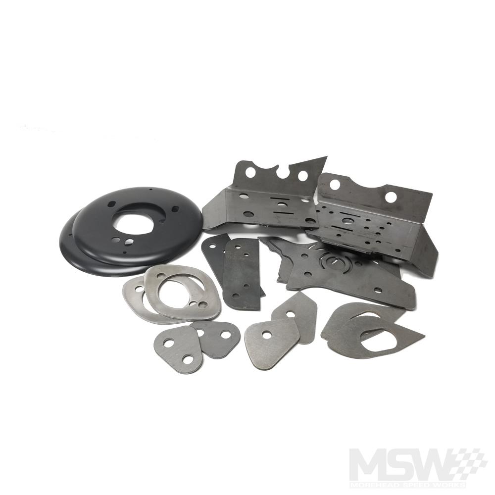

              I used these:
              Complete chassis and subframe reinforcement kit for your E46 track or race car.  Includes reinforcements for front subframe/engine mounts, rear floor/subframe, front strut towers, front roll bar mounts and rear shock mounts.
              $18 is cheap enough that putting effort into fabbing didn't make sense to me.

                              I used these:
                              Do you need to weld these in or is it like the strut tower reinforcement where you just bolt it in and call it a day?
