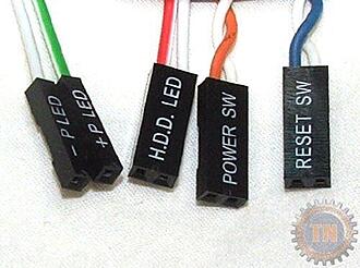

    not sure if this will help but 2 of the pins are needed for the horn to function. if you look at the OEM harness, the black is most likely ground and the 2nd one i don't know but i'll look it up. what i ended up using was the very small square connectors that are used to wire up CPU's on motherboards. sorry i cant' be more descriptive. i went to a computer repair shop and he just gave it to me. it was perfect. i crimped the other end and just tapped it into the horn.

      the below are the type of connector i'm talking about. i plugged 2 of those in and on the other end you can crimp the proper connector that you need.

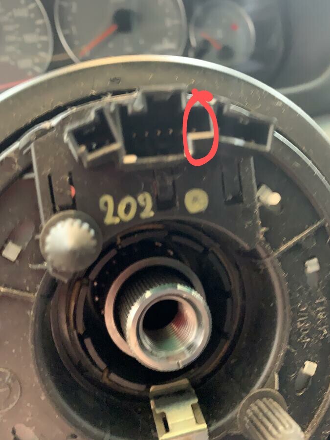

        Thanks for the help MarcoPolo. I have a pic of the OEM plugs from the wheel (which I've since sold) but there are lots of wires running into the 2 plugs and I can't be sure of what is what from the pic (wasn't thinking I'd ever need that info 🤦‍♂️). If I could find the pin out diagram and then identify which one pin was horn and which was ground, I'd be set.
        How did you figure out what pin on the car side to plug them in to?

          Those 2 pins. Those are pins 5 and 6.

            Amazing!! Thank you I’ll try it out! 🙏
