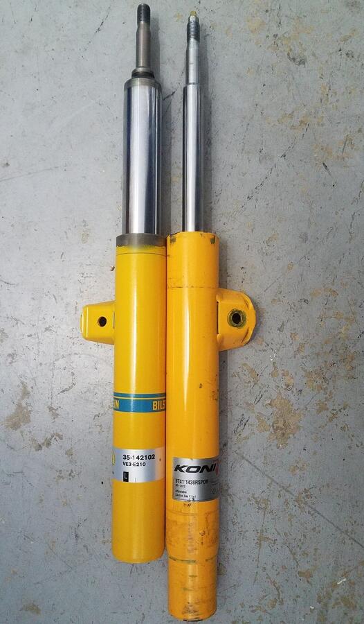

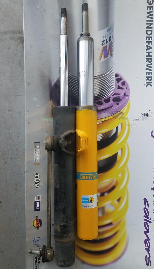

          The problem seems to be the combination of Koni sport shocks and the aftermarket bar. It seems the mount point for the stabilizer link on the Konis is a bit lower than stock. That, combined with the added length of the Turner bar was the problem.
          I found a thread on e46fanatics where someone suggested the e36 m3 sway bar links might work. I tried those and they fit perfectly; same 10mm bolt diameter and about 3/4in shorter.
          As for the "crookedness", I just got over it. There's a bit of preload, but based on the effort required to get the link in I would guess it's no more than 10-15lbs.
            Koni yellows and bilsteins are oe replacement dampers and have the sway bar tab in the exact same spot as well as all use the same lower perch.
