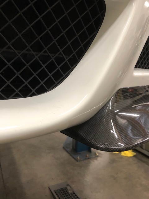

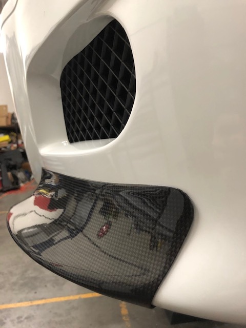

    Pics of Karbonius CSL Splitters in 1x1 carbon. This is the only piece made for oem bumper that fits right. If you look from the side it is contoured to the bumper and the splitters have a lot of volume in the inner edges unlike others.

      Wow that looks amazing, how do you mount it to the bumper? Or do you only use the mounting points on the bottom, any 3m double sided sticky tape on the top close to the bumper.?

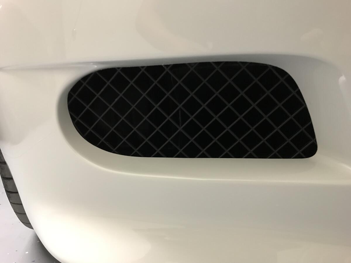

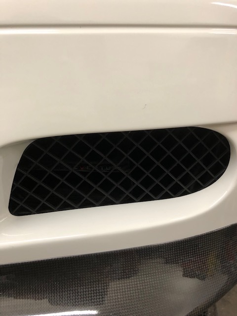

        I'd like to know more about your fog light delete and mesh...
          It is mounted with 3 screws on the bottom. The splitter has holes predrilled. It came with thin double sided tape on the top edge but I took it off and used a dab of silicone instead so it fits even more flush.

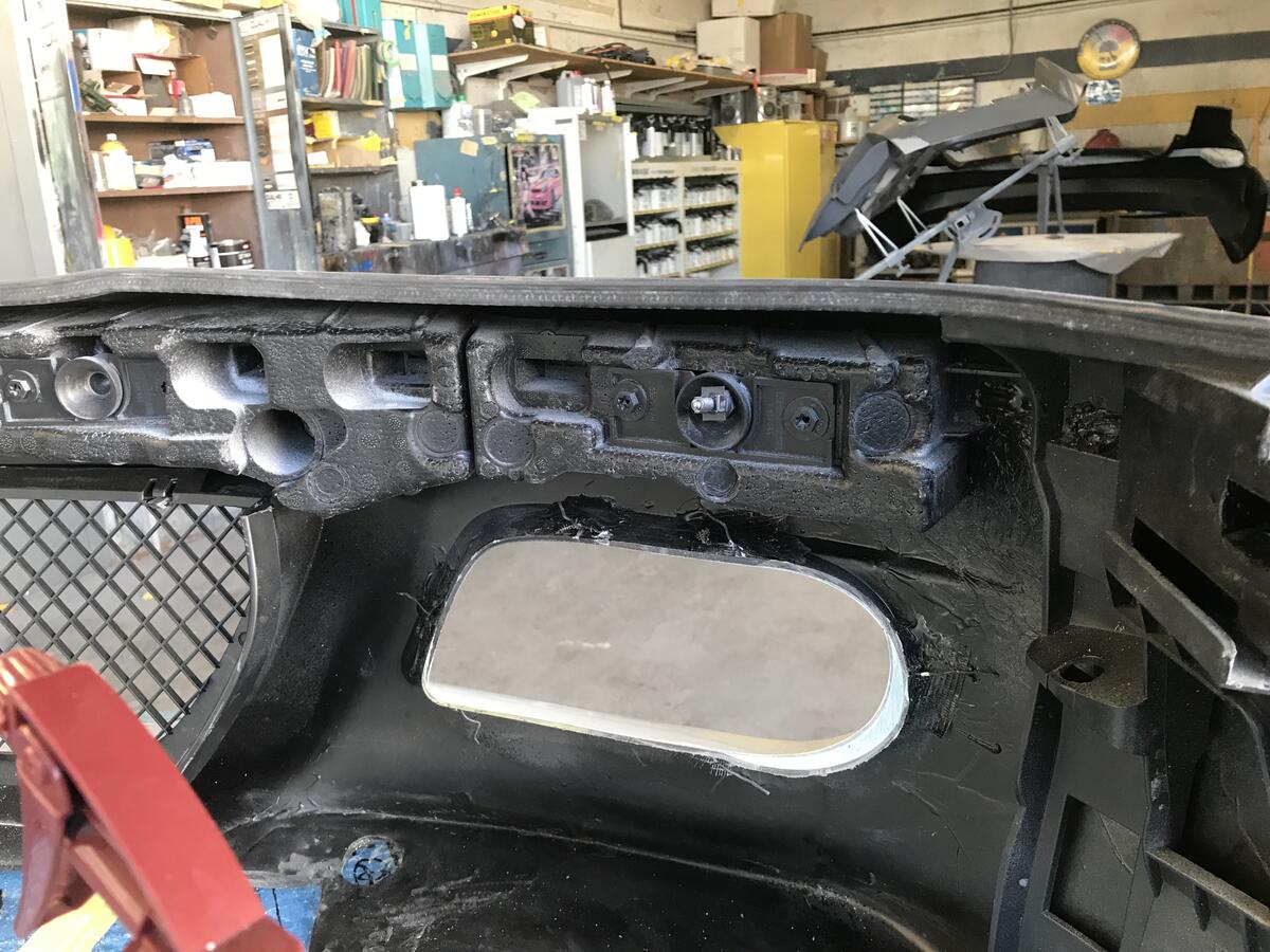

            The bumper is just a US spec bumper. I shaved the side markers and the foglight area as well. Plastic welding not bondo. The grill is just the original center grill that I cut up and expoxied since I purchased a new center grill. Painted the washer reservoir tank with high temp flat black on the passenger side. The drivers side fits an eventuri scoop no problem.
