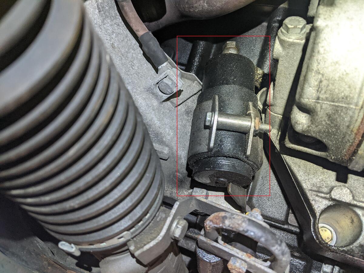

What is this canister on passenger side?
    What is this canister on passenger side? Is it leaking or it the leak from above?

    VANOS accumulator. You could replace the copper crush washers on banjo fitting.
    CPV or euro plug is sort of near by and often leaks, but it's further back and I wouldn't expect oil to travel forward.
    Only thing above there is coolant. Though I guess your oil pan gasket could be leaking there as well.
    If you haven't yet replaced your vanos line with the updated part, now would be a good time and you can put new washers in.
