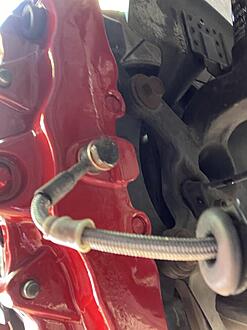

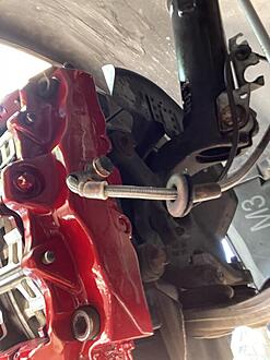

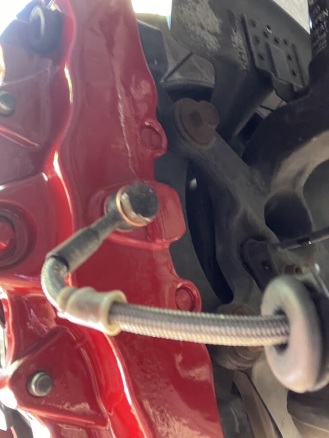

Brake line angle
Id have to feel how much tension there is on the line. Hard to tell just from the angle.Originally posted by Toby22 View Post
I tried but as soon as I fully tighten it, the line twists.
Do you think this is too harsh of an angle?
Maybe try holding the line at the opposite side from where you want it then while its getting tightened it will end up at the correct spot?
I honestly don’t understand what’s going on where you can’t hold the line where it needs to be. Your using the crush washers on either side of the fitting right?
Thanks, I ended up holding it on the opposite side before tightening hoping it’ll twist to where I want it to go. This time it didn’t twist when tightening down lol. Weird. But this is less harsh of an angle for the line I think so I’ll keep it here.Originally posted by eacmen View Post
Thanks again!
Glad you sorted it out!Originally posted by Toby22 View Post
Thanks again!
