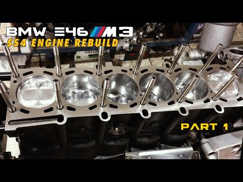

    Here is a little video of my engine rebuild journey for those interested.

            The car has CP forged pistons, overbored to 87.5mm. We used a Vac Motosports Torque plate when honing the cylinders, wish I could have filmed that part. This ensures the cylinders are perfectly round when the engine is assembled. I also have Crower Lightweight H-beam rods (the same rods used in HPF turbo cars) with ARP L19 studs and bolts. I am using Vac coated Rod bearings and ACL race main bearings. Also have Vac inconel valves with uprated springs and single groove cotters. I also have the Vac Uprated oil pump internals. The entire engine was then balanced before the parts were sent back to us.
            She's making just a little more than stock HP but revs up so much faster. Am thinking of doing Cams with CSL airbox to make the most of the mods I have.
