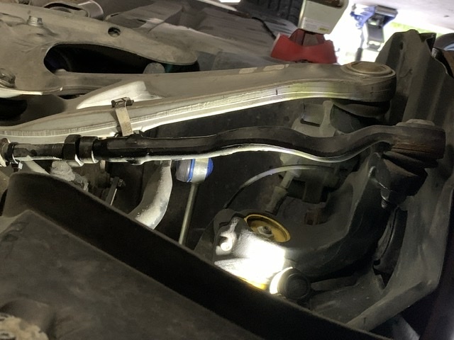

There is one on the right front frame rail and it is connected via a double ball jointed drumstck to the front right lower control arm.
there is another at the right rear lateral links. Since you hit a bump, you may have popped the bracket loose or the drumstick ball joint.
pic is inverted but the bracket/clamp is visible on the control arm.

Turn the steering to the right and take a look at the control arm.
you may see the bracket disconnected from the control arm, or the shank that connects to the bracket has fractured or popped off at one end.
If the sensor and its arm are intact, you'll have to look at the right rear sensor, or the front sensor has failed electrically.
