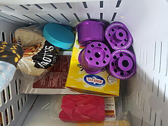

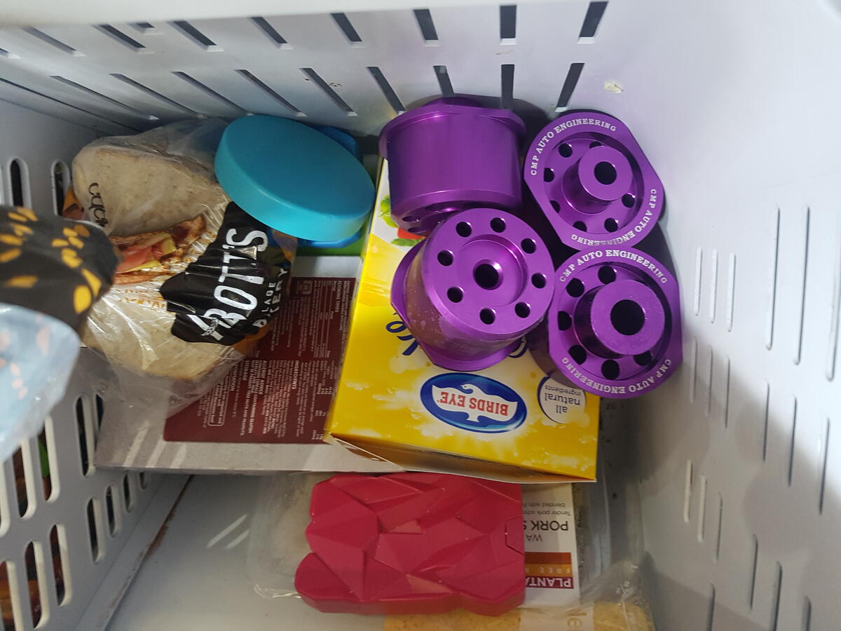

    I have the whole rear end out and apart, I've replaced every ball joint and bushing there is back there but ran into a hitch with the CMP sub-frame bushing install. I am using a tool with cups and threaded rod to push and pull things out and it's been working great, but the aluminum bushing starts to go crooked when I begin to tighten down the tool. I know some smaller bushings straighten themselves out as they go in, but these are solid and not cheap so I don't want to mess them up.
    Anyone have experience with sold subframe bushings? Did you use this type of tool? I have a buddy with a shop press so I could likely take it over there to use it...but if a you guys think they'll straighten out as it gets pulled in then I may just keep on going.

    Put them in the freezer next to the frozen peas lol
      I’ll try that!
        Yeah the rods bend...but elastically...so it's ok.
        Make sure you grease the outside of the bushing and the threads on the tool (lower friction/heat). Just make sure you watch where you put down the rod afterwards on the ground (or you'll have a fun day cleaning dirt/grime out of the lubed threads).
        Those rods in your kit might not be very stout (and therefore might break), but I just forced through it by tightening the bearing nut and the bushing does straighten out and gets pulled through square. I used the rod in the Schwaben tool and it is very strong. I did not freeze mine, but freezing them will help, although the initial alignment and not going in straight might still be an issue, just less so. It's quite hard to line up the accepting receptacle cup on the axis through the hole/bushing, especially because the rod is so much smaller than the bushing hole.

            Freezer overnight, hit the subframe with a heat gun, a bit of grease and they slid right in. One went a bit angled but straightened out as it went in further.
