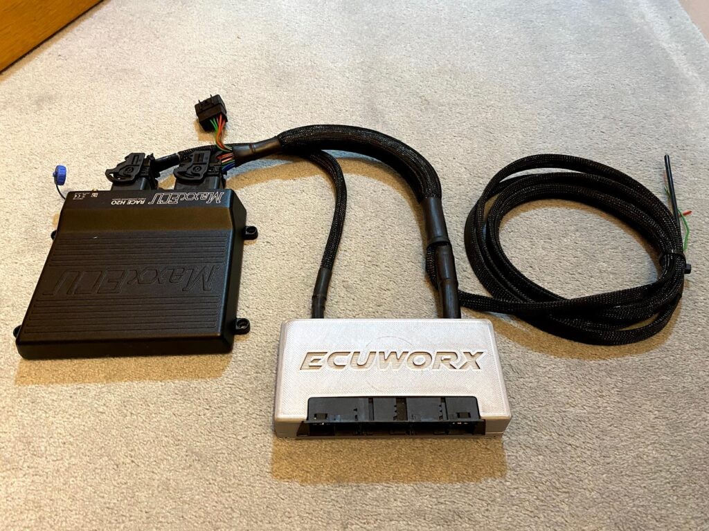

      I made my own.

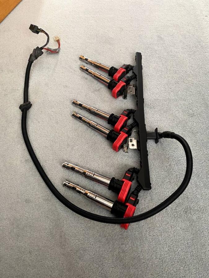

      I purchased a second coilpack harness and modified it to run the Audi R8 smart coils so I didn't need to run the IGBTs.

      Now I'm making one for the Z4M.

        what does it cost to make an adapter to go between the factory harness and MaxxECU race? I will be using them for my DCT retrofit over HTG.
        what r the benefits of using the Audi coils over the S54 BMW coils? They look like my Passat B6 coils

          The Maxx can't drive the dumb S54 coils without IGBTs, which are ~50 euros each and required for each coil. The audi coils can be driven directly.
