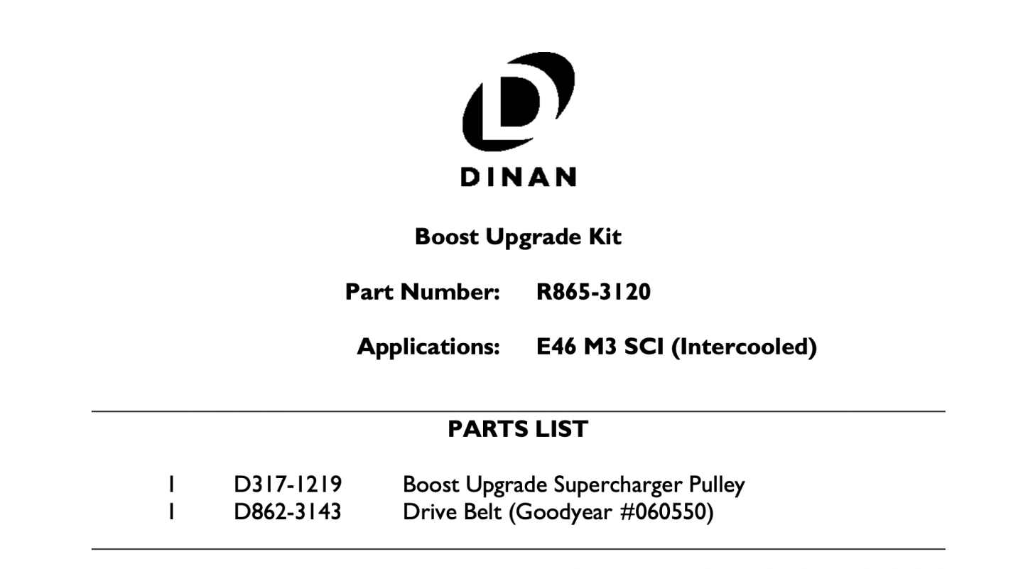

                Does anyone have the Dinan "Boost Upgrade Kit" for this setup? Or know what the pulley diameter is?
Name:	Screenshot 2024-02-15 at 8.21.52 PM.png
