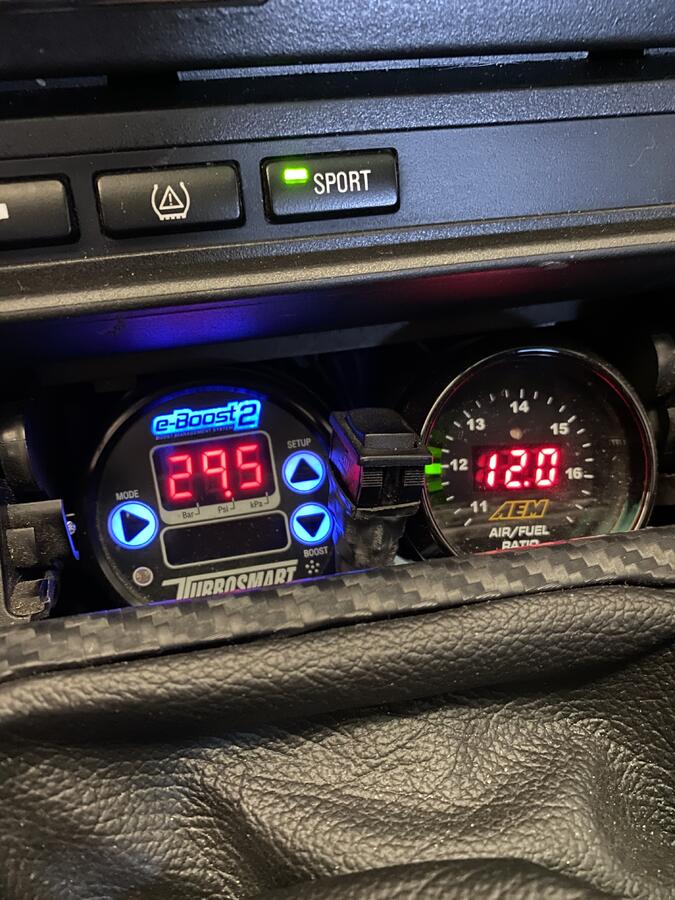

        I’m also running 11.5:1 wiseco pistons, molnar rods and a JE/Athena cut ring head gasket. I left the valve train alone. The ports on the intake were smoother a little. It made 720 whp@ 22psi on the stock internal engine and the rods were still straight when taken apart. After the build I’ve ran it up to almost 30 psi. I agree you should be able to hit 650 whp safely with the 6466 without building the engine.
        Click image for larger version  Name:	17B70AA2-D2F7-45BE-AC34-5C0F124F438D.jpeg Views:	0 Size:	114.3 KB ID:	79835
