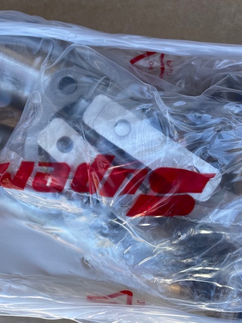

    Just received my oversized section 2. What are these metal rectangles for? Are they spacers? I recently installed an OEM section 2 to mate with my Dixis rear box and I don't remember installing or needing anything that looked like this.

    I ended up not using these, they pulled the muffler a bit farther downward and my section 2 didn't have a clearance issue without them anyway (probably since I have subframe riser).

    Thank you, so I place these spacers between the car and the two support plates so the plates now clear the larger pipes?
    Yes, exactly.

    You are correct, those are indeed spacers. They are used to space down the two chassis support plates that the exhaust runs over.

    Hey guys!
