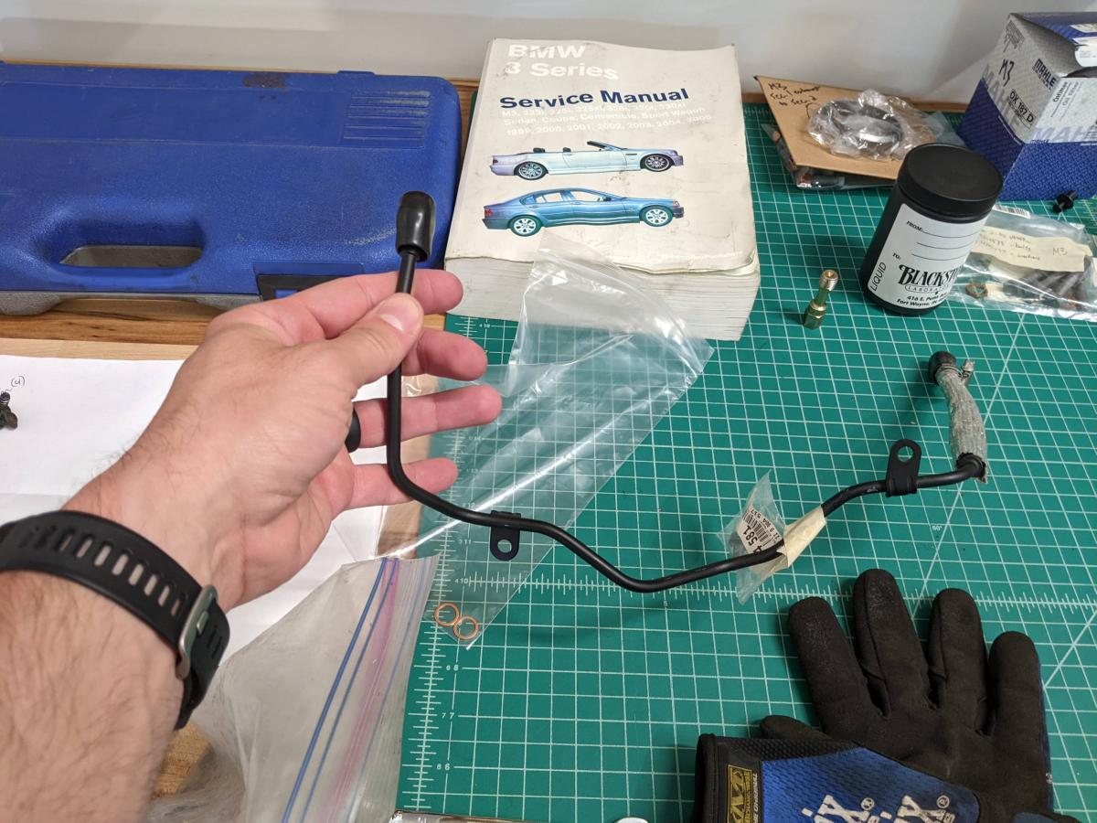

                  Parts are in! Any pro tips on caliper rebuild? I've never done it. Should I disconnect the brake line at the caliper, or at the hard line? Is there an easy way to keep too much fluid flowing out while I work?
                  Also saying goodbye to the jelly jar, tubing, duct tape setup I've been using for bleeding brakes too.
                  Sent from my Pixel 3a XL using Tapatalk
                  RIP M3F
                  2002 M3 - 2014 Cayenne Diesel
                    Did some Stoptech stainless lines for a buddy a couple weeks back... They included these little rubber stoppers that slip over the flare at the end of the hardline, that keeps the fluid from draining. If you could get ahold of those that would probably help a ton.
                      Seal was in really bad shape once I got it out. Rebuild is going smoothly though, should have everything back together this weekend

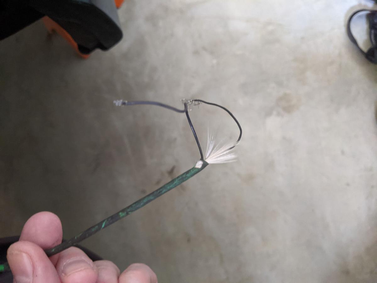

                          At my next track event after rebuilding my calipers my brake warning light come on as I was leaving. Made me a little nervous, but it turned out that my zip tied brake wear sensor broke loose and got torn off.

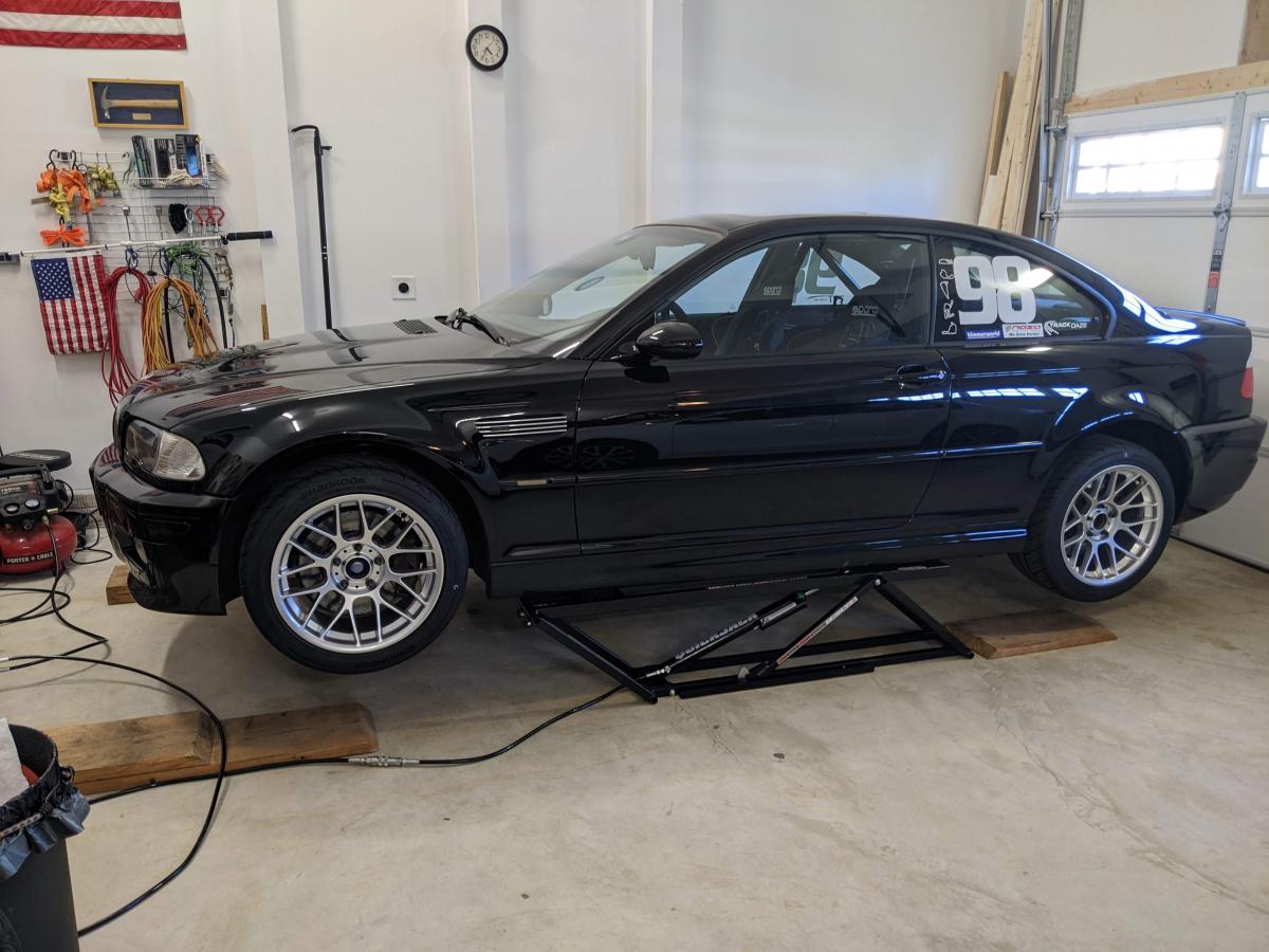

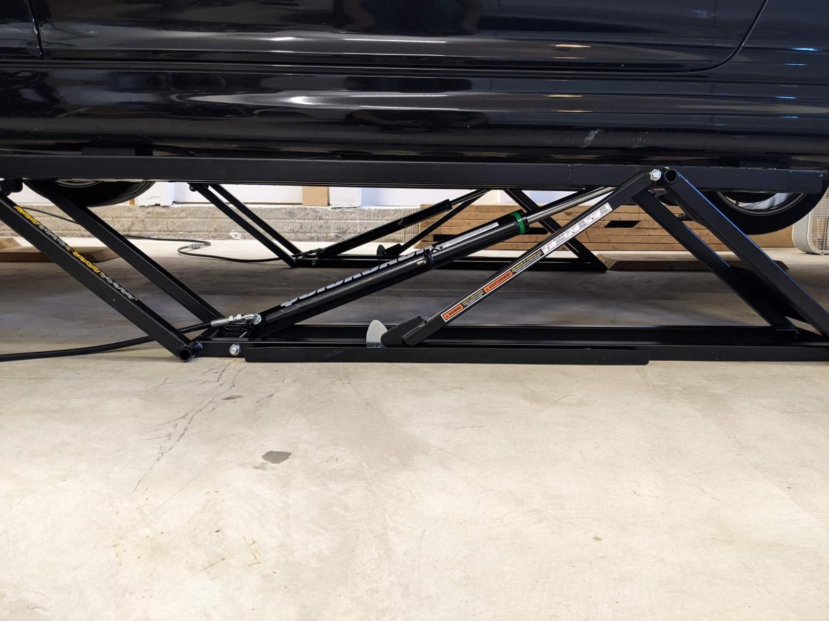

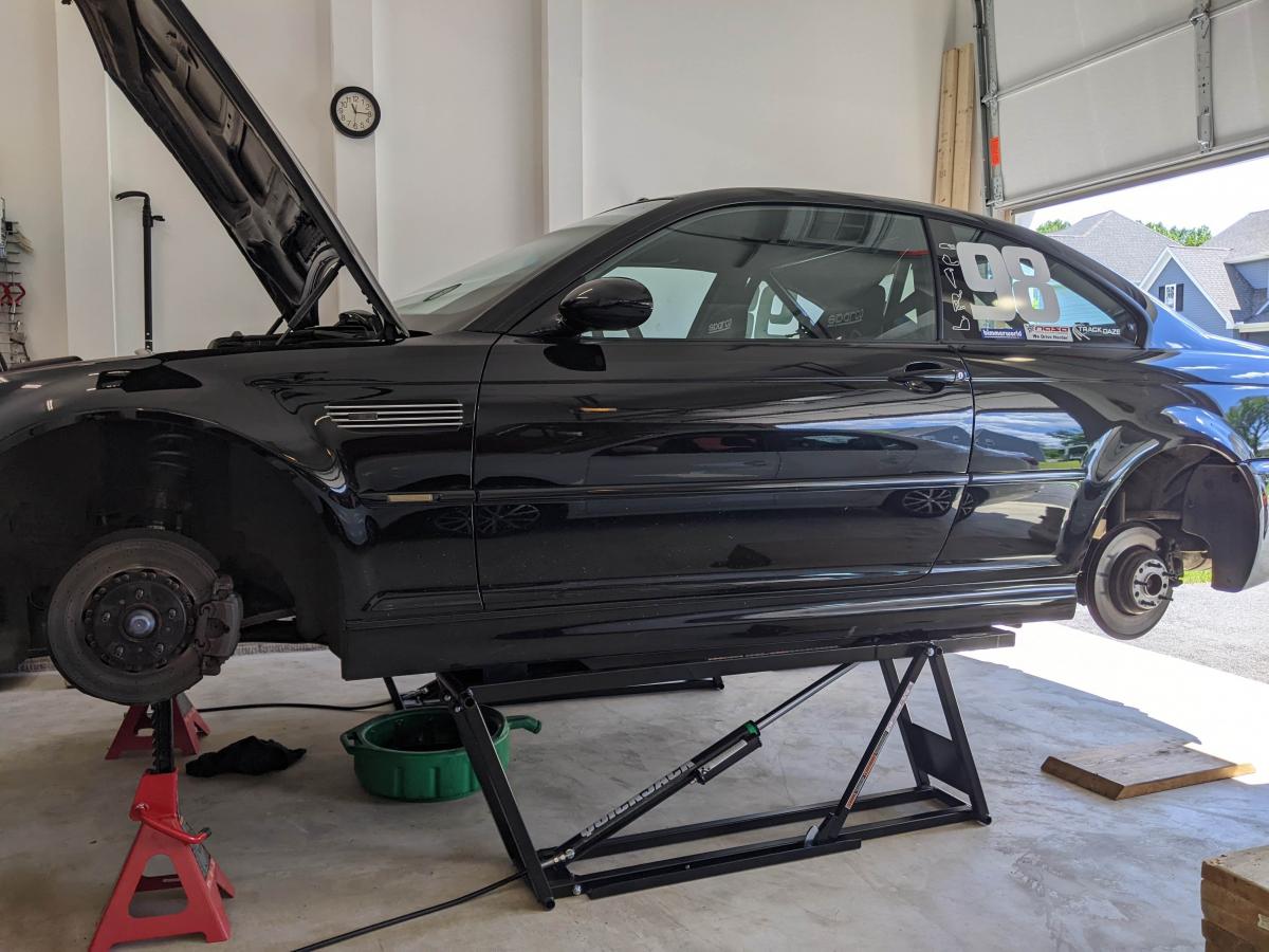

                          I've got quite a big list of to do items on both the wagon and the M3 so I finally picked up a quick jack. I'll post details of that work when it happens - it may even include a clutch job if I decide to DIY it.
                          Click image for larger version  Name:	PXL_20220329_203427516.jpg Views:	0 Size:	125.6 KB ID:	161770
                          Click image for larger version  Name:	PXL_20220329_203418585.jpg Views:	0 Size:	123.4 KB ID:	161771

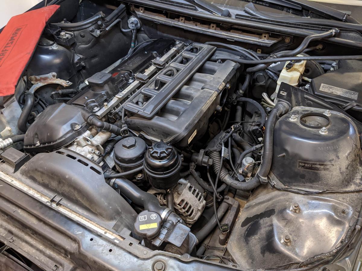

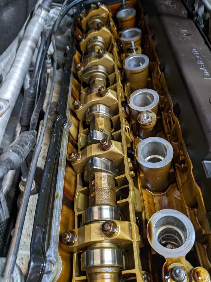

                            Got some work done on the wagon this weekend. Confirmed that my valve cover gasket is leaking, so I'll have to order those parts. I had a strange misfire on cylinder 2 about two weeks ago. It's been fine since then, but I swapped the position of the 1 and 2 coils, so if it happens again I can have a better idea of the issue. I assumed that it used the same version as the M3, but of course they're different. Having the quick jack is really awesome.
                            I also pulled the DISA and use a rebuild kit to repair it. It actually wasn't broken as they usually are, but there was a strange chuck of hose jammed in it. Not sure how that got there, but it's 100% now.

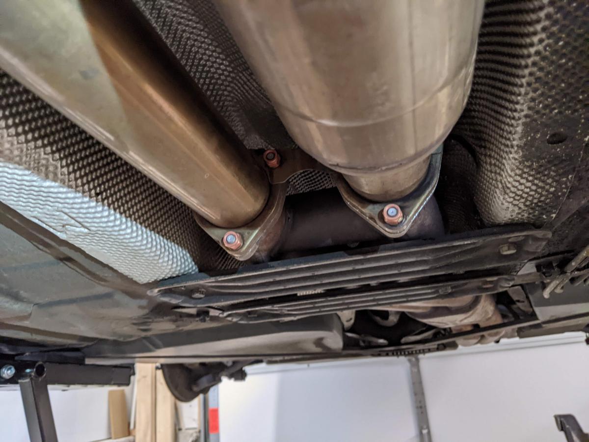

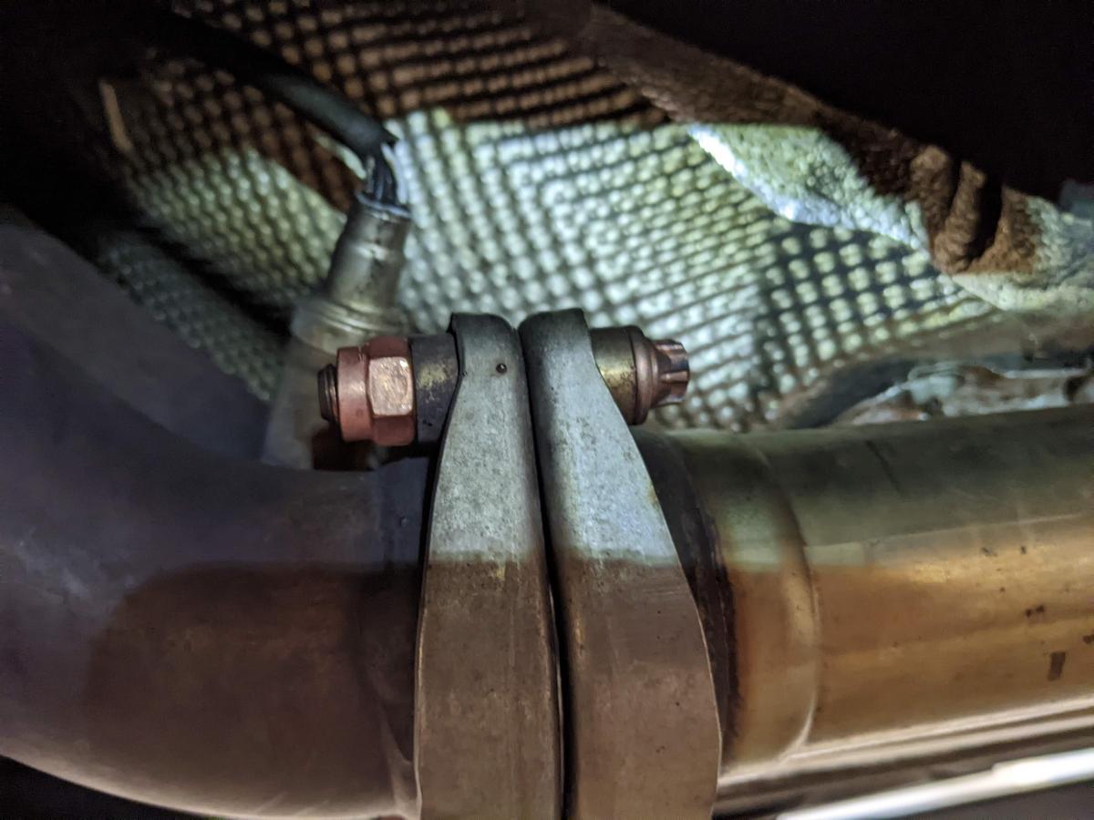

                              I spent the last few weekends getting a few other jobs done on both the BMWs. After the wagons DISA rebuild, I made the move to handle a few more items I’ve been putting off. Firstly, I pulled the valve cover off to replace a leaky gasket that’s been bothering me. Not a terrible job, but not that fun either. All went well though and it’s not leaking any more. The old gasket only had about 30k miles old but was clearly ready to be replace, it was really hard and easy to crack. A new cabin air filter and engine air filter were thrown in also.

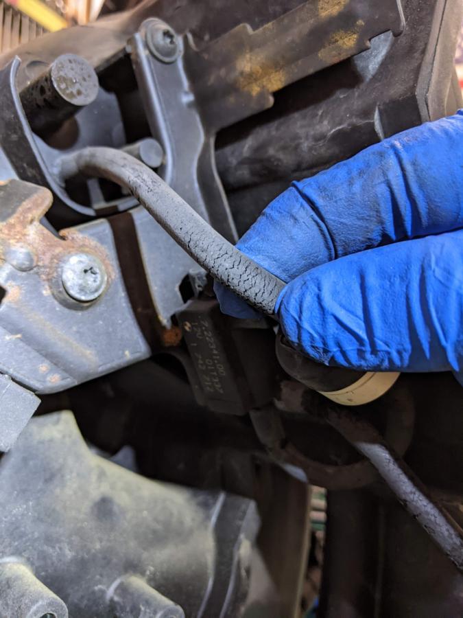

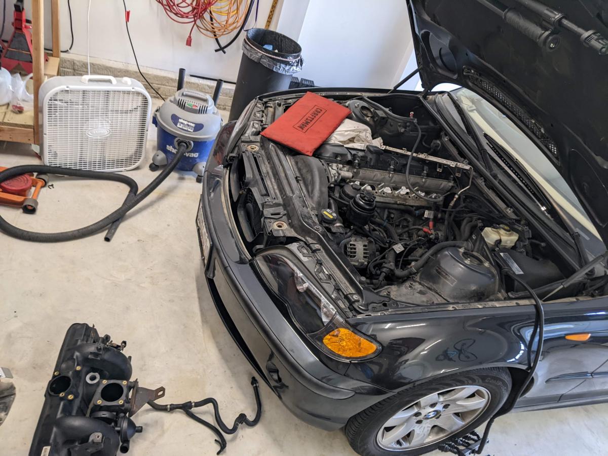

                              The following weekend I put the wagon back on the lift and replaced the CCV components and several vacuum lines. This involves pulling the intake manifold off which is not the easiest task. Apparently, folks can replace their CCV hoses without pulling it out, but I have no idea how you’d do it. It also looked like a mouse had been living in my engine too – the area under the manifold was full of little nut shells and other crap. I spent a long time cleaning it out so junk didn’t fall into the engine.
                              In any case, the hoses were replaced along with rubber vacuum lines. Most of the vacuum lines crumbled to dust in my hands, so I’m glad to have those fresh. Major pro tip – use silicon spray to remove/install the lines. It’s safe for rubber and makes it 10x easier then dealing with them dry.

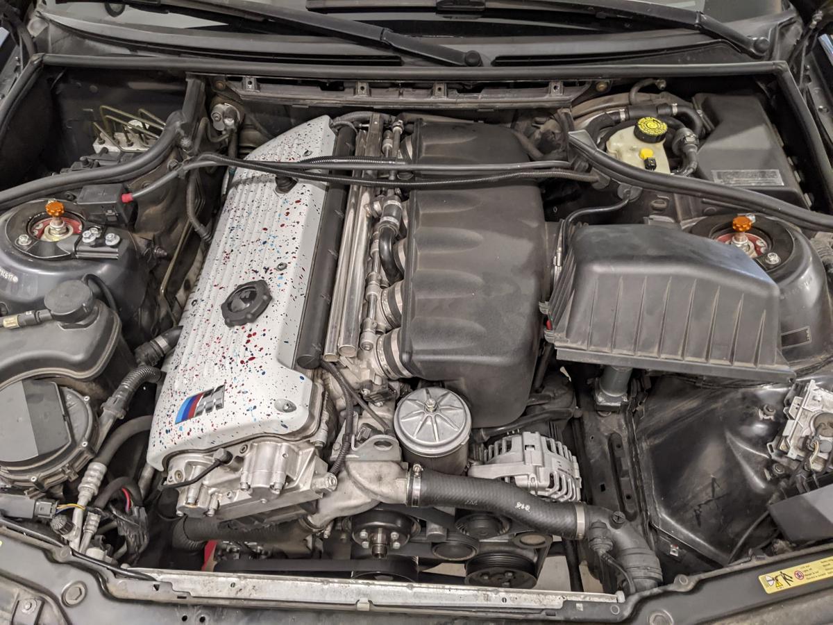

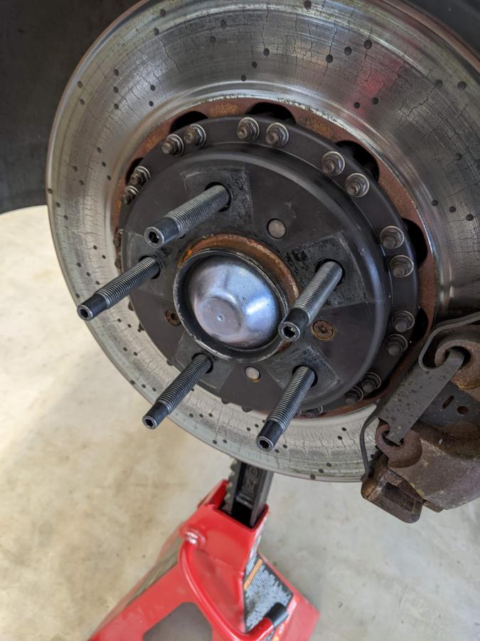

                              Next up was the M3 which got a big batch of maintenance completed.
                              Oil and filter change, replaced the VANOS hardline, new transmission fluid with new plugs, fresh diff fluid and new plugs, fresh coolant/water, replaced all wheel studs, new engine and cabin air filters. For years I’ve had a rasp terminator on the car and with the quick jack lifts, I finally had an easy way to swap the OE section back in. It was a shockingly easy job and it’s nice to have a little rasp back, I forgot how good it sounds. Pro-tip here – replace the hardware with the OE parts. I know they are expensive, but they always fit and you’ll thank yourself the next time you have to mess with it.
