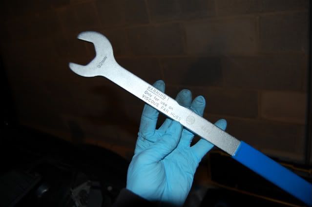

      • 32mm cooling fan wrench (I got mine on Amazon for about $20)

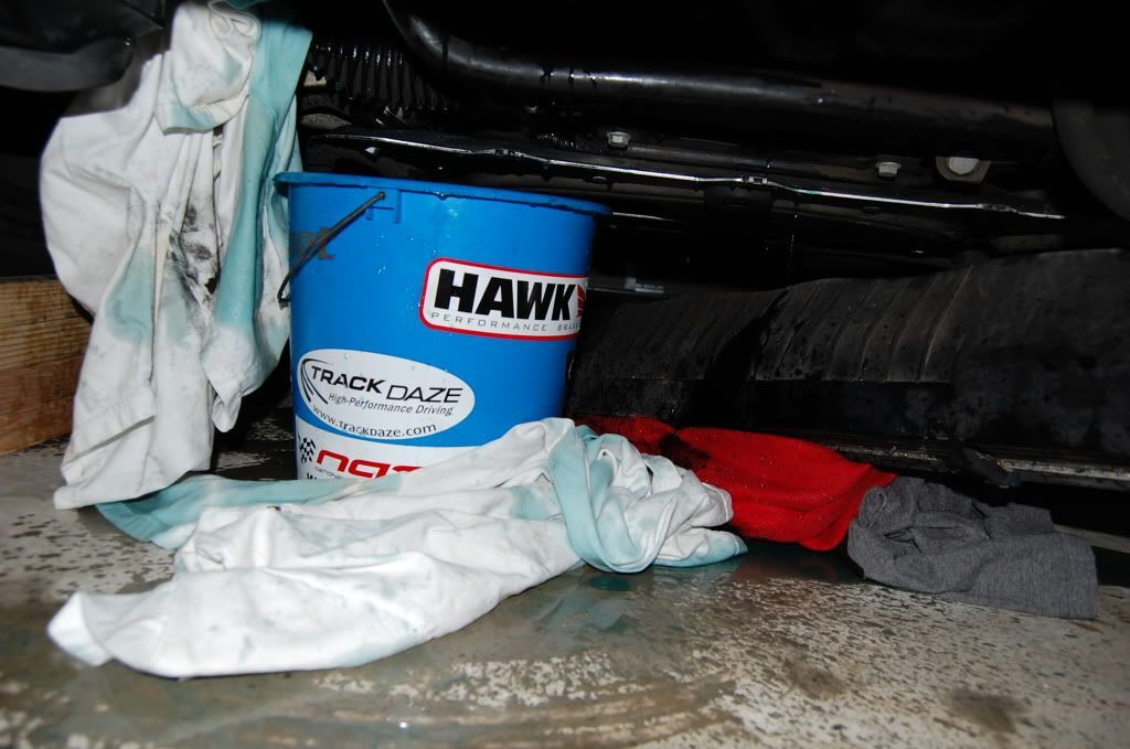

      • Rags/blankets you don’t care about ruining
      • Empty containers for used coolant (milk jugs work, and they’re free!)

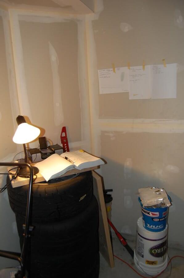

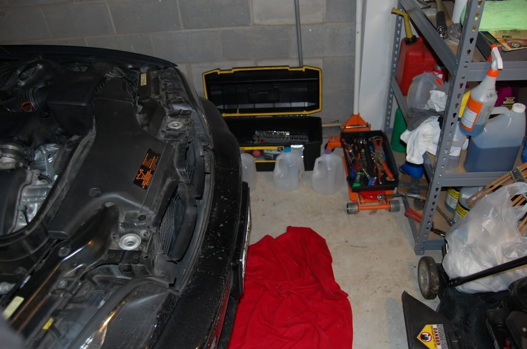

      Set-up: I work in a very small garage, so space was a little tight. I did this entire project with the front of the car up on ramps. The red blanket is my drip catcher. I use taped notes on the wall to remember steps, torque values and make notes.
      Click image for larger version  Name:	DSC_0003-1.jpg Views:	0 Size:	87.2 KB ID:	86471
      Click image for larger version  Name:	DSC_0002-1.jpg Views:	0 Size:	35.3 KB ID:	86472

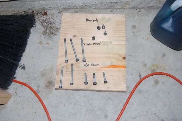

      I also use small bags to organize fasteners/clips

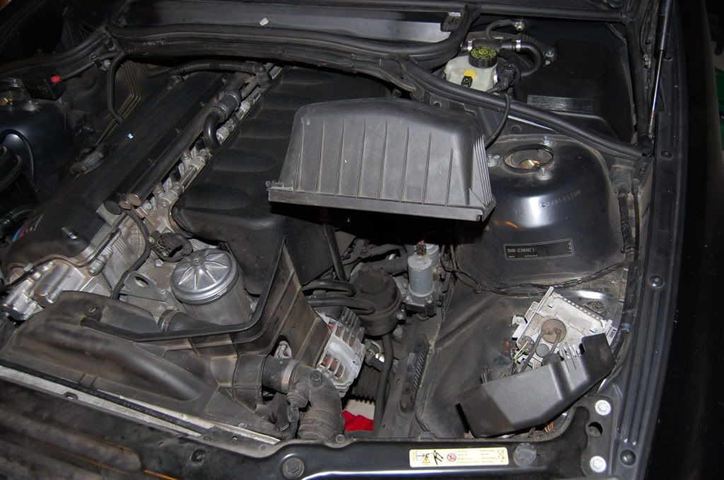

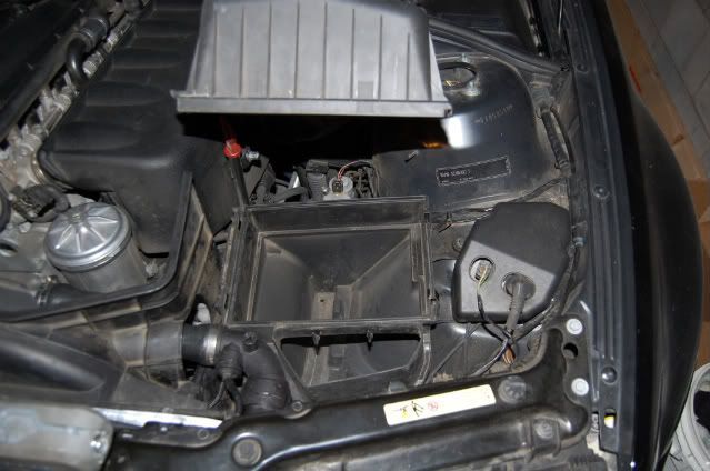

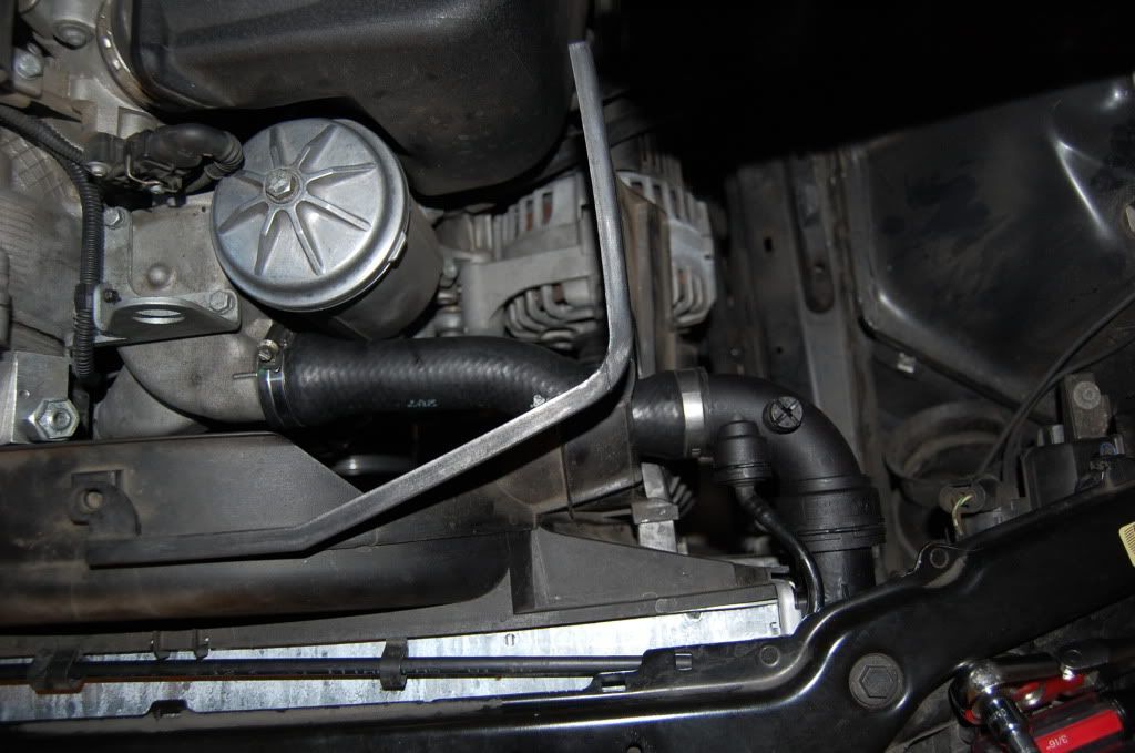

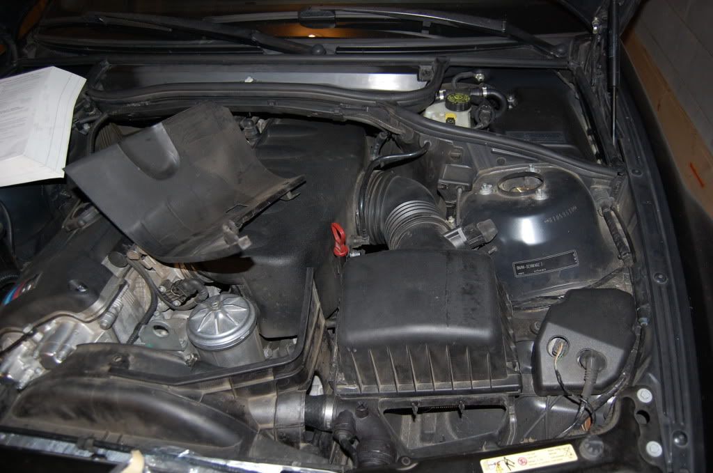

      The intake needs to be removed. The top of the airbox can simply be rotated out of the way as shown, but the lower section needs to be removed. In the picture, you can see the cover of the xenon control unit lifted up. This gives you access to the two bolts holding the lower half of the airbox. It simply lifts out.
      Click image for larger version  Name:	DSC_0005.jpg Views:	0 Size:	97.6 KB ID:	86474

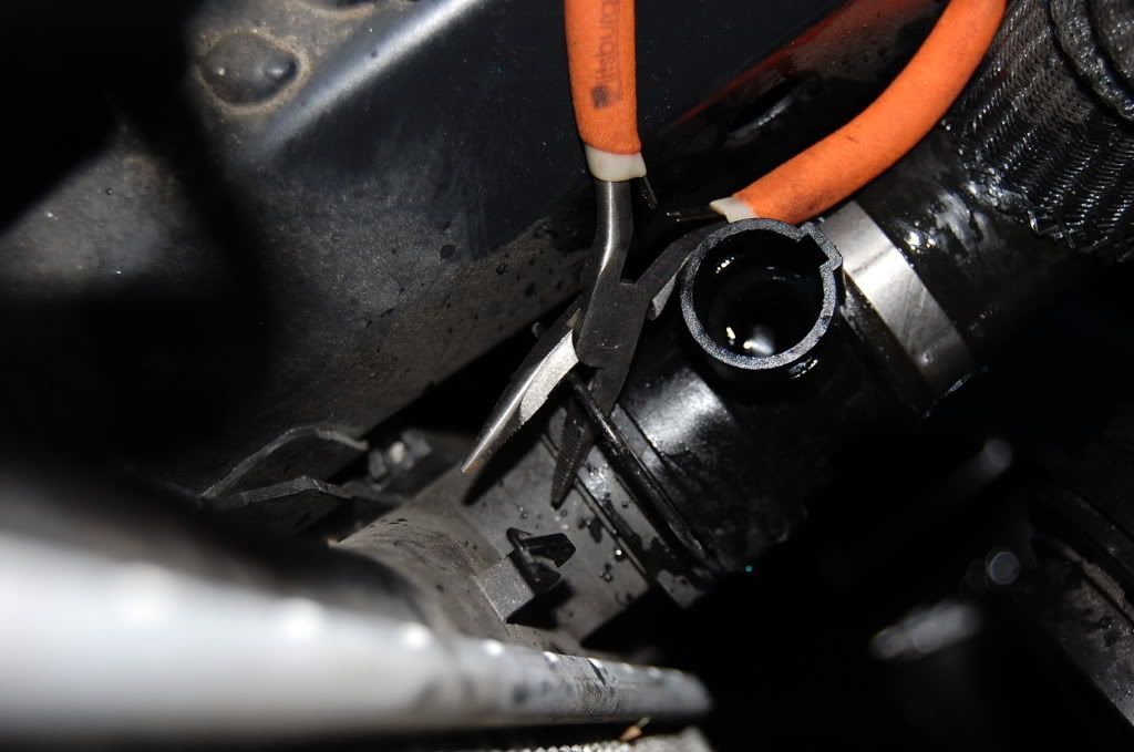

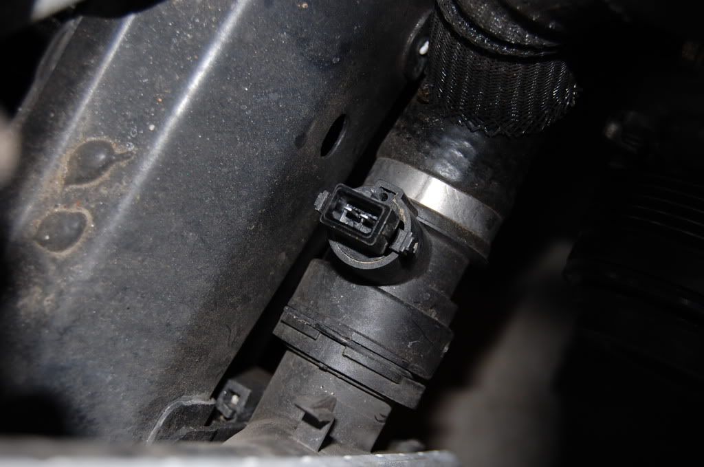

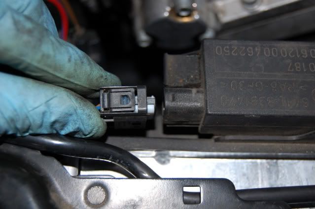

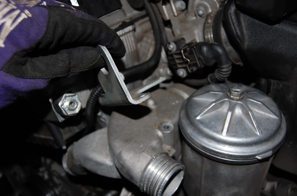

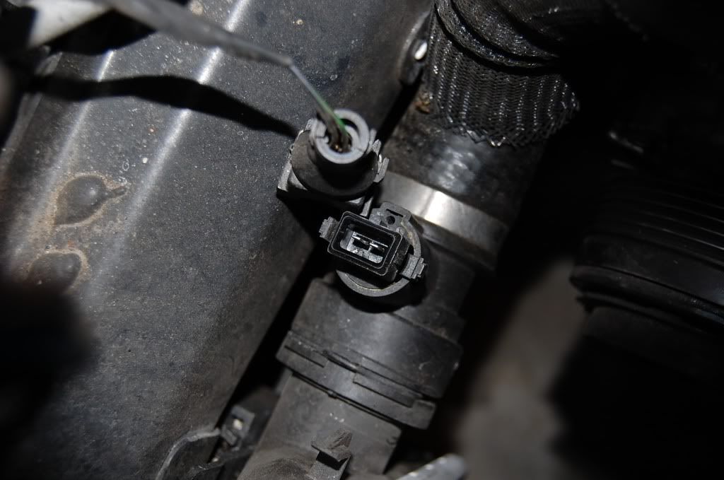

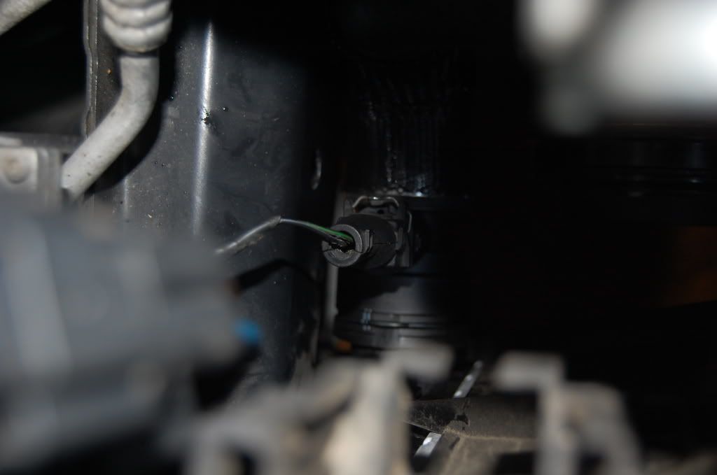

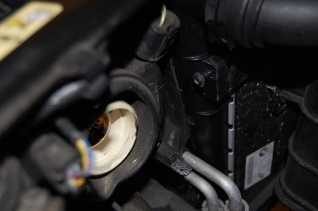

      Unplug the connection on top of the radiator and the temperature sensor in the lower hose. There is also a wiring assembly that is mounted on the passenger side of the fan shroud, it simply lifts out. These three items can be tucked away for now so they don’t get wet.
      Click image for larger version  Name:	DSC_0110.jpg Views:	0 Size:	33.6 KB ID:	86476
      Click image for larger version  Name:	DSC_0027.jpg Views:	0 Size:	76.3 KB ID:	86477

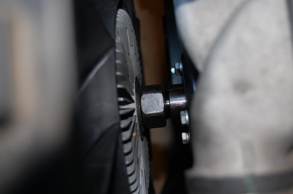

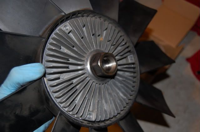

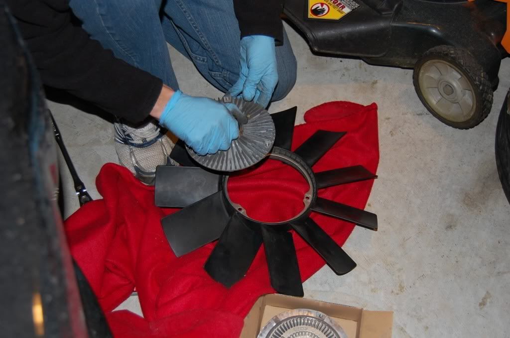

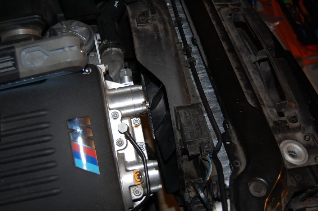

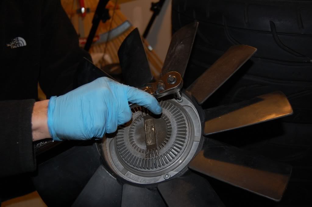

      Remove the fan with your fan nut tool (32mm). There is a secondary tool that holds the water pump pulley steady while you break the fan free, but it’s not really necessary. Some people are able to get the fan nut lose by hitting it with a mallet, but mine didn’t seem to want to move. I was able to get mine loose by using a long thin screwdriver to keep the pulley still. Note: if you haven’t heard it before, the fan clutch nut is reverse threaded. Think righty loosey, lefty tighty.
      Click image for larger version  Name:	DSC_0011.jpg Views:	0 Size:	33.4 KB ID:	86478
      Click image for larger version  Name:	DSC_0009.jpg Views:	0 Size:	17.5 KB ID:	86479
      found it easiest to remove the fan by dropping it out of the bottom of the car. Once the fan is out, you can remove the fan clutch. It’s held on by three 5mm hex bolts. Make sure to take a good look at the fan when you remove it so you put the new clutch in the correct way. I didn’t…more on that later. Be careful when tightening the new clutch in, you don’t want to crack the plastic fan. Torque spec is 10Nm (89 in-lb or about 7 ft-lb). You can also remove your belts now. The Bentley manual recommends that you mark the rotation of the belts so that they can be re-installed the same way. I’m not sure why this matters, but I did it anyways.
      Edit: It's easiest to remove the fan assembly and the shroud together at the same time. Removing the fan with the shroud still in place is difficult.
      Click image for larger version  Name:	DSC_0012.jpg Views:	0 Size:	38.8 KB ID:	86480
      Click image for larger version  Name:	DSC_0013.jpg Views:	0 Size:	31.2 KB ID:	86481
      Click image for larger version  Name:	DSC_0017.jpg Views:	0 Size:	50.6 KB ID:	86482 Click image for larger version  Name:	DSC_0019.jpg Views:	0 Size:	75.9 KB ID:	86483

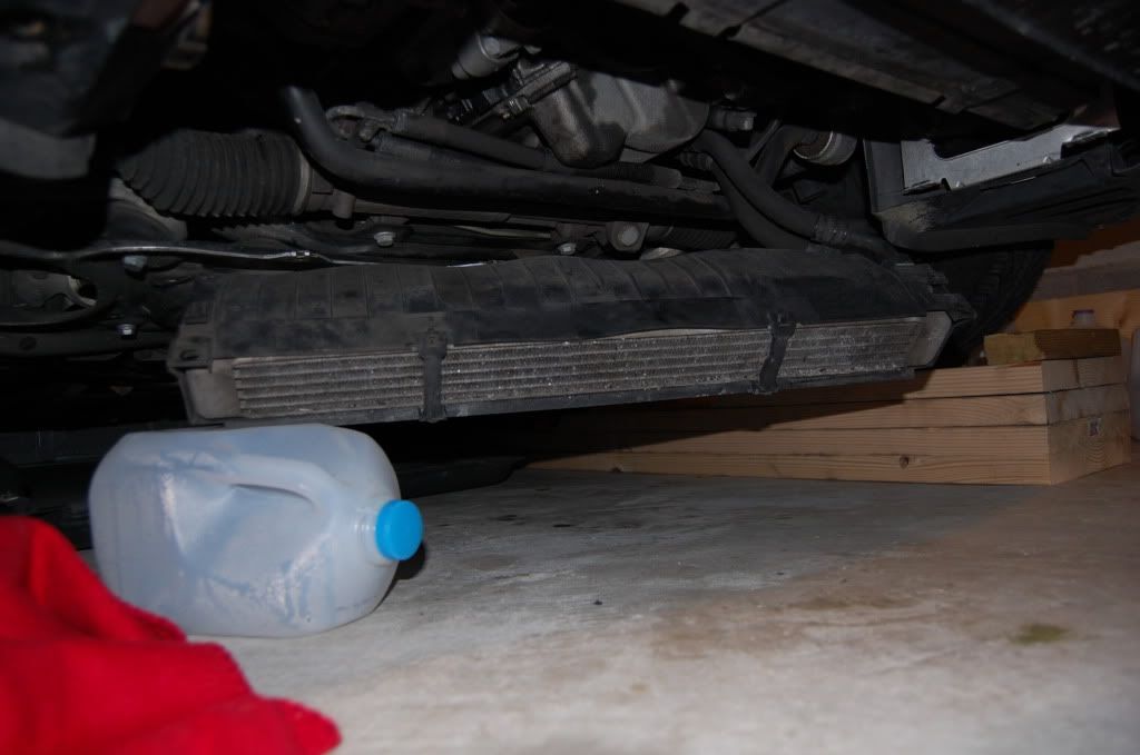

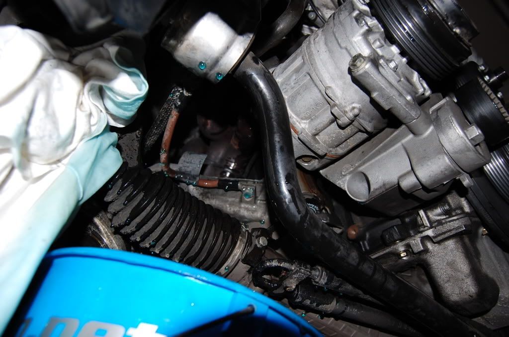

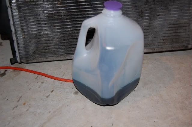

      Now you can drain the old coolant. E46 M3’s don’t have a radiator drain plug, which is kind of a pain. The simplest way to get around this is to drain fluid out of the temperature sensor in the lower radiator hose.
      Click image for larger version  Name:	DSC_0028.jpg Views:	0 Size:	73.9 KB ID:	86484
      Click image for larger version  Name:	DSC_0029.jpg Views:	0 Size:	32.8 KB ID:	86485

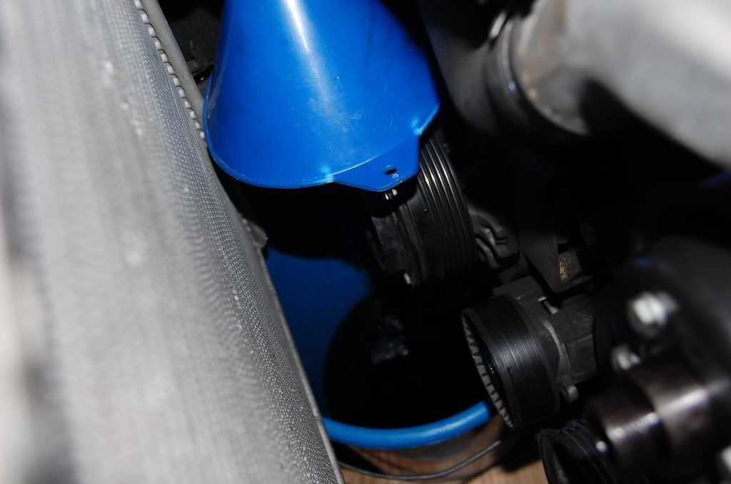

      Since the fluid is going to drain up out of the sensor hole, I covered it with an upside down funnel to reduce the mess. Pull the plug out and let the fluid drain. Since the rest of the system is still closed, not too much will drain out. To ensure you drain all the fluid, turn ignition switch on (don’t start the engine) and set your temp setting to full warm. With the funnel in place, open the bleeder valve and let the fluid run. I used this method and was able to keep spills to a minimum.
      Click image for larger version  Name:	DSC_0037.jpg Views:	0 Size:	53.8 KB ID:	86486
      Click image for larger version  Name:	DSC_0043.jpg Views:	0 Size:	43.4 KB ID:	86487
      Click image for larger version  Name:	DSC_0040.jpg Views:	0 Size:	50.5 KB ID:	86488
      Click image for larger version  Name:	DSC_0039.jpg Views:	0 Size:	45.9 KB ID:	86489

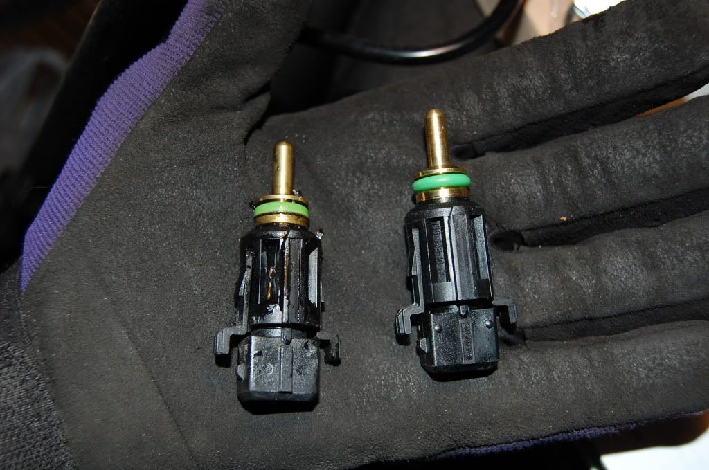

      Old and new temperature sensor.
      Click image for larger version  Name:	DSC_0044.jpg Views:	0 Size:	112.9 KB ID:	86490

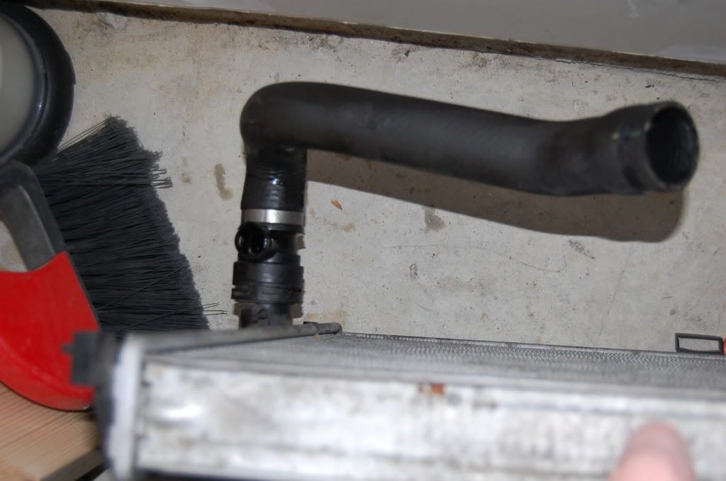

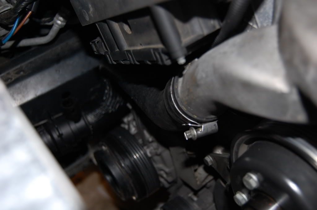

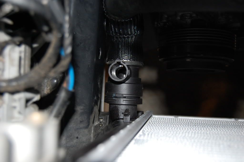

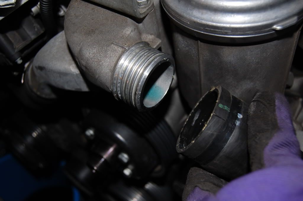

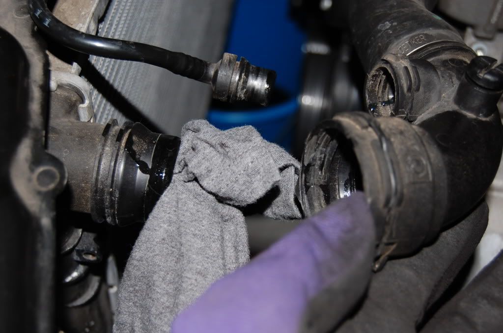

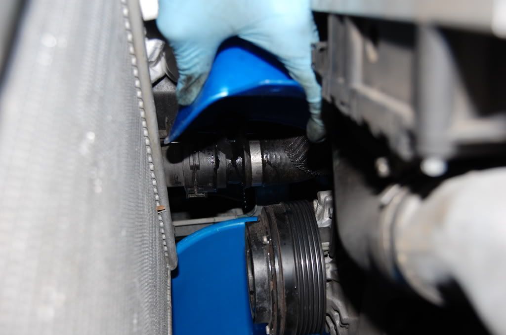

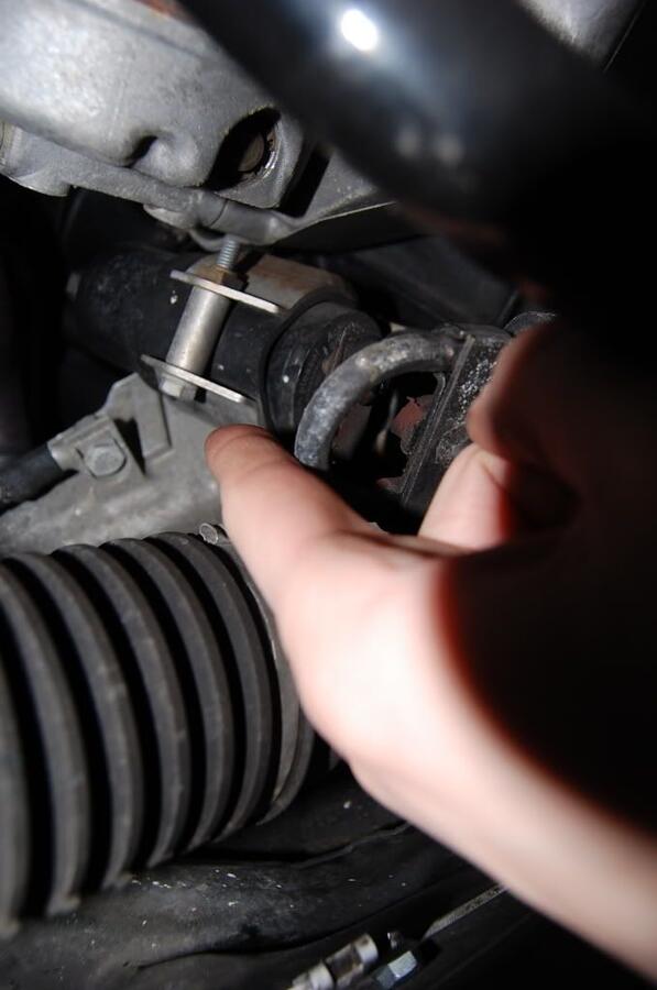

      Hoses can now be removed. As other DIYs have mentioned, the lower hose is really stuck on there and it’s difficult to get any leverage on since it’s in a tight space. As I’ll show in later photos, I was able to get my radiator out with the lower hose still attached.
      Click image for larger version  Name:	DSC_0048.jpg Views:	0 Size:	65.2 KB ID:	86491
      Click image for larger version  Name:	DSC_0049.jpg Views:	0 Size:	66.1 KB ID:	86492
      Click image for larger version  Name:	DSC_0050.jpg Views:	0 Size:	84.3 KB ID:	86493
      Click image for larger version  Name:	DSC_0052.jpg Views:	0 Size:	61.7 KB ID:	86494

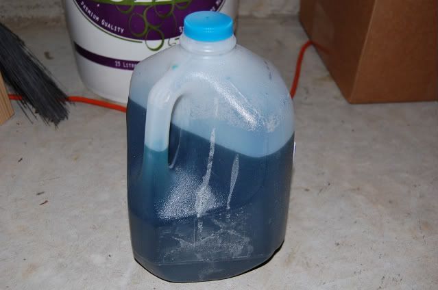

        From the draining so far, I was able to get nearly a gallon of fluid out. You can turn your ignition back off now.

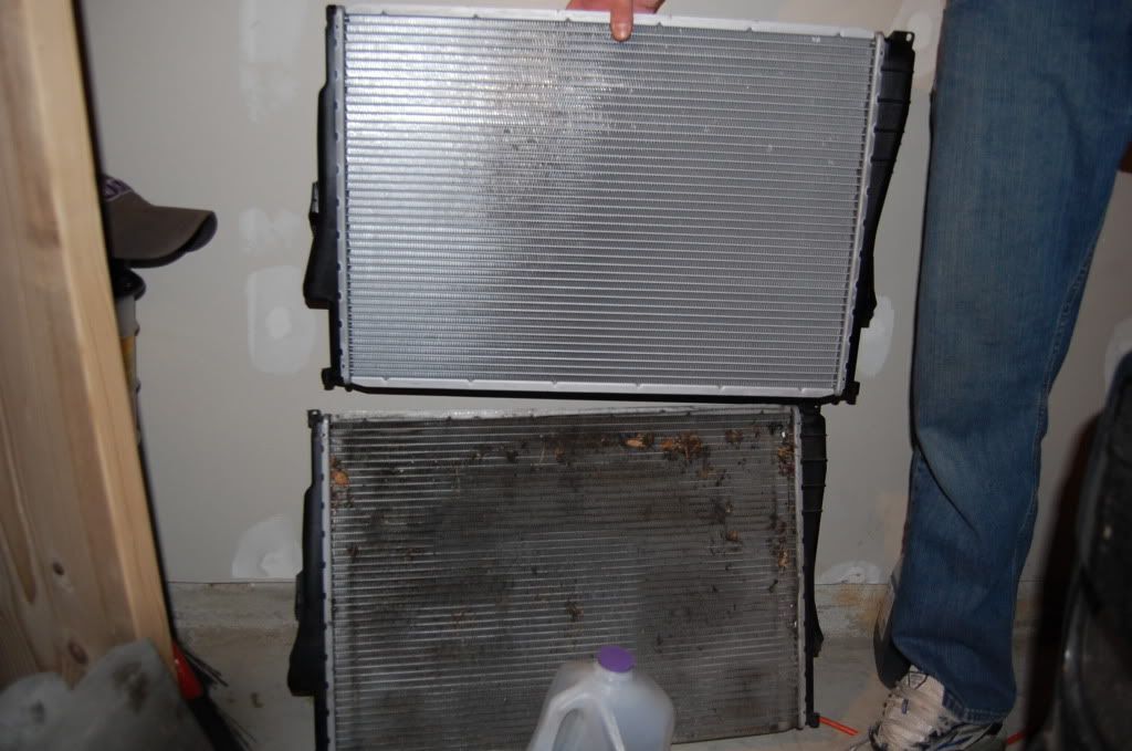

        Old and new.
        Click image for larger version  Name:	DSC_0061.jpg Views:	0 Size:	83.7 KB ID:	86500
        Click image for larger version  Name:	DSC_0055.jpg Views:	0 Size:	105.8 KB ID:	86501

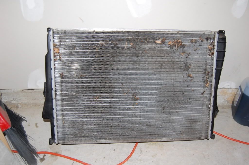

        Tip the radiator on its side to get the last of the fluid out.

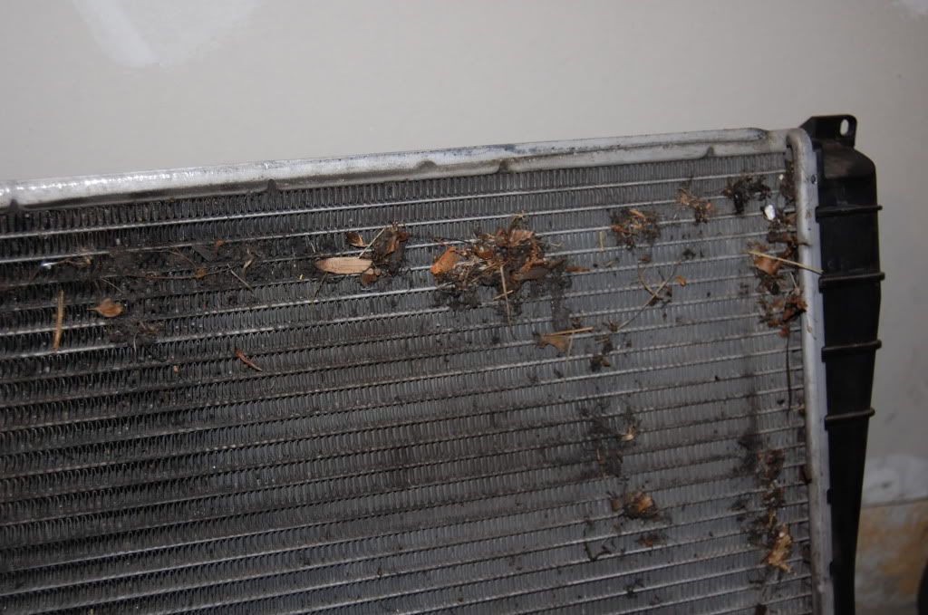

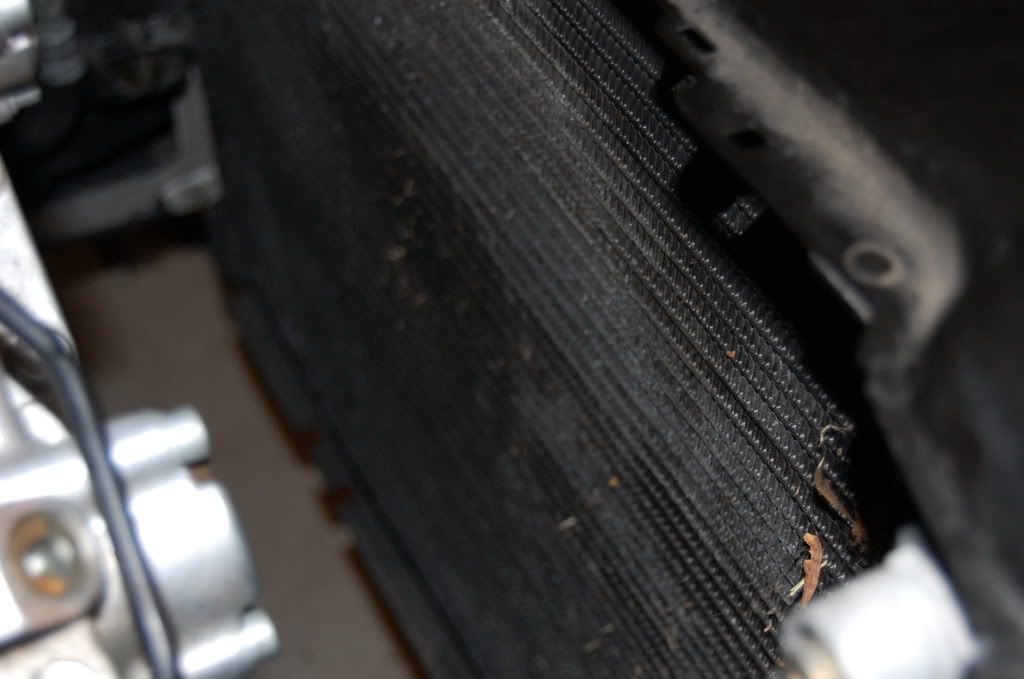

        With the radiator out, you’ll have access to the back of the A/C condenser. This is a good time to clean it as there is likely a lot of debris in there. I recommend a tooth brush and a vacuum.
        Click image for larger version  Name:	DSC_0058.jpg Views:	0 Size:	54.6 KB ID:	86503
        Click image for larger version  Name:	DSC_0059.jpg Views:	0 Size:	61.5 KB ID:	86504

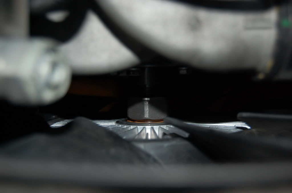

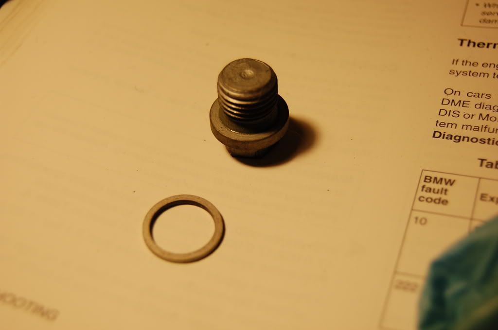

        To get the remaining fluid out, you need to drain the engine block. Get your rags ready. The drain plug is a 13mm bolt on the passenger side of engine. From underneath, it’s basically impossible to see. You can move this canister out of the way for easier access, but I was able to reach the plug with a simple extension.
        Click image for larger version  Name:	DSC_0067.jpg Views:	0 Size:	45.1 KB ID:	86505
        A lot of fluid is going to come out, and because it’s going to hit other things, it will spray everywhere. The bucket will catch most of it; the rest will just have to be mopped up. Consider it a chance to clean your garage floor.
        Click image for larger version  Name:	DSC_0069.jpg Views:	0 Size:	86.4 KB ID:	86506
        Click image for larger version  Name:	DSC_0071.jpg Views:	0 Size:	101.6 KB ID:	86507
        Here is the total so far, not including the half gallon that ended up on the floor. The system capacity is 10 liters or about 2.6 gallons. I figure I was able to get pretty close to that, although it may have been better to have the car more level and not leaned back slightly. In any case, I was happy with the results. This is a good time to mention that if you are able to drain the system completely, and want to refill with a 50/50 ratio of coolant to water, you’ll need two gallons of BMW coolant. I had two on hand just in case.
        Click image for larger version  Name:	DSC_0072.jpg Views:	0 Size:	20.4 KB ID:	86508
        Here is the drain plug. I reused the washer. Re-torque to 18 ft-lb.
        Click image for larger version  Name:	DSC_0073.jpg Views:	0 Size:	28.9 KB ID:	86509

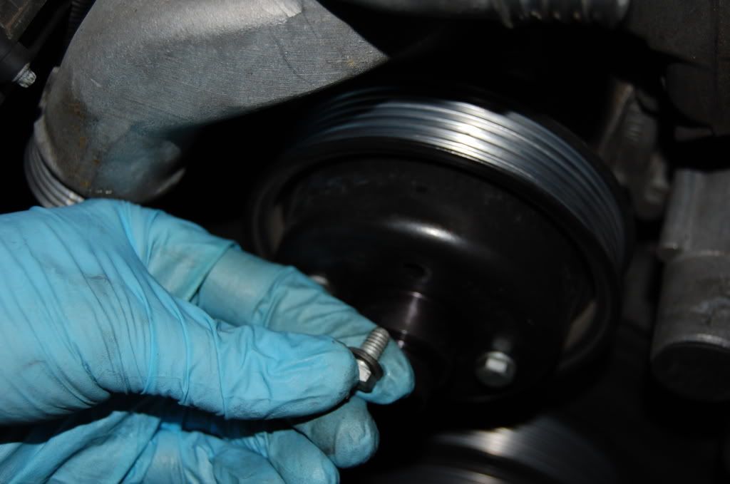

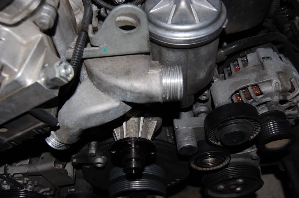

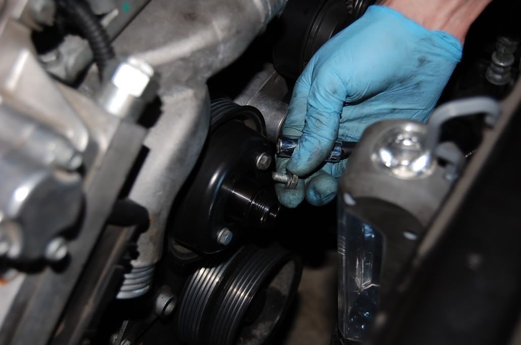

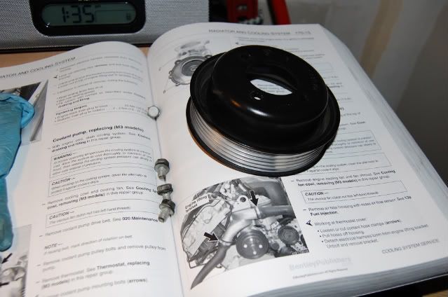

        Remove the four bolts from the water pump pulley.
        Click image for larger version  Name:	DSC_0074.jpg Views:	0 Size:	52.1 KB ID:	86510
        Click image for larger version  Name:	DSC_0075.jpg Views:	0 Size:	42.5 KB ID:	86511
        Here is the pump with no pulley.
        Click image for larger version  Name:	DSC_0076.jpg Views:	0 Size:	77.4 KB ID:	86512

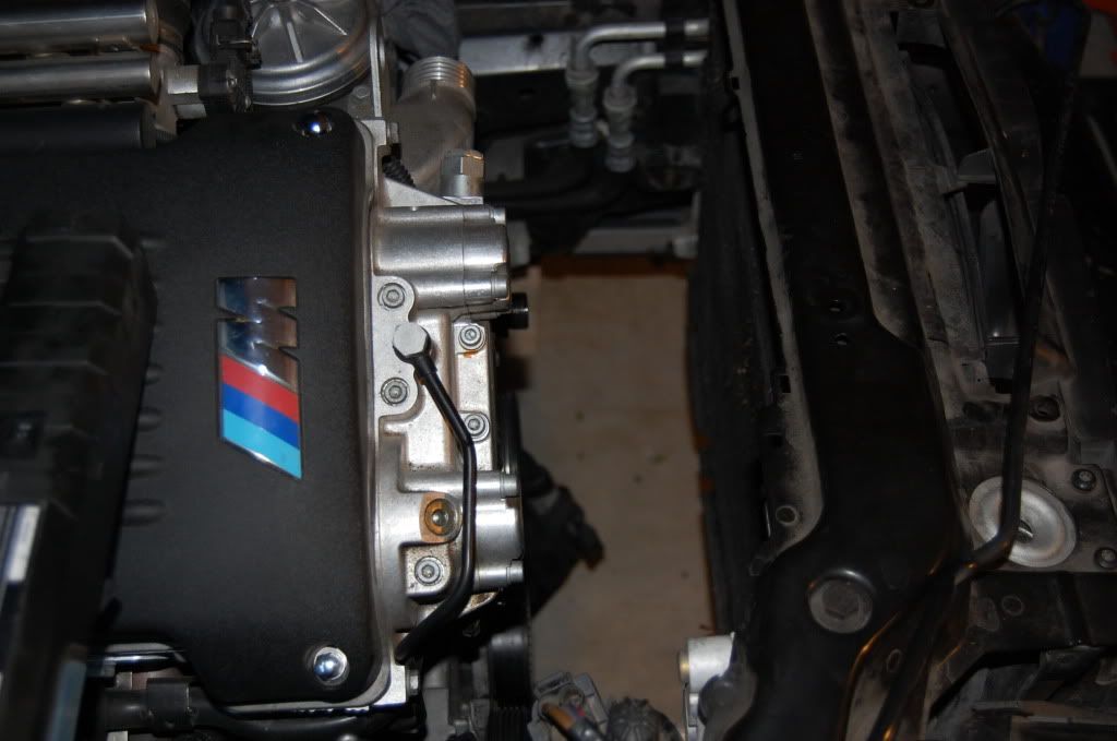

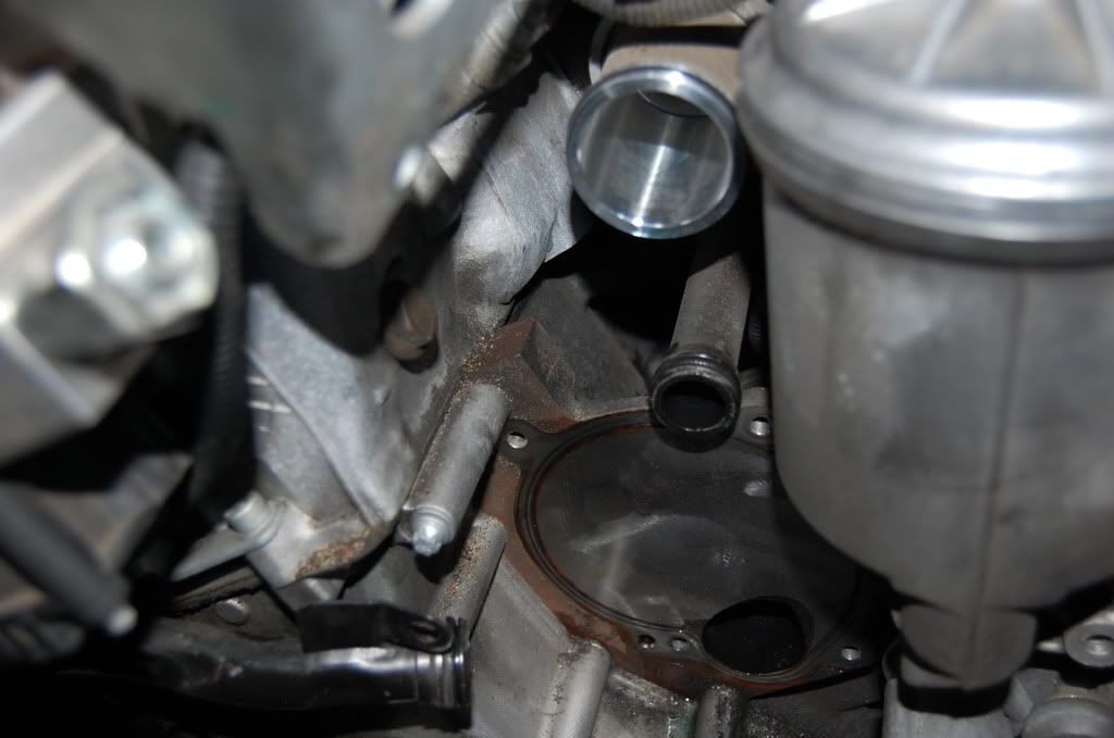

        Next, remove the three bolts that hold the thermostat housing (on the top of the Y-pipe).
        Click image for larger version  Name:	DSC_0077.jpg Views:	0 Size:	102.1 KB ID:	86513
        Click image for larger version  Name:	DSC_0079.jpg Views:	0 Size:	67.9 KB ID:	86514

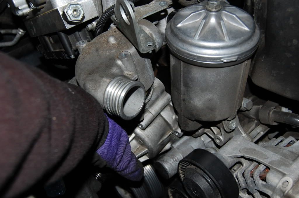

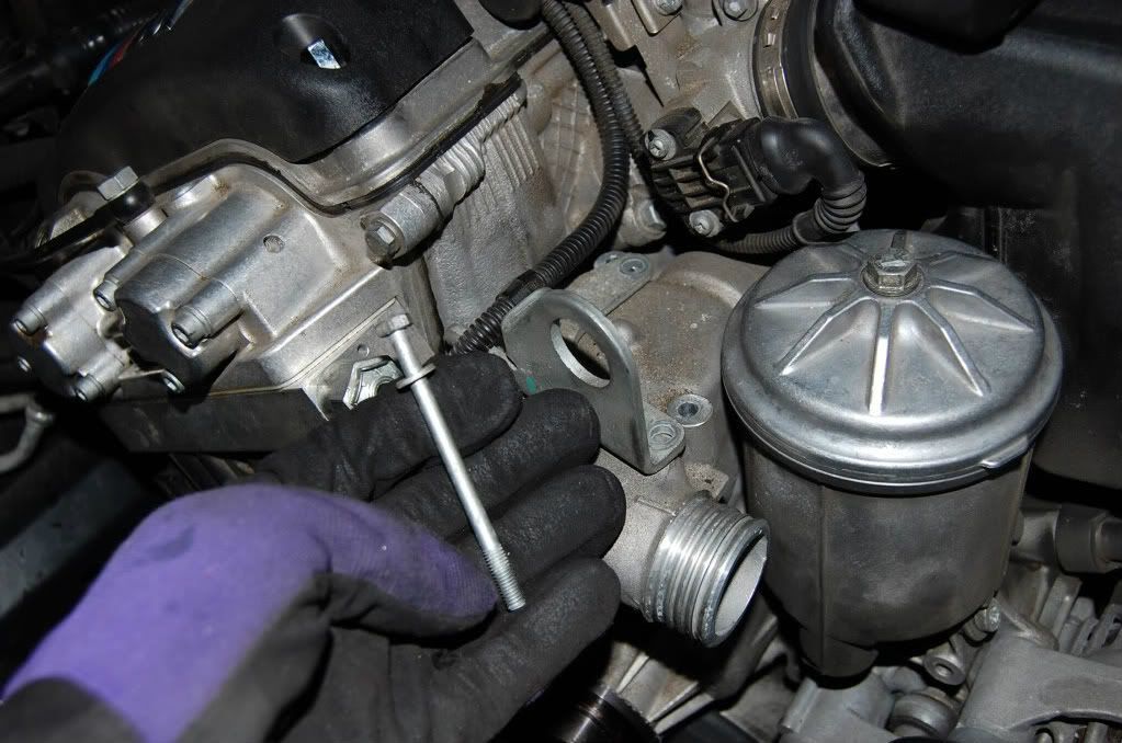

        Next, remove the five bolts holding the water pump and remove it carefully. Again, I was a bit OCD on keeping bolts organized.
        Click image for larger version  Name:	DSC_0085.jpg Views:	0 Size:	92.4 KB ID:	86515
        Click image for larger version  Name:	DSC_0080.jpg Views:	0 Size:	40.2 KB ID:	86516

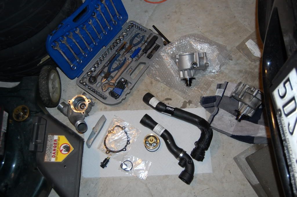

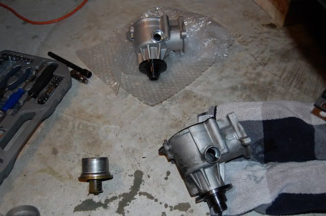

        Here is the old system with the new water pump in the background.
        Click image for larger version  Name:	DSC_0089.jpg Views:	0 Size:	40.2 KB ID:	86517
        Parts!
        Click image for larger version  Name:	DSC_0093.jpg Views:	0 Size:	103.0 KB ID:	86544

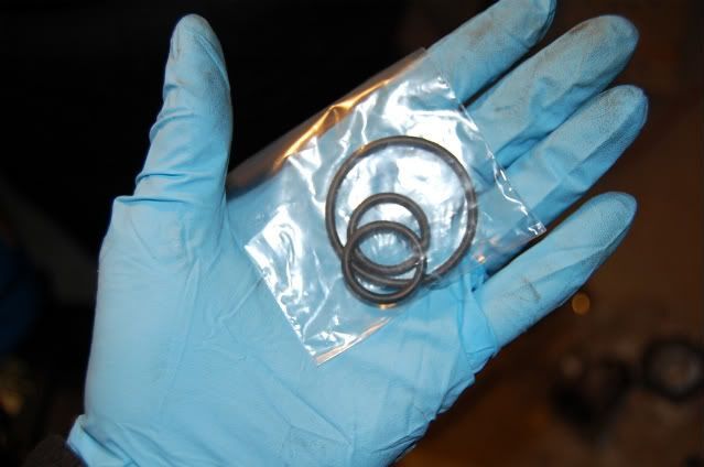

        Replace the o-rings on these three pipes. Clean the area where the new pump will seal with the block.
        Click image for larger version  Name:	DSC_0091.jpg Views:	0 Size:	57.4 KB ID:	86520
        Click image for larger version  Name:	DSC_0096.jpg Views:	0 Size:	28.7 KB ID:	86521
        With all the o-rings in place, put the new gasket on the back of the water pump and install. A new o-ring goes on top of the pump where it will seal with the thermostat housing. The thermostat housing then slides into place. Make sure everything is lined up properly before re-installing the torquing the bolts back down. Again, this is an area where you don’t want to use too much force. Both the coolant pump to the timing chain cover, and the thermostat housing to the pump are only 7 ft-lb. Too much torque could ruin a seal, or worse, break a bolt head. I wish I had gotten some pictures of this step, but my hands were full. If you’ve dis-assembled the system, putting it back in will be simple.

        You can then re-install the pulley to the new pump (10Nm). As a small side note, if you need to do any other work to the front of your engine, plan on getting it done now while you have plenty of room. If you have high mileage, it’s probably a good time to replace your alternator or pulleys. See the DIY reference sticky for more info: http://www.m3forum.net/m3forum/showthread.php?t=349996

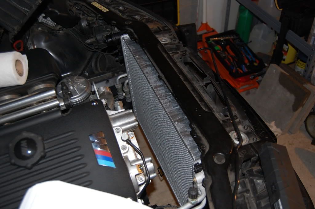

        Slide the new radiator in
        Click image for larger version  Name:	DSC_0103.jpg Views:	0 Size:	83.0 KB ID:	86523

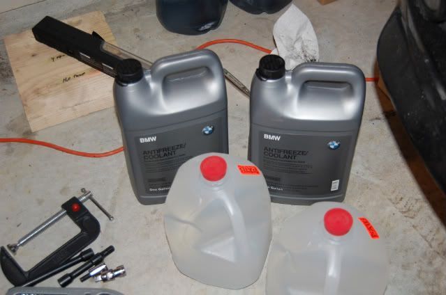

          With the new system in, you’re ready to re-fill with fresh fluid and distilled water.

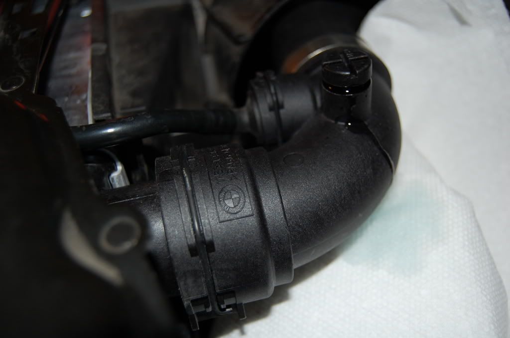

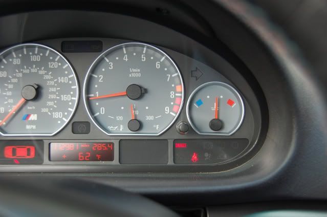

          Again, switch your ignition on and set the temperature to full warm, and make sure your bleeder valve (on the upper radiator hose) is cracked open. I recommend have a paper towel underneath the valve. Slowly add fluid into the expansion tank (on the passenger side of the engine). I did not pre-mix the coolant and water, but alternated every ¼ gallon or so while filling. You can hear the fluid as it flows back into the engine block and down the new radiator. Fill until fluid runs out of your bleeder valve. My car took a gallon of coolant and a gallon of water.

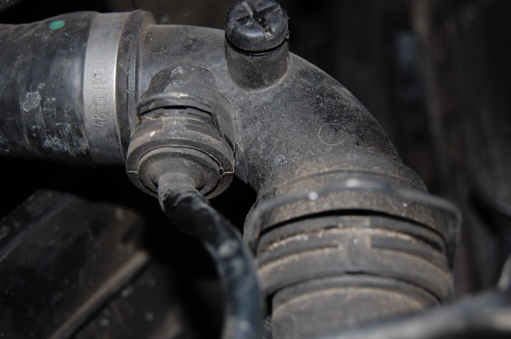

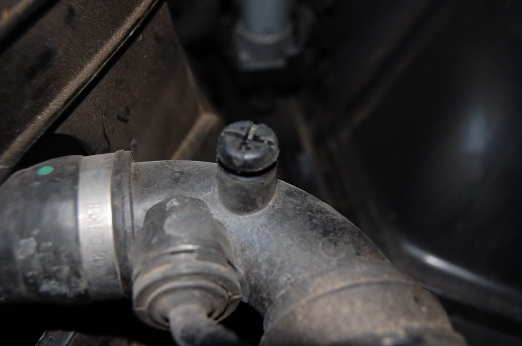

                FYI, the little black screw on the upper rad hose is vestigial. Our system is self bleeding. Exp tank is at the highest point and the cap is valved. Check the exp tank the next morning after the first drive as you'll likely have to add some once it's cooled and bubbles have risen to the top.
