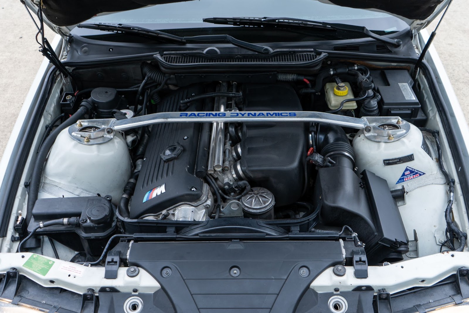

    So what was the replacement for the E46 M3? Well, A Porsche 996T sounds tempting but for a full time engineering student, that wasn’t feasible. So I settled on a S54 swapped Alpine white E36 M3 6 speed. I bought this car in Maryland. Did a few tweaks to it. Had Hassan retune it, coilovers, and an aggressive alignment. Talk about a riot. But in the end, that car never felt “mine” and most of my friends are calling me retarded for selling it but in all reality I never loved the car. It was fun but it wasn’t my car. Shortly after picking up the E36, I was casually browsing bimmerforums because I missed my E46 M3. The S54 E36 didn’t feel as special compared to an E46M. The instrument cluster didn’t feel special and the e36 just felt like a cheap old 3 series.

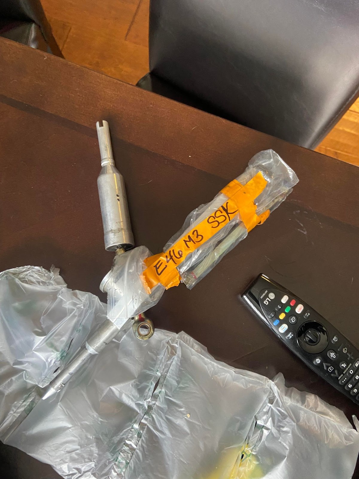

          I’m definitely excited to install the Auto Solution SSK

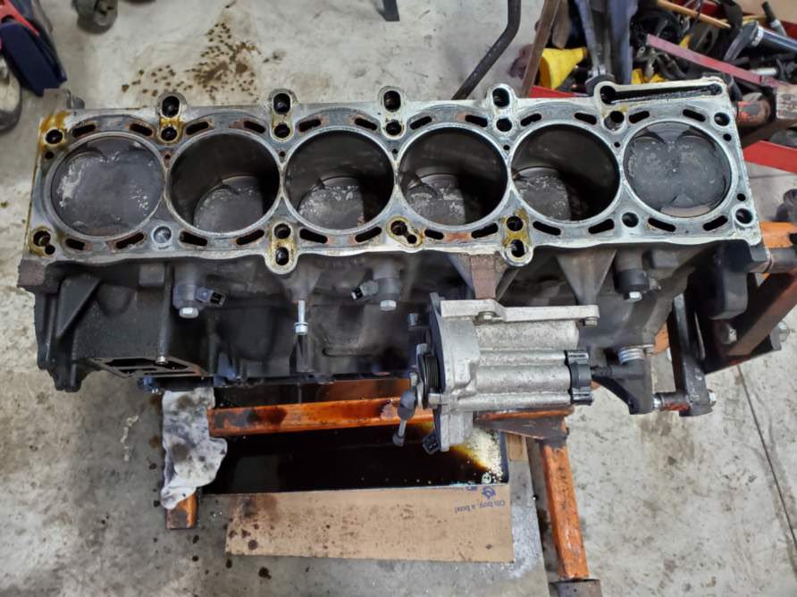

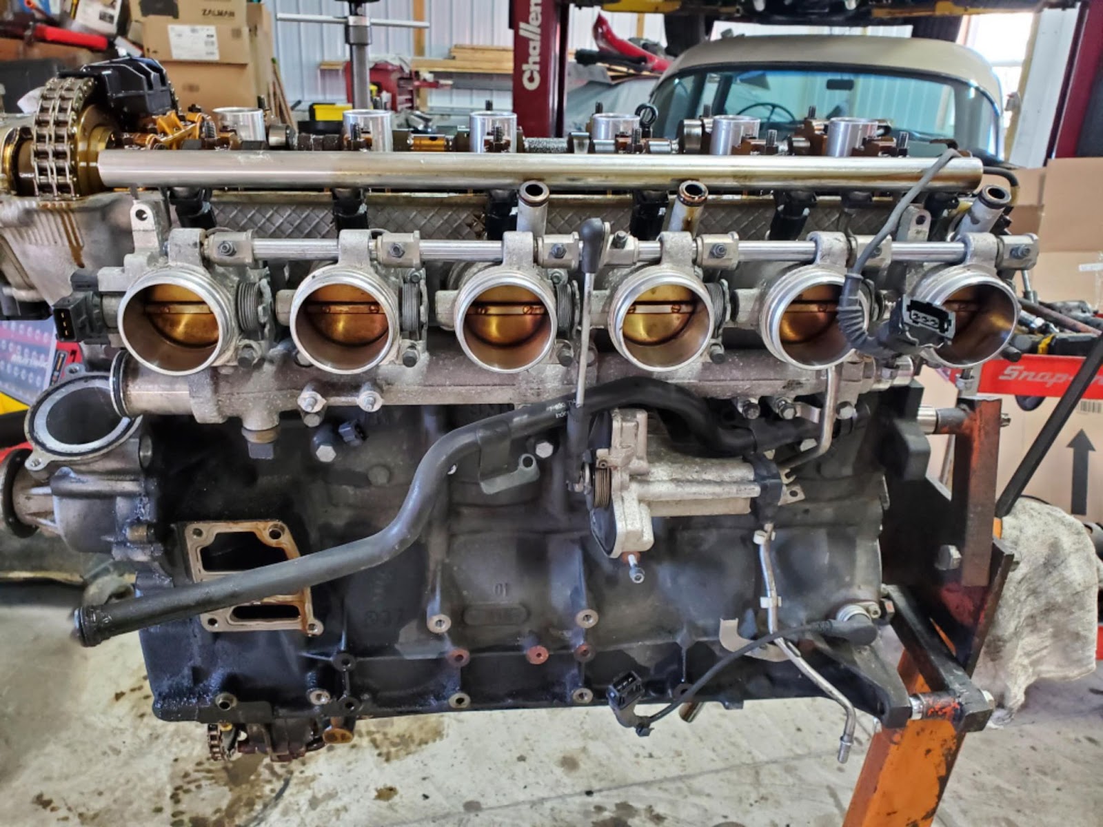

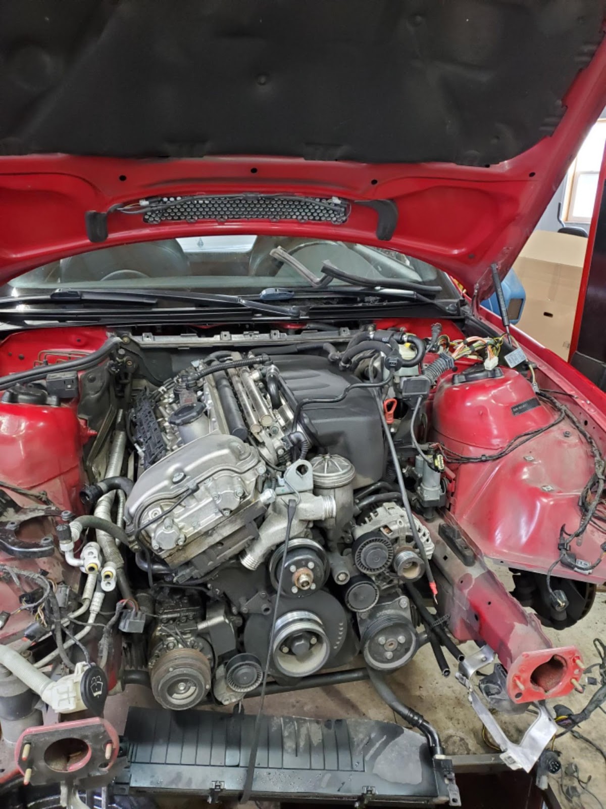

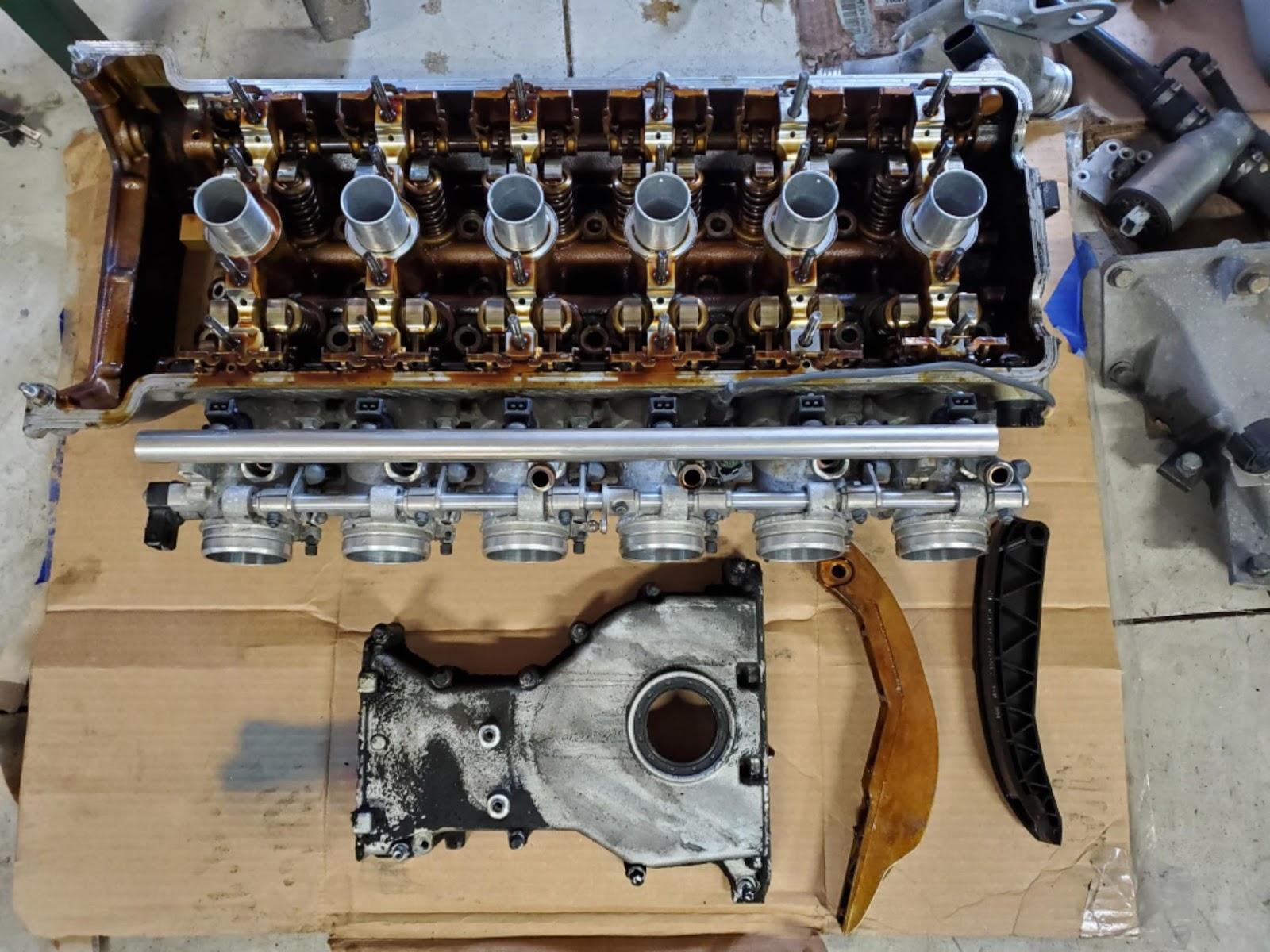

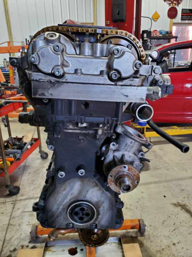

          Ready for the engine to be pulled so it can get:-
          • New timing chain guides
          • New Headgasket and Head Bolts
          • Rod Bearings
          • Vanos
          • Valves Adjusted
          • Complete reseal
          • Block painted black
          • European Catless headers
          • New clutch kit as well
          Disaster in Progress

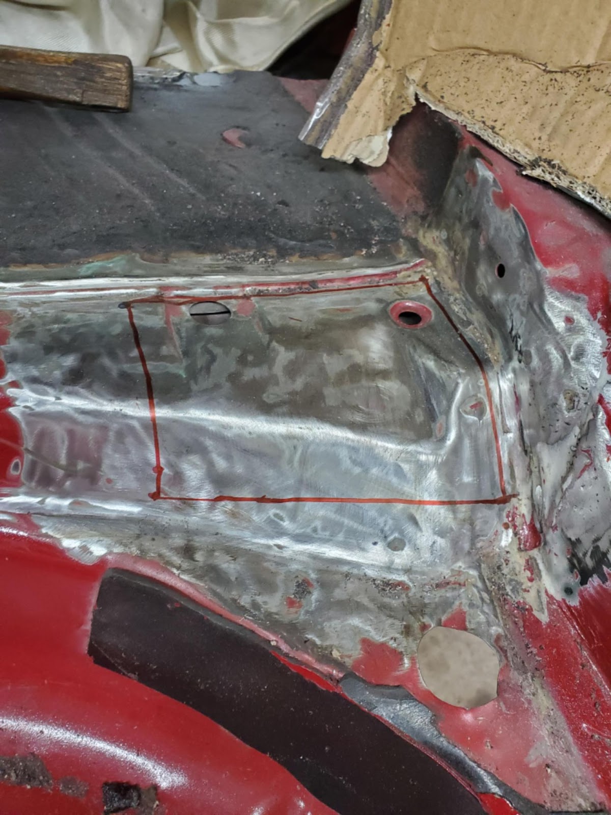

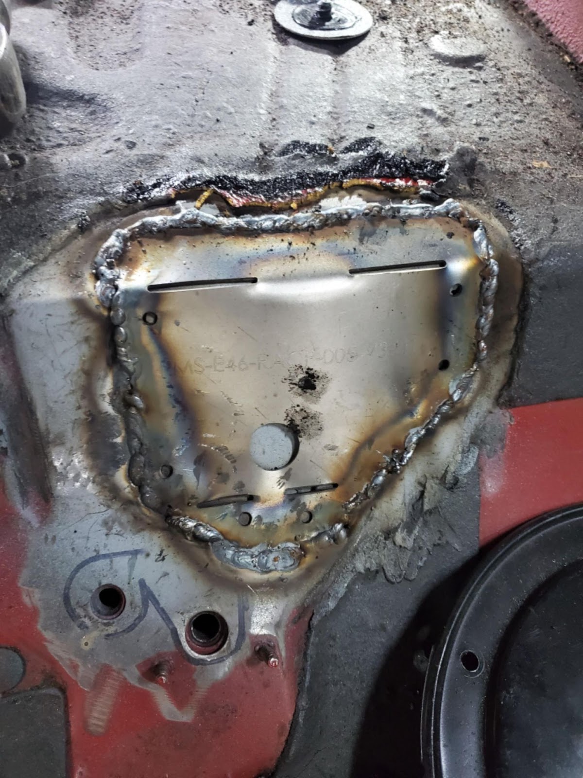

          Reddish V3 Plates ready to be welded up

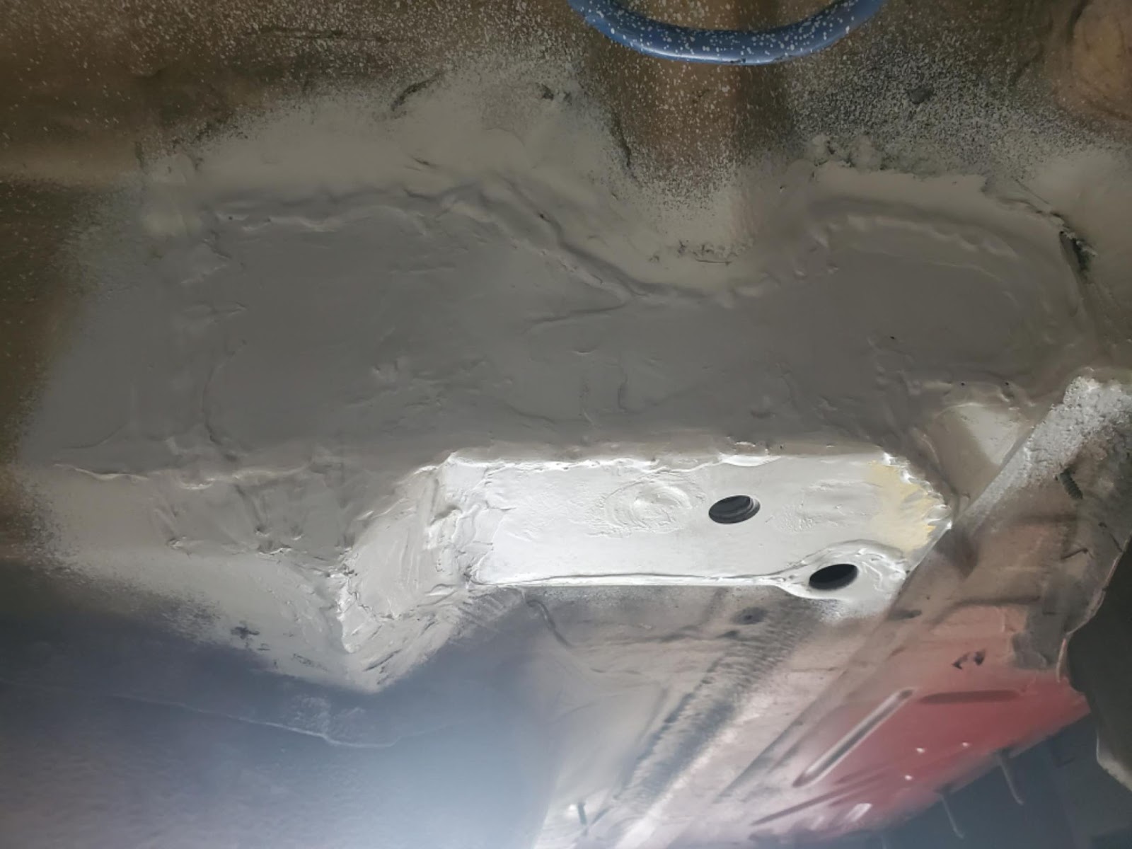

            Some seam sealer action
            Top side RACP
            Not the best welds but I’m working on being better

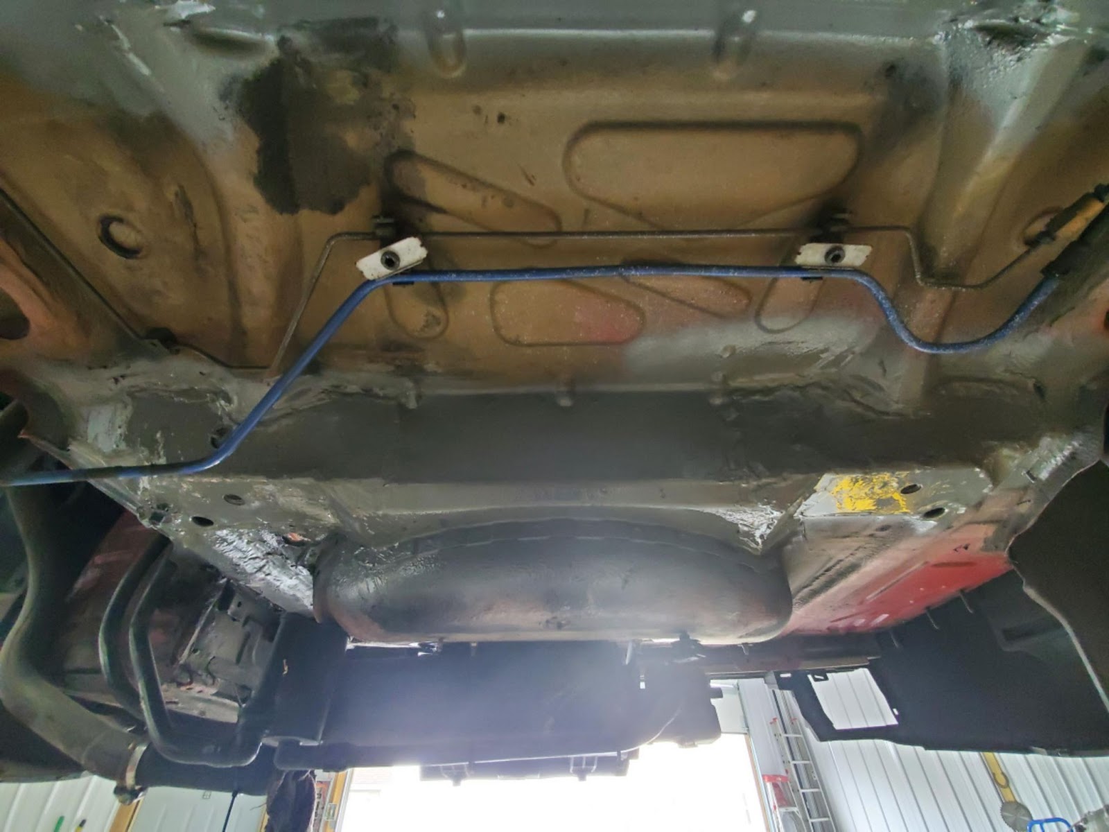

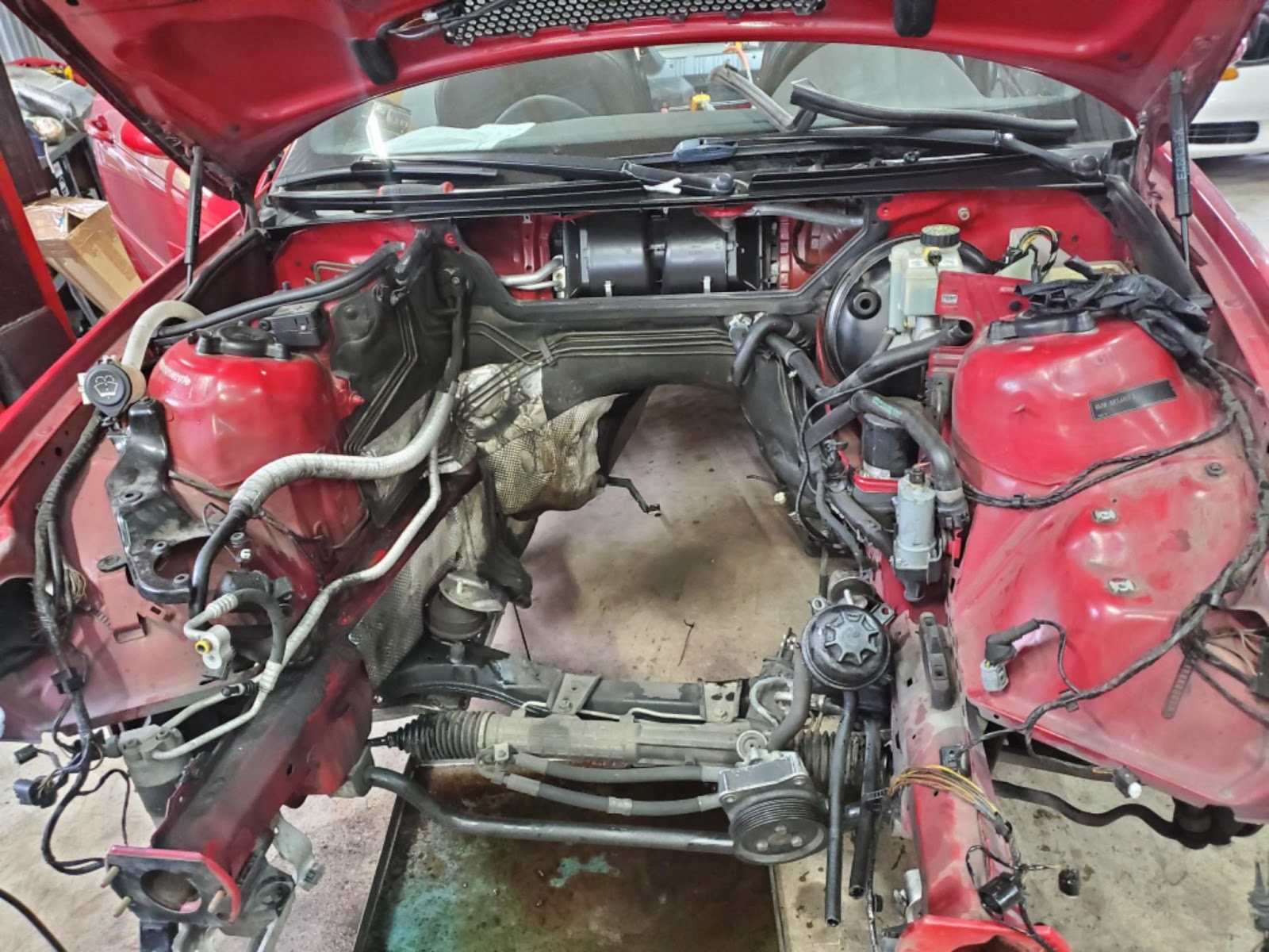

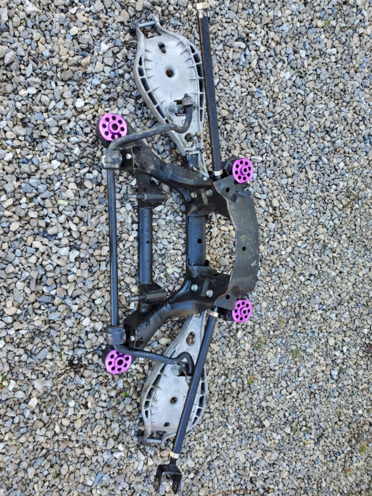

            At this point it’s just a shell
            Power Washed the Subframe
