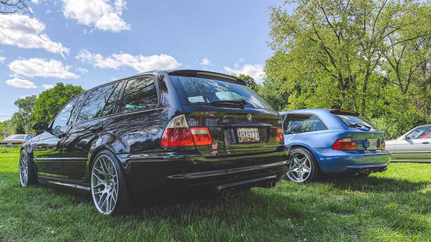

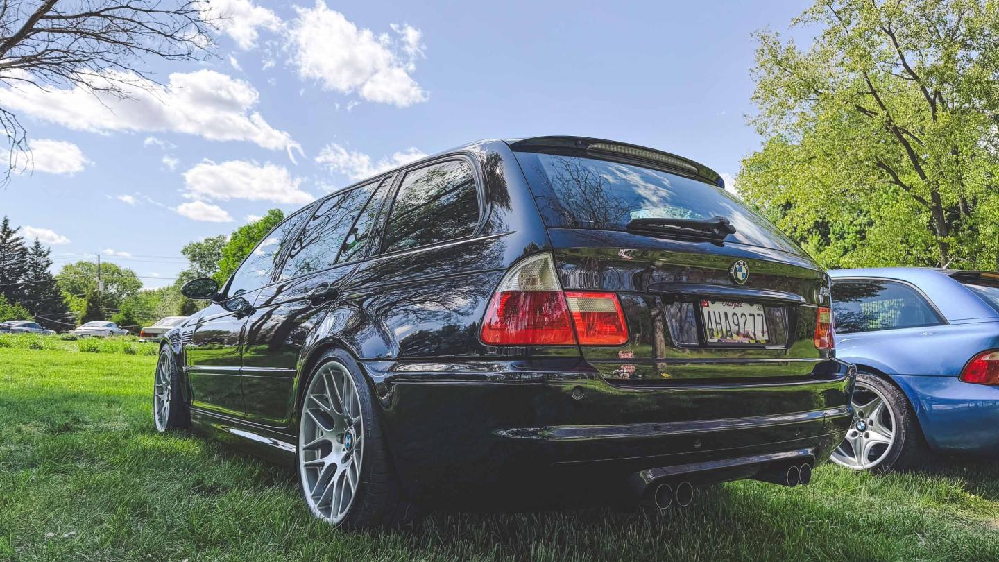

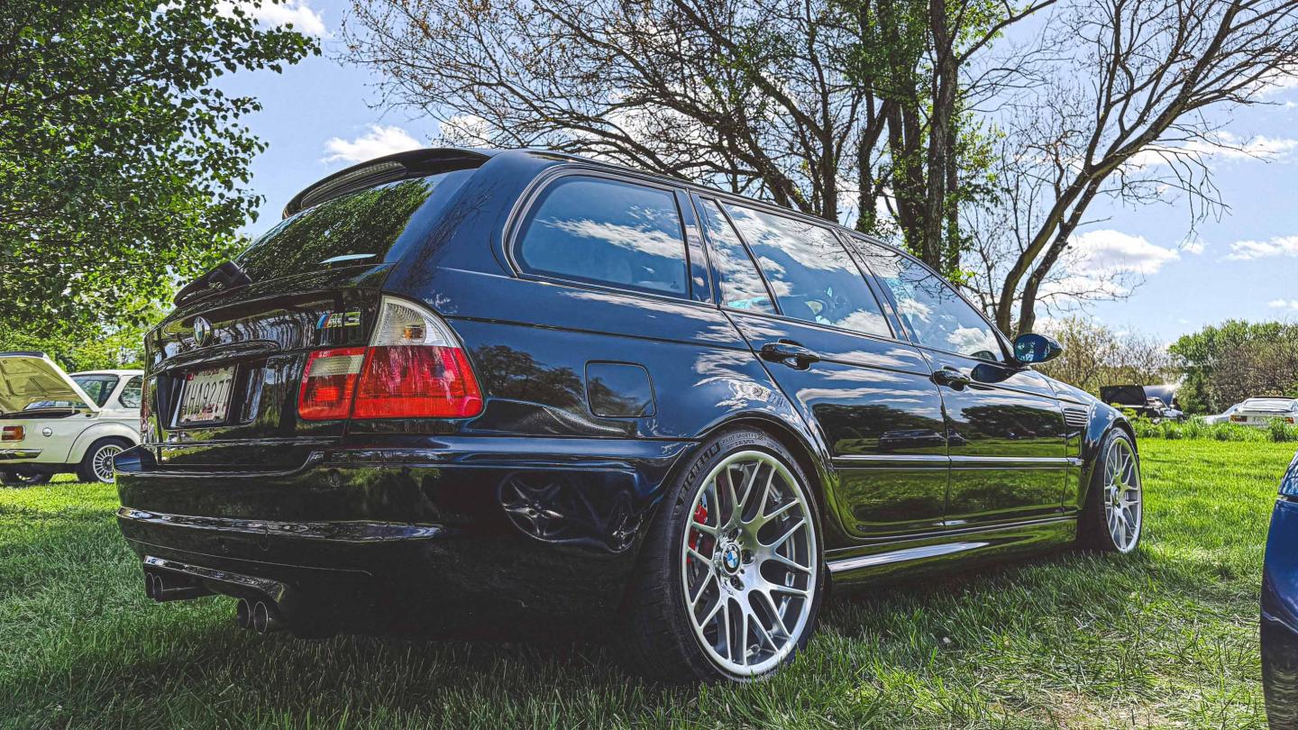

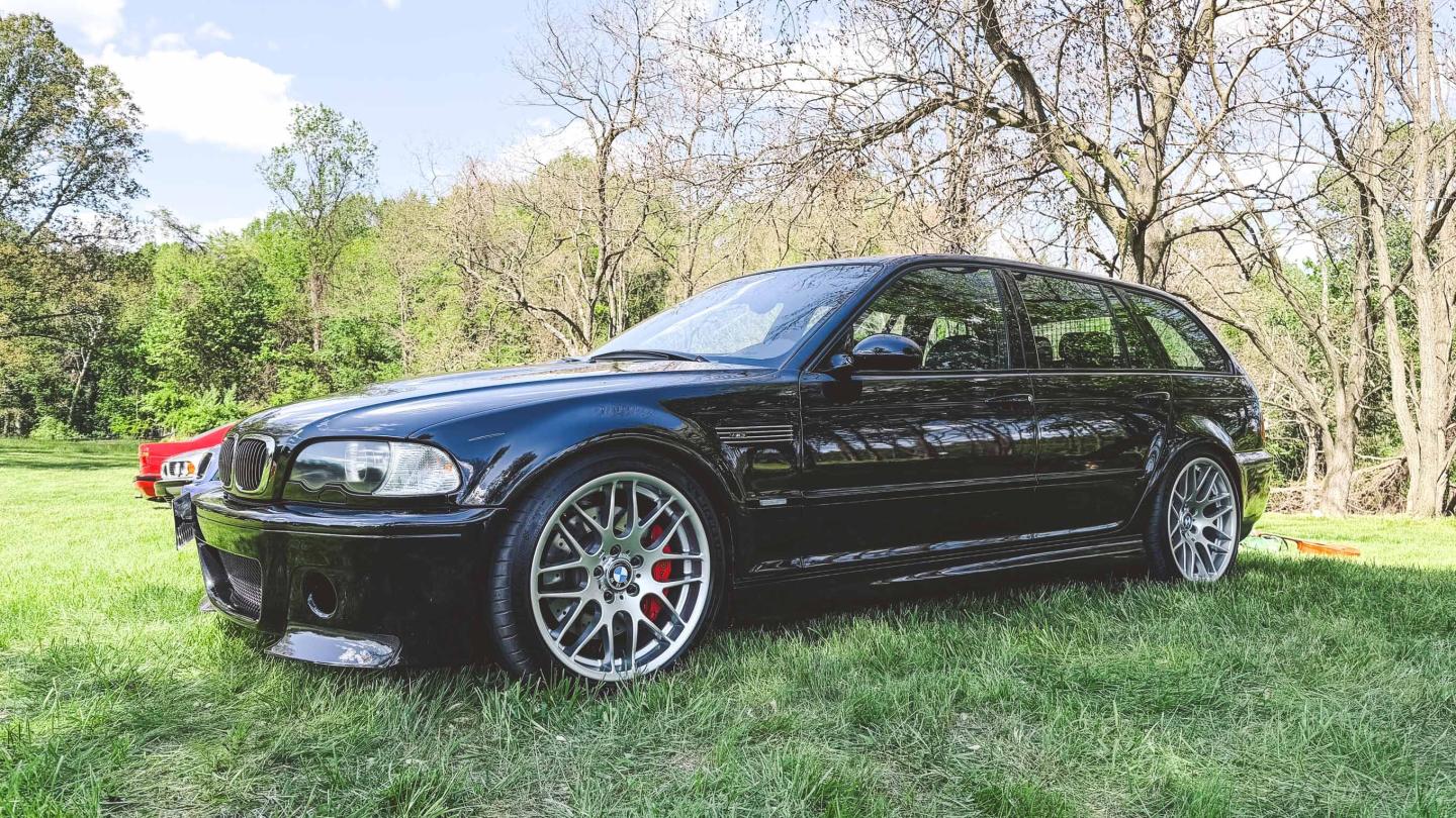

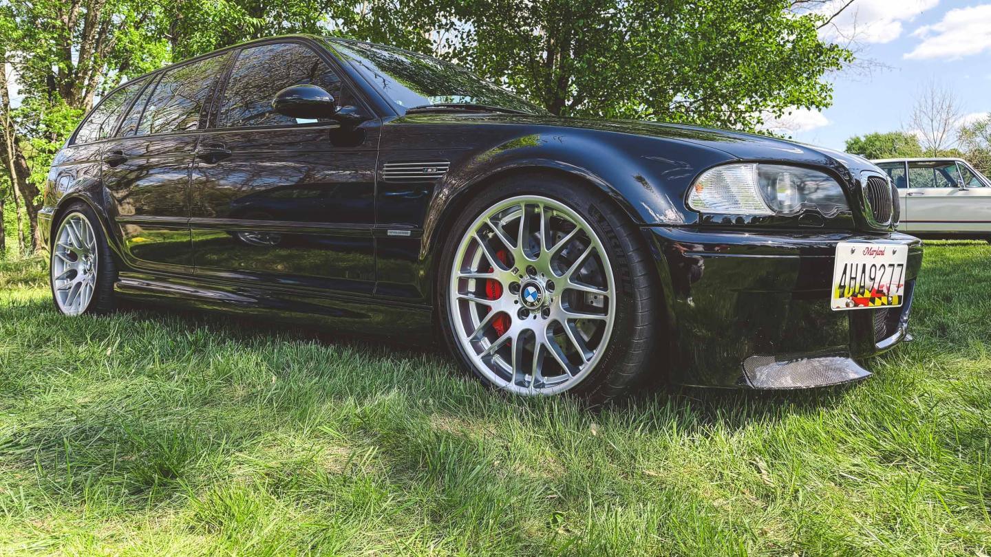

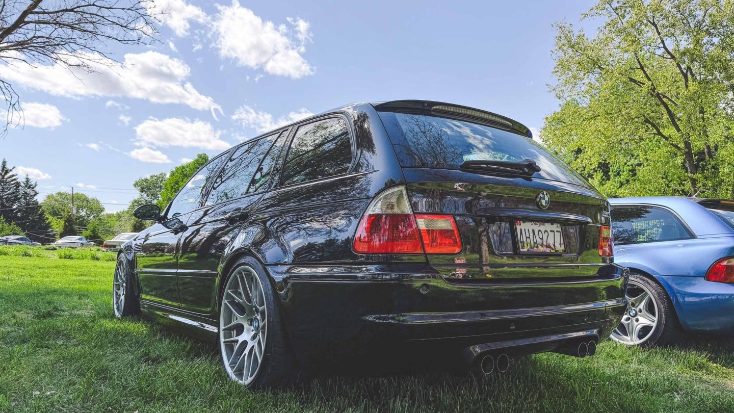

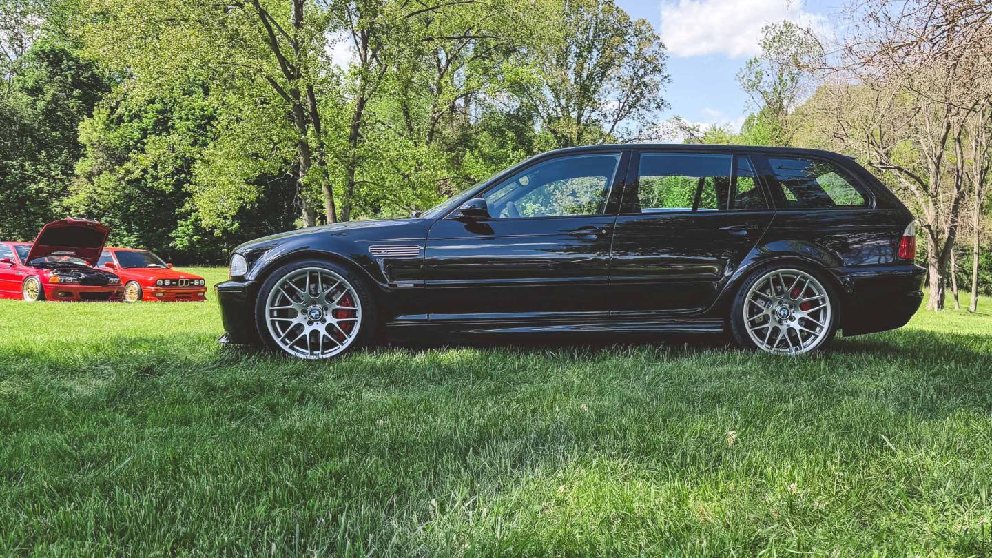

      Took home a top award over the weekend at the 42nd Annual Deutsche Marque Concours d'Elegance.​
      Click image for larger version  Name:	concours2026-e46M3Touring_Win-7.jpg Views:	0 Size:	139.4 KB ID:	354720​
      Click image for larger version  Name:	concours2026-e46M3Touring_Win.jpg Views:	0 Size:	365.2 KB ID:	354721​Click image for larger version  Name:	concours2026-e46M3Touring_Win-5.jpg Views:	0 Size:	330.8 KB ID:	354722​
      Click image for larger version  Name:	concours2026-e46M3Touring_Win-6.jpg Views:	0 Size:	352.2 KB ID:	354723​Click image for larger version  Name:	concours2026-e46M3Touring_Win-3.jpg Views:	0 Size:	254.4 KB ID:	354724​Click image for larger version  Name:	concours2026-e46M3Touring_Win-2.jpg Views:	0 Size:	362.2 KB ID:	354725​

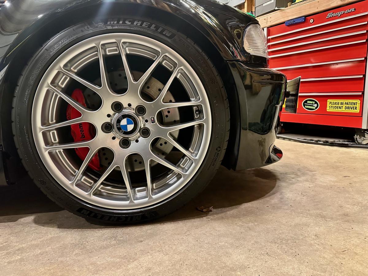

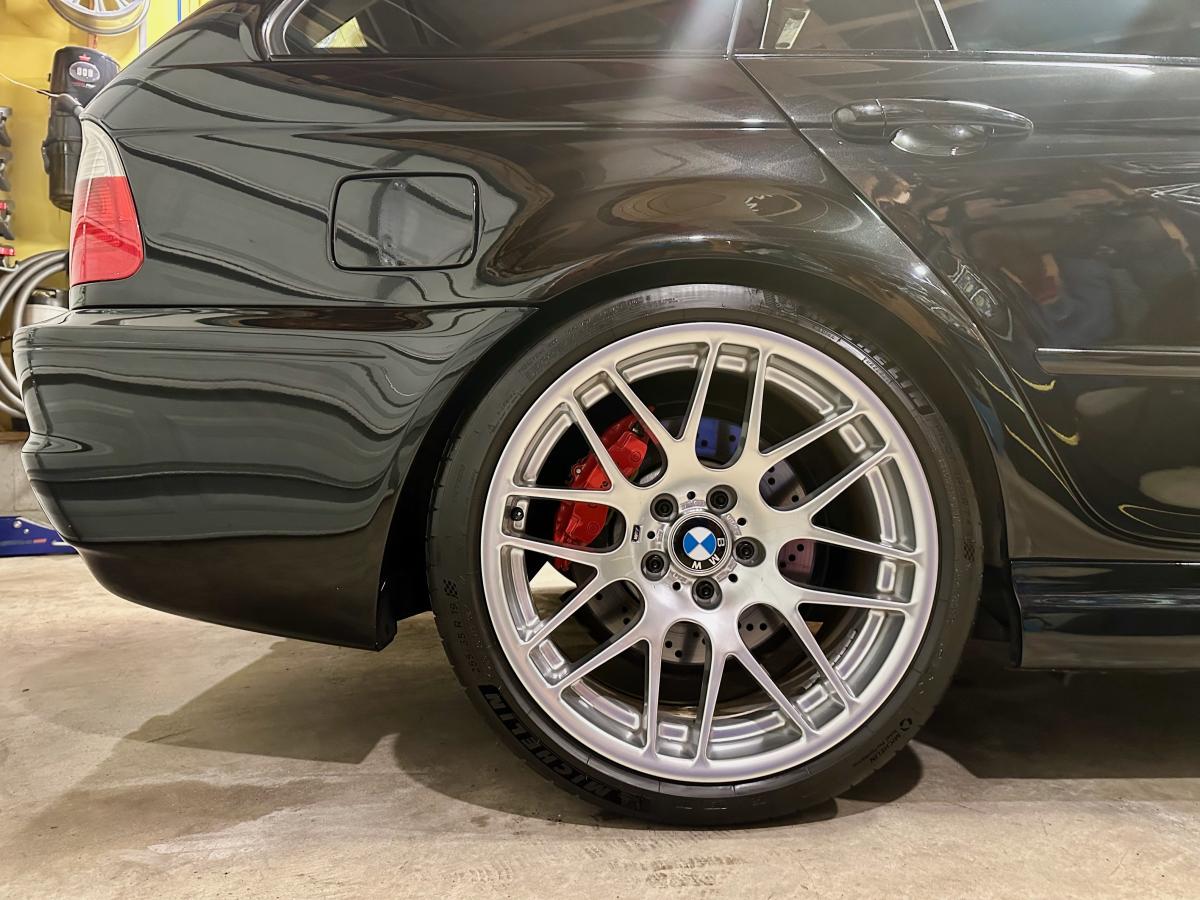

        Oh yeah forgot to mention a change since I received the car back from M3Projekts. I had a big brake kit installed - Mégane RS Trophy-R fronts + Porsche 996 rears.
        The only issue I have are them being squeeky, which is probably 99.9% the brake pads I used (EBC yellow). Maybe I should use the ones you used. Oh yeah I had to use 17.5mm wheel spacers in the front to clear the calipers. Since the rears were used I had them refurbished (powedercoat, in seals etc) by Renewed Finishes. I was on a time crunch to get them installed for a car show so I had Tier Care Care install them.
        Front:Rear:​ Click image for larger version  Name:	IMG_3337.jpg Views:	0 Size:	191.6 KB ID:	355227
        Click image for larger version  Name:	IMG_3341.jpg Views:	0 Size:	154.2 KB ID:	355228
