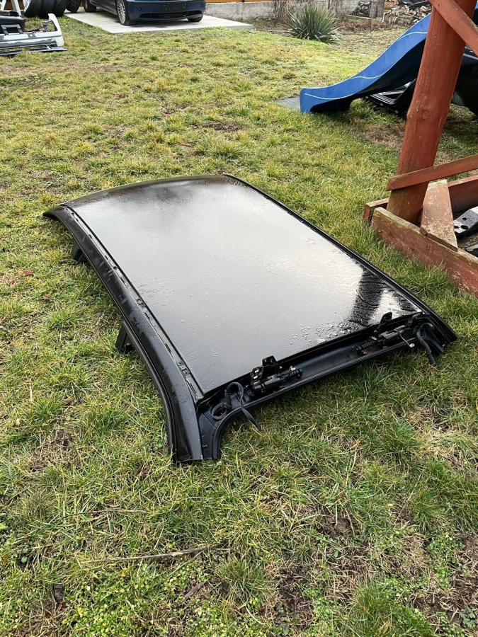

                  No sunroof delete panel for this one. Got the whole roof instead 😀

                              Following. Awesome projects, awesome logistics. Can't wait to see this unfold. That is a seriously long headliner, lol
