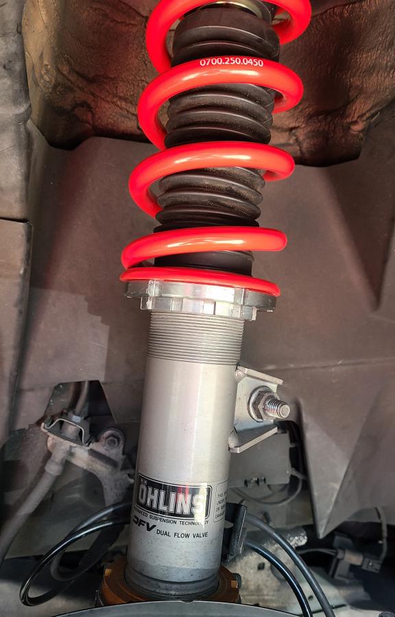

                Ohlins asks you to preload the spring by 6mm, then height adjustment is done with the strut body, where the hub clasps it. Only bad part, the adjustment knob is on the bottom. Everyone has theirs up top for adjustment in the engine bay
                Click image for larger version  Name:	E90Ohlinsinstall (11).jpg Views:	2 Size:	55.5 KB ID:	296028
                Very nice parts, easy to work with for adjustment. I set the damping knob about in the middle for now.

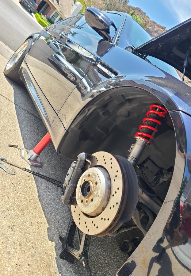

                Click image for larger version  Name:	E90Ohlinsinstall (15).jpg Views:	2 Size:	91.9 KB ID:	296029
                Comparison of Swift 672 (12kg) versus Ohlins 120N (685lb). Not too different. Ohlins is shorter to allow for adjustment perch.
                Click image for larger version  Name:	E90Ohlinsinstall (18).jpg Views:	2 Size:	250.5 KB ID:	296030
                Click image for larger version  Name:	E90Ohlinsinstall (19).jpg Views:	2 Size:	81.2 KB ID:	296031 Click image for larger version  Name:	E90Ohlinsinstall (22).jpg Views:	2 Size:	103.0 KB ID:	296033
                At least the rear's adjustment knobs are up top, but that area is covered by liners doh! I have no problem leaving liners out, but some have made nice holes in them for access. Maybe I'll get around to that.

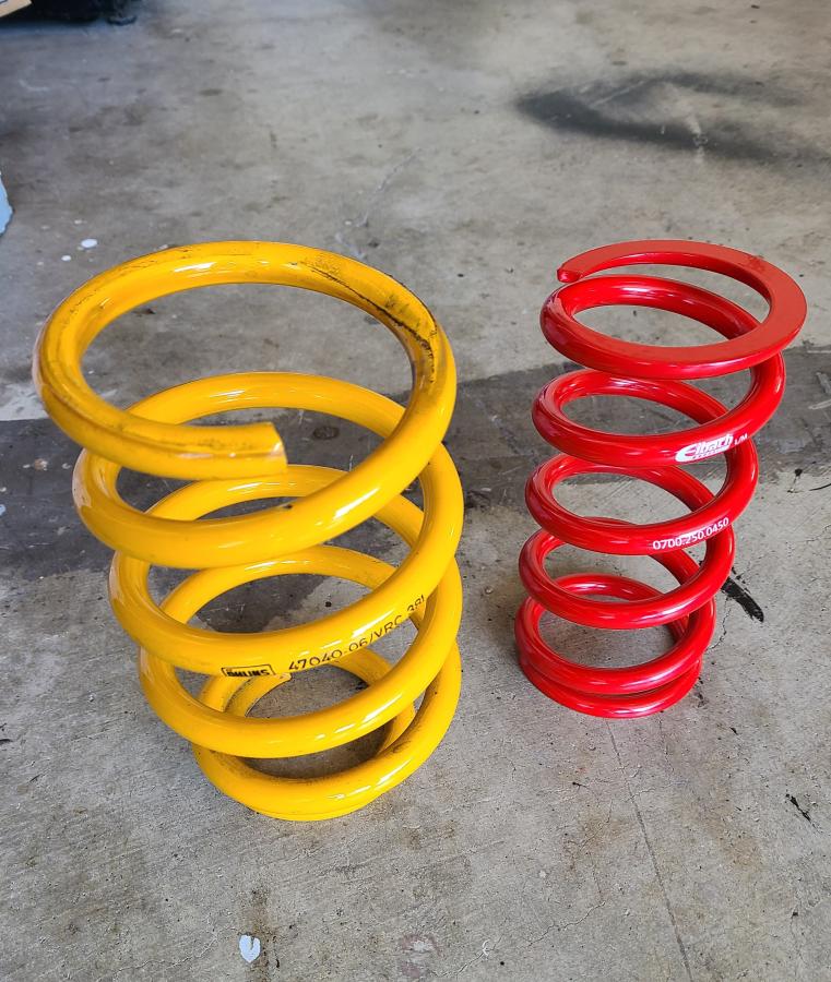

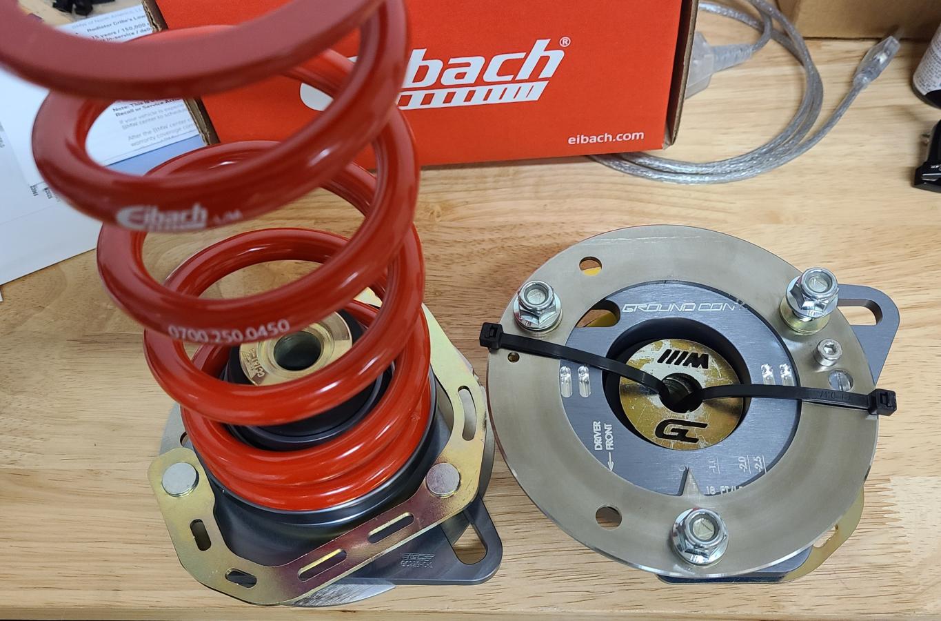

                      Ohlins vs Eibach coil. Much smaller and lighter!

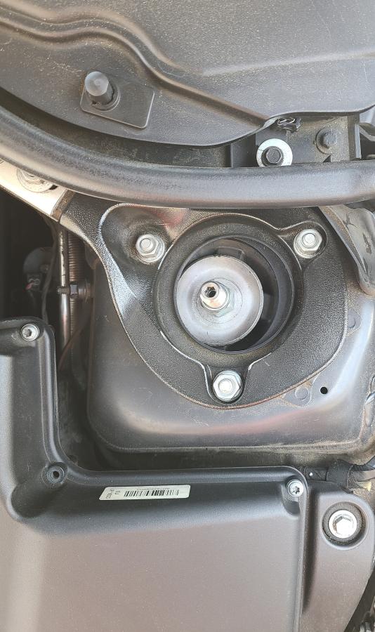

                      I took a picture of my current bilstein/dinan setup so I could eyeball the location of the strut for decent alignment. I love the custom GC ///M washers
ID:	313224 Click image for larger version

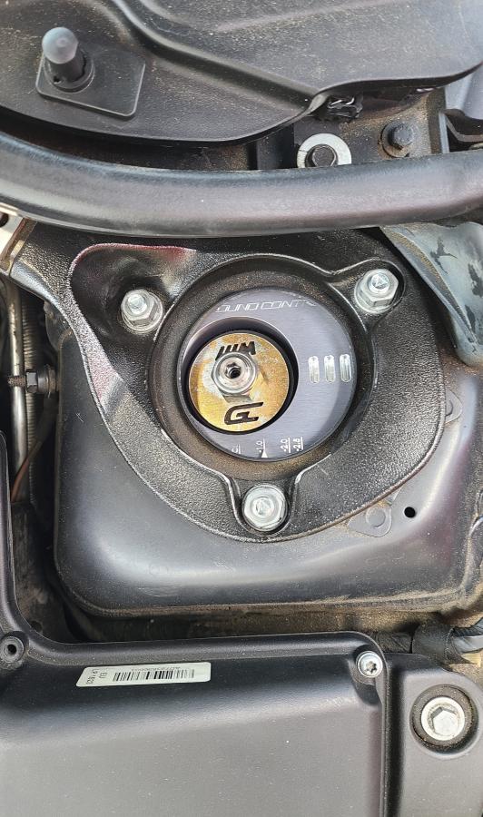

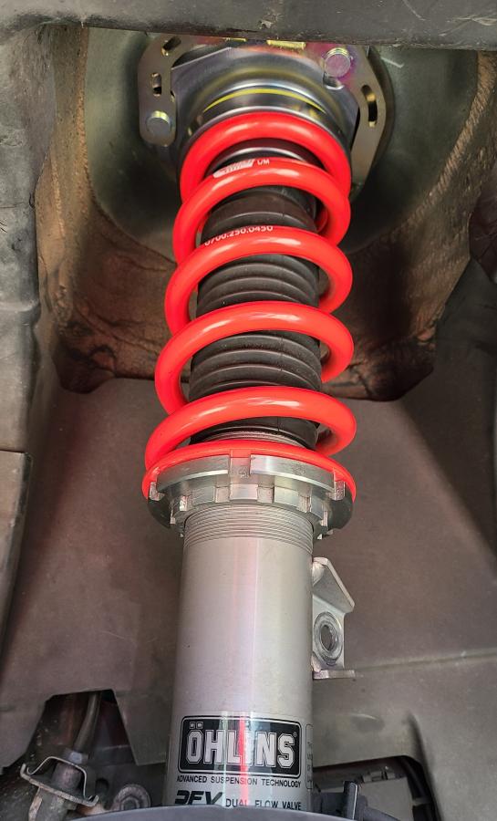

                      Since the new spring was a different height and weight, I knew I'd need to adjust the bottom perch upwards.
ID:	313225 Click image for larger version
                      I also went up to 5mm spacer from 3mm with new Apex bolts since I'd have more neg camber and stiffer springs
                      Oooo that's hawt
                      Unfortunately, the Ohlins can not properly control the rebound from these 2kg/in (100lb) stiffer springs. If you slow rebound with the Ohlins' adjustment knob, you also increase compression which just makes it bouncier. I'm also pretty low, lower than I should be and that contributes to an upset ride, but I'm willing to compromise a bit. My E46 is also low with stiff springs, yet it feels sublime (MCS ftw).
                      So, I'll need to grab a set of old stock dampers (I saved springs and mounts) and send the Ohlins to Barry at 3DM to revalve at some point.
                      If I put the ohlins at about halfway (15 clicks), it's a pretty good compromise and will do for now, but it all pales in comparison to the control my MCS have on my E46.

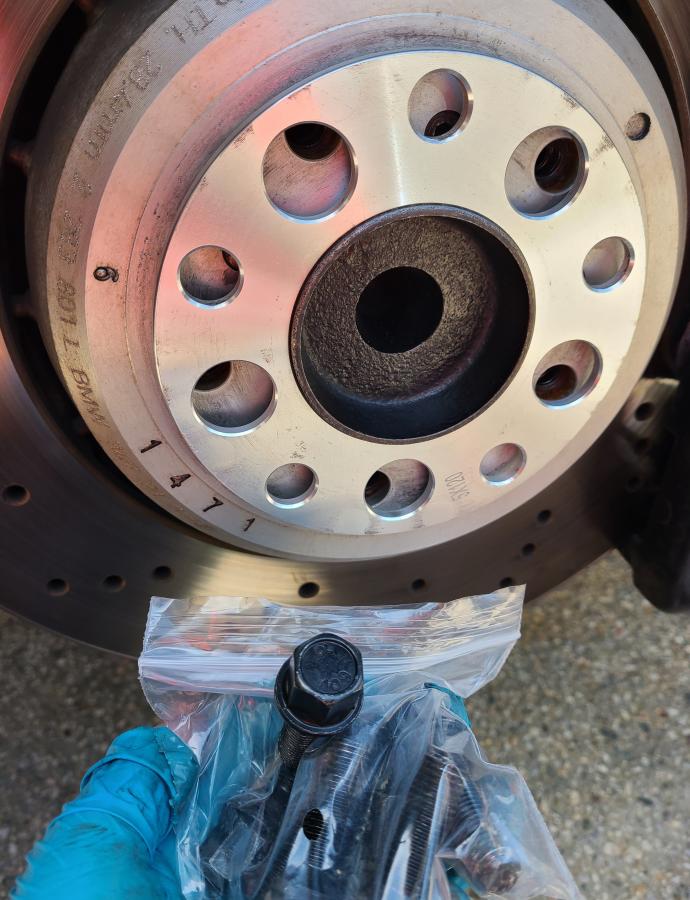

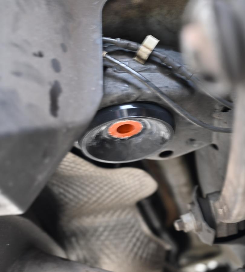

                        While doing the rear ohlins and swifts, I worked on the subframe bushes. I had gone with Whiteline poly in my e82 128i, and was very pleased with them. All the benefits of solid, with a little give.
                        Click image for larger version  Name:	E90subbush (9).jpg Views:	0 Size:	62.9 KB ID:	316943

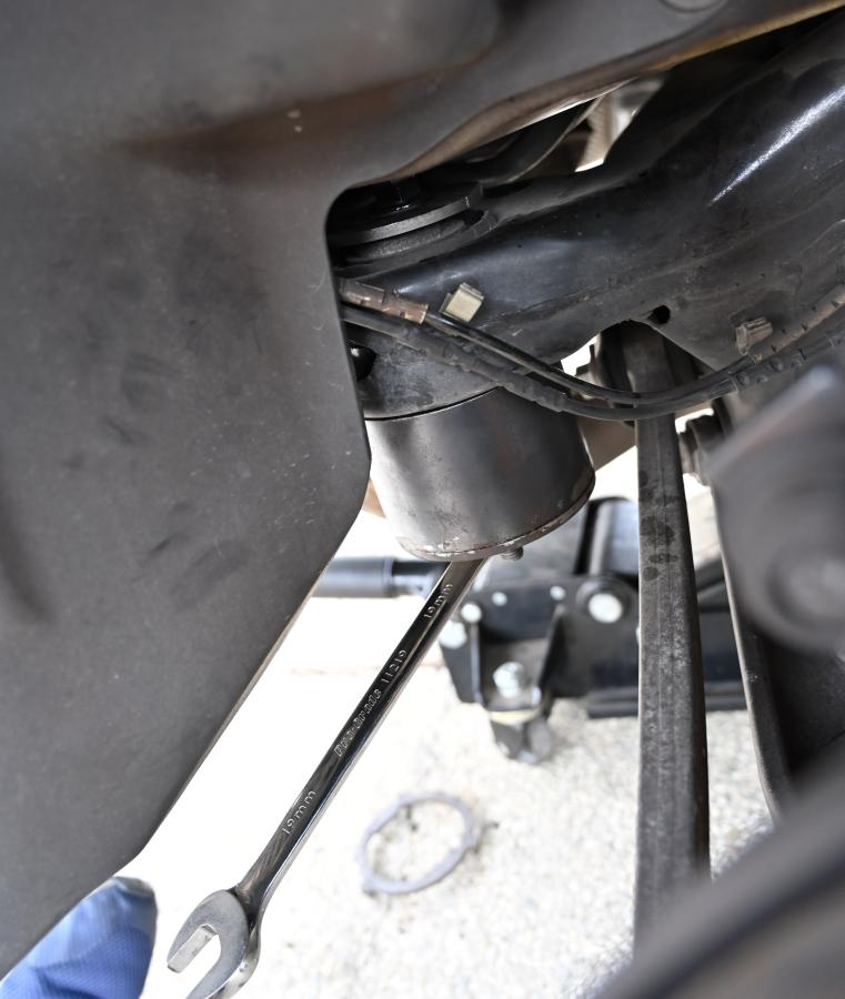

                        The rears are easy, you barely have to lower the subframe (no need to disconnect brakes/ebrake cable)
                        Click image for larger version  Name:	E90subbush (16).jpg Views:	0 Size:	54.0 KB ID:	316945
                        With about 70k, they look great and feel pretty good overall but, under torque like 1 to 2 or 2 to 3, they squirm bad, and are harsh especially with DCT!
                        Click image for larger version  Name:	E90subbush (15).jpg Views:	0 Size:	80.5 KB ID:	316944

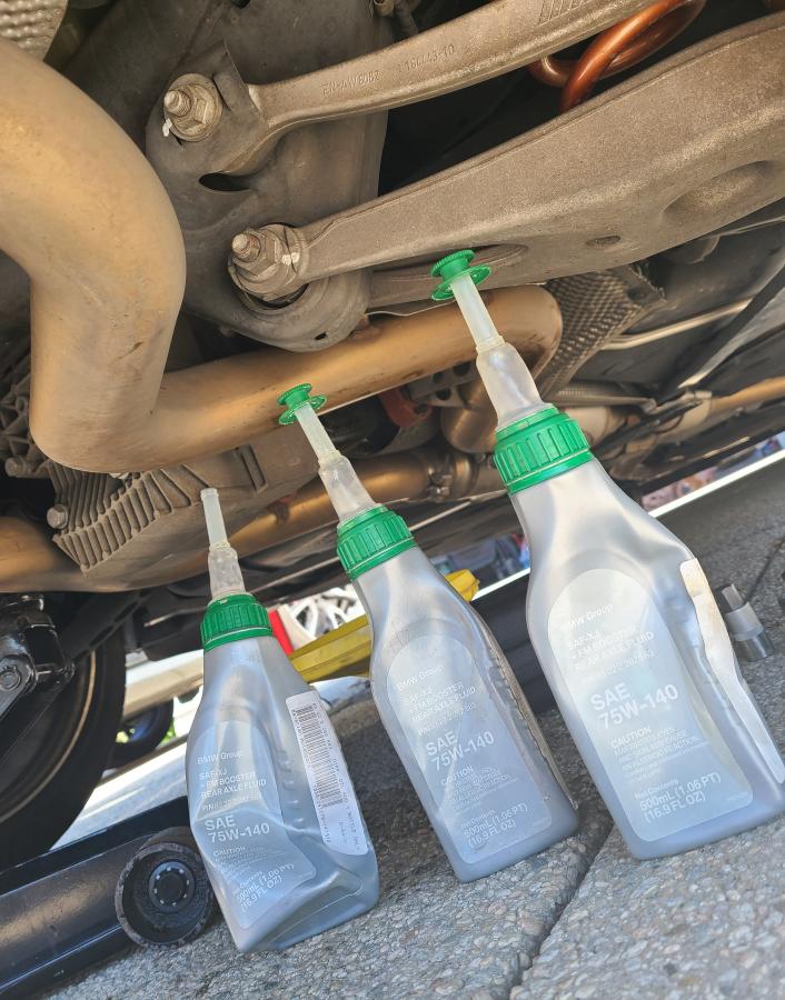

                        I also refilled the diff with OE juice (about 65k, normal interval)

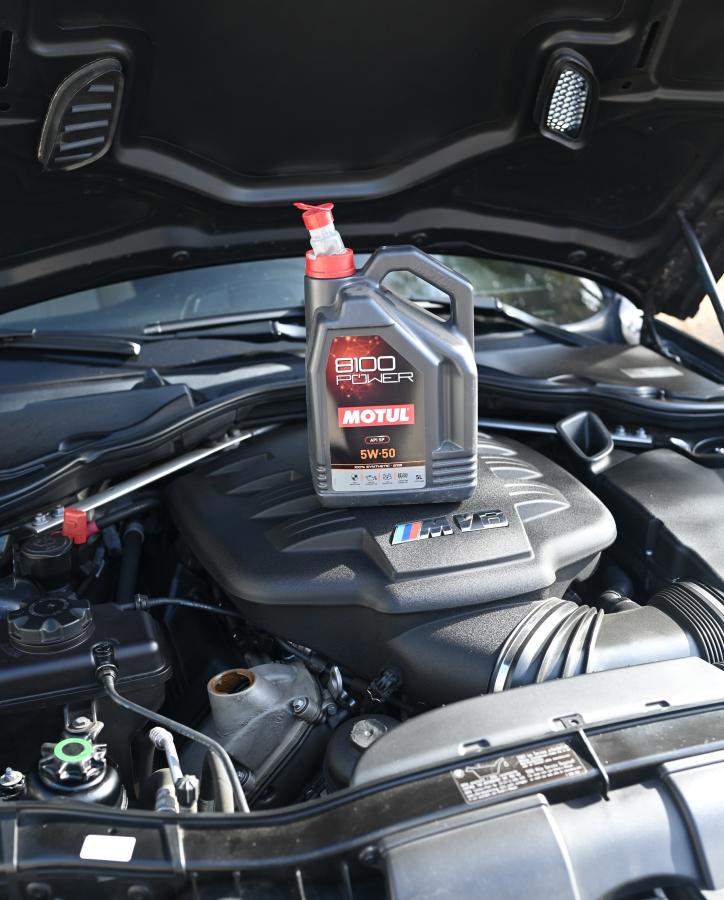

                        Forgot to document the annual (7k) oil change done in late February switching from Castrol to Motul power ester 5w50
                        Click image for larger version  Name:	E90oil25 (4).jpg Views:	0 Size:	85.6 KB ID:	316948

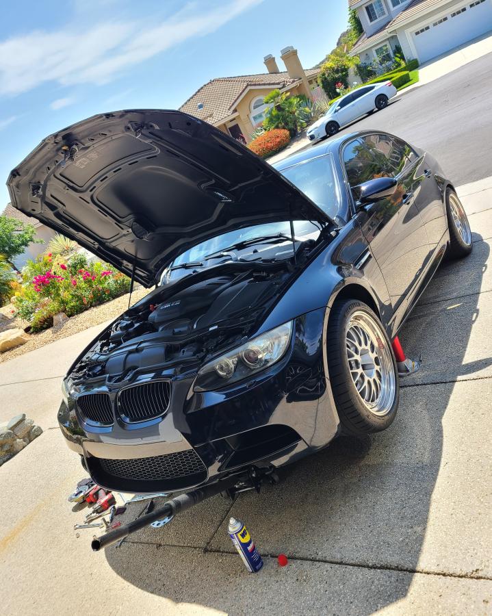

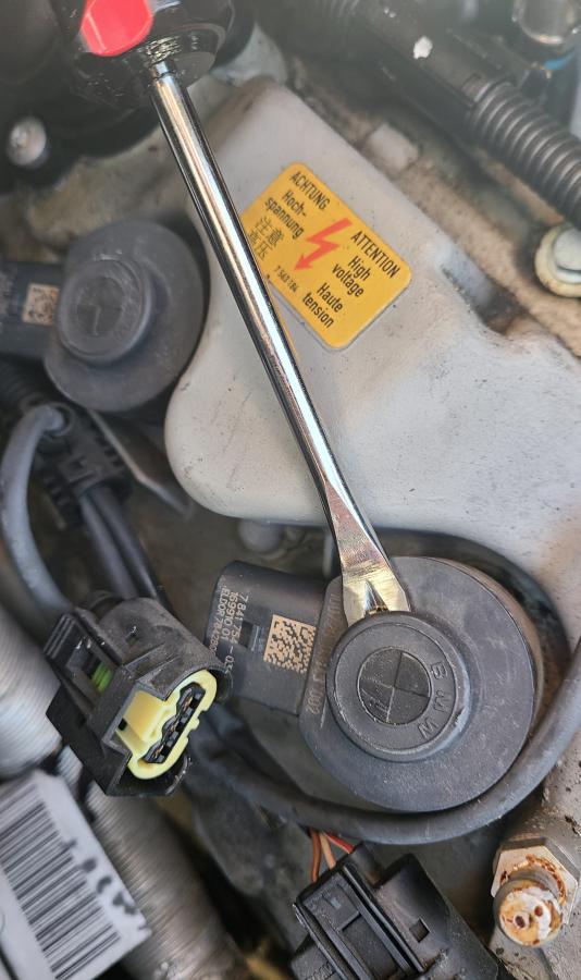

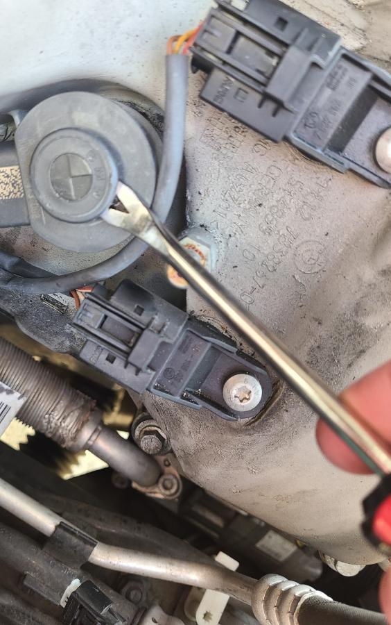

                        And while doing that, partly due to mileage (37k interval suggested, now I'm at 74k) and partly in preperation for test pipes and engine tune, I replaced the spark plugs. OE NGK.

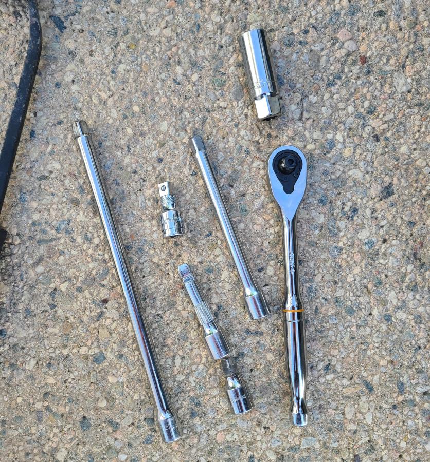

                        The coil packs are a bit different, and getting them off is a bit harder than on S54. I found good fulcrums for each one, and used this pry tool to get them off quite easily.
                        Click image for larger version  Name:	20250222_154912.jpg Views:	0 Size:	68.9 KB ID:	316949 Click image for larger version  Name:	20250222_154905.jpg Views:	0 Size:	81.2 KB ID:	316950
                        The V8 is a bit tighter of a fit in an engine bay than S54. The rear cyl needed an exotic mix of adapters to get to. 2 wobbles and various extensions:
                        Click image for larger version  Name:	20250222_160742.jpg Views:	0 Size:	236.7 KB ID:	316951

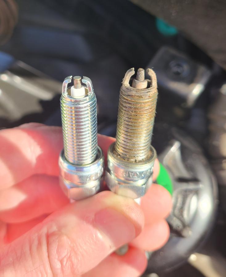

                        The plugs all looked great, not too dry and white (lean), not too dark and wet (rich), and I'm at the recommended replacement (37k iirc).
                        Click image for larger version  Name:	20250222_155313.jpg Views:	0 Size:	58.1 KB ID:	316952

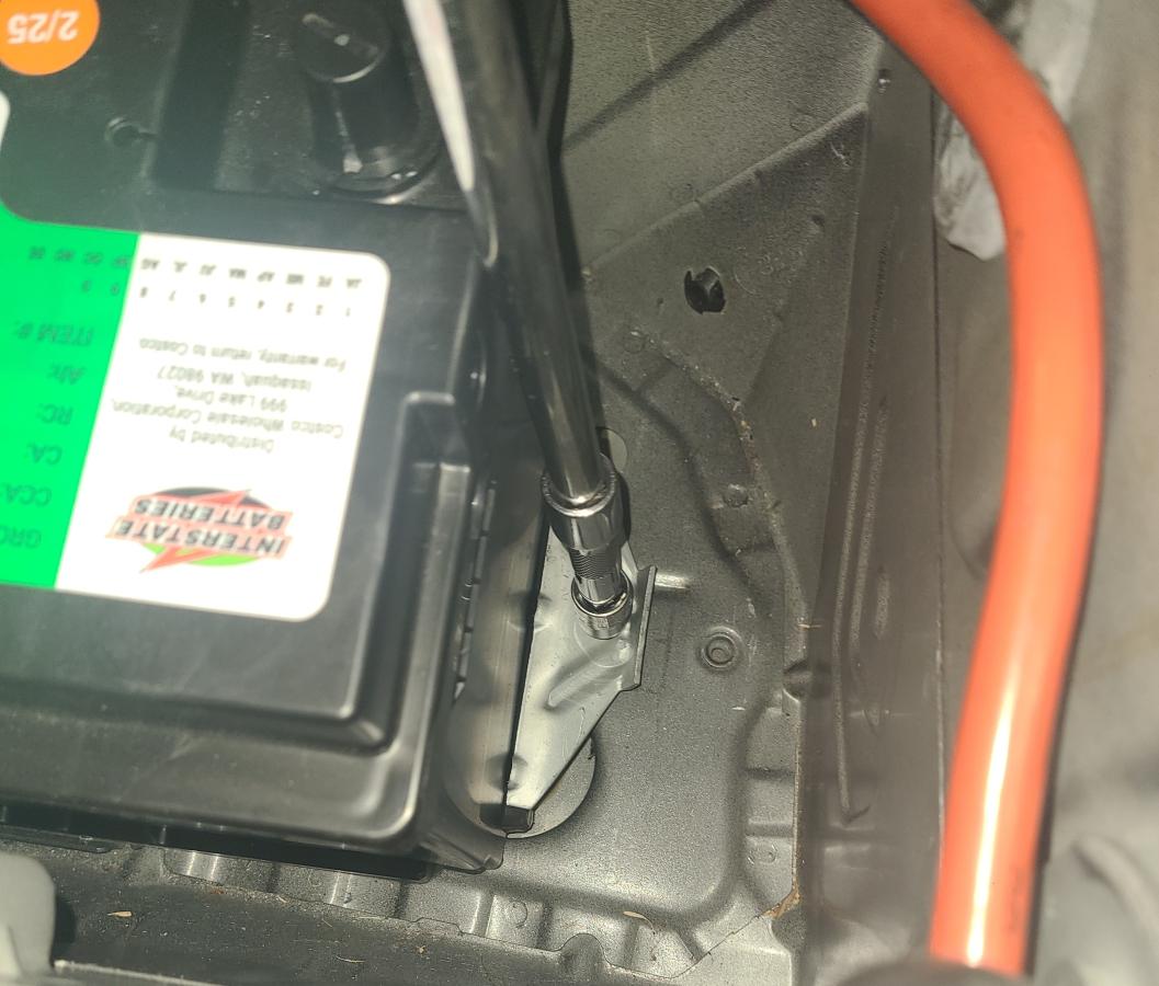

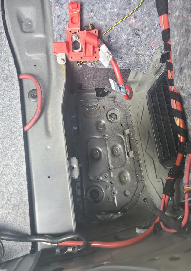

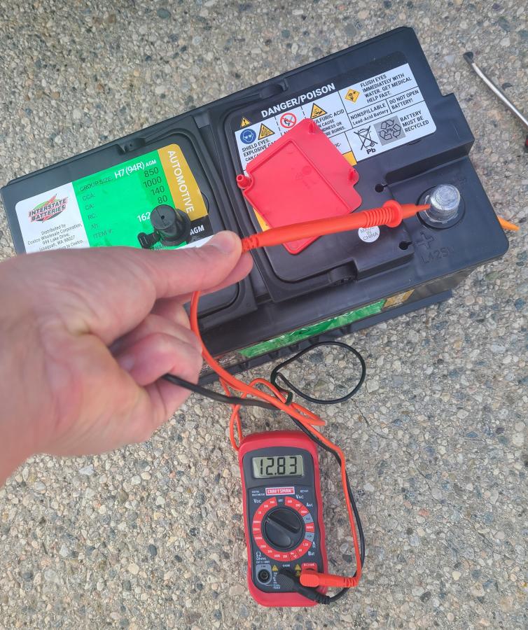

                        My battery was starting to dip below 12v, even getting down to like 5v, and while a charge would bring it back up over 12v, I decided to simply replace the battery right away, which also allowed me to go to a lighter/smaller spec. I still need good power as the car is fairly modern, and I have a sound system, but the H8 was really big and heavy. I got an H7 AGM through Costco for a great price ($169.99).
                        12.83v off the bat, nice!
                        Click image for larger version  Name:	20250322_142203.jpg Views:	0 Size:	148.3 KB ID:	316955

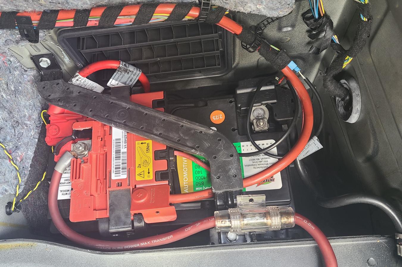

                        Gave me a change to clean up the tray, as well as change the mounting configuration to fit the smaller battery
                        Click image for larger version  Name:	20250322_144238.jpg Views:	0 Size:	89.6 KB ID:	316954
                        You just move this clamp up one hole:
                        Click image for larger version  Name:	20250322_144818.jpg Views:	0 Size:	97.1 KB ID:	316953
                        Click image for larger version  Name:	20250322_150150.jpg Views:	4 Size:	236.8 KB ID:	316957

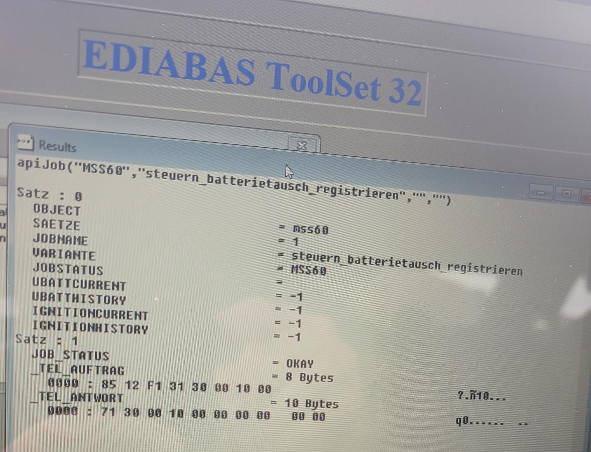

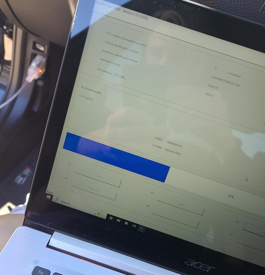

                        All done, I saved like 10lbs lol You also have to register the battery on this era plus, possibly, code the CAS module with the specifics if you make changes like I did, going from 90Ah to 80Ah or if you go from AGM to lead acid.
                        Then you can register (the mileage) with ediabas Tool32:
                        Click image for larger version  Name:	20250322_152420.jpg Views:	0 Size:	145.3 KB ID:	316958

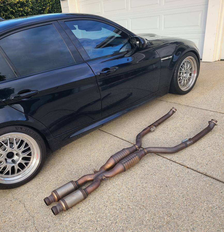

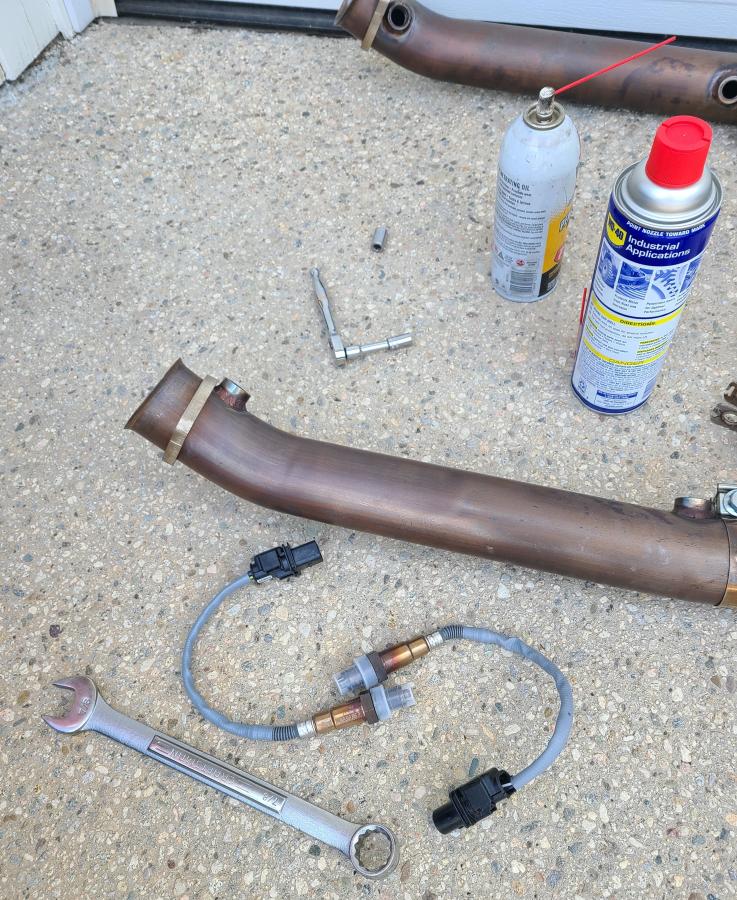

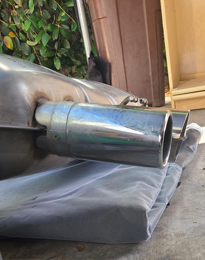

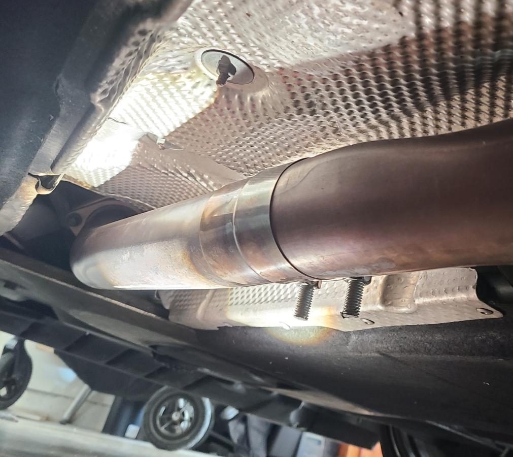

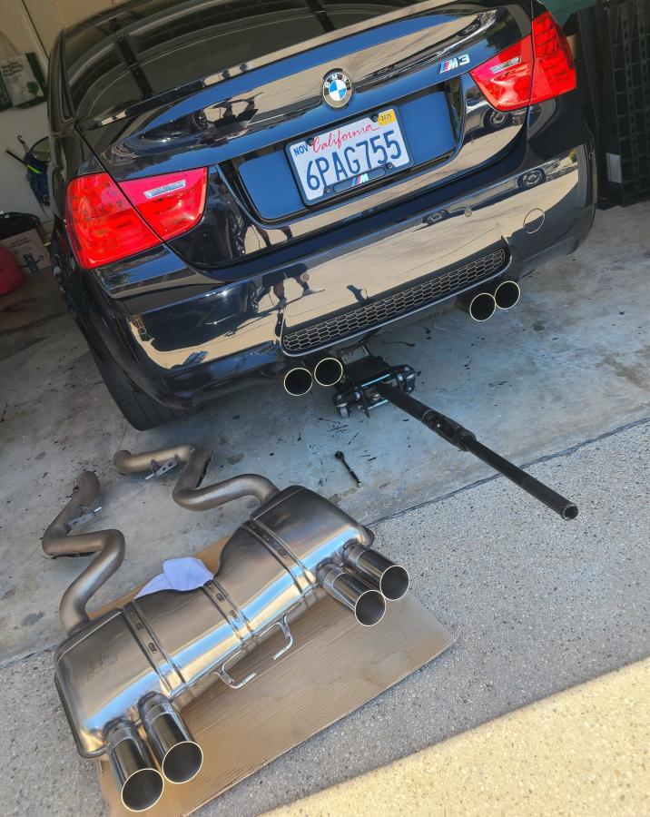

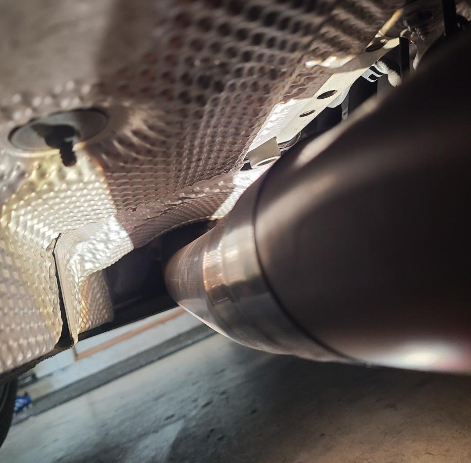

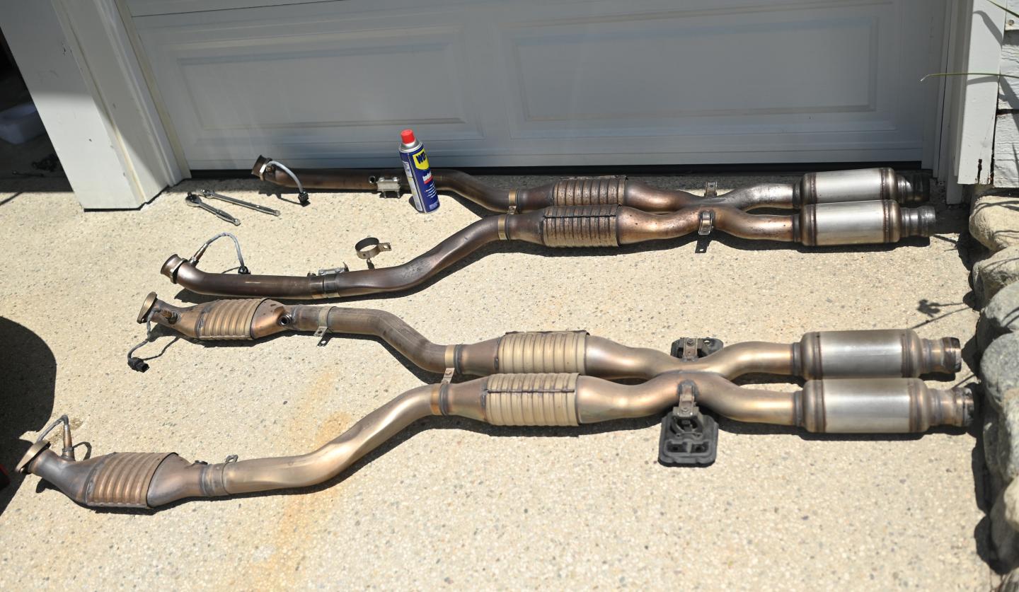

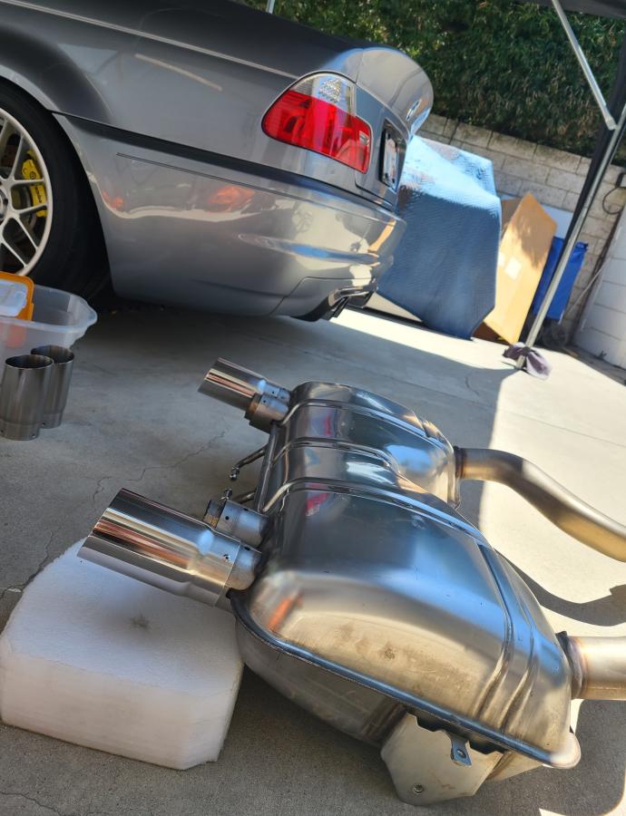

                        Now for some more "fun" stuff, AWE46M3 helped me snag a local stock X pipe with low miles that already had TMS test pipes installed, plus included to original cats (which I've since sold for almost what I paid for this entire setup lol).
                        Click image for larger version  Name:	20250207_161005.jpg Views:	0 Size:	170.0 KB ID:	316959
                        I took the opportunity to replace the pre-cat widebands ahead of time. I'll leave the originals on the original X-pipe as I'll likely have to swap it out every 2 years for SMAWG
                        Click image for larger version  Name:	20250621_124623.jpg Views:	0 Size:	162.5 KB ID:	316960

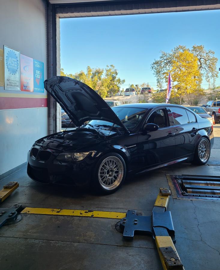

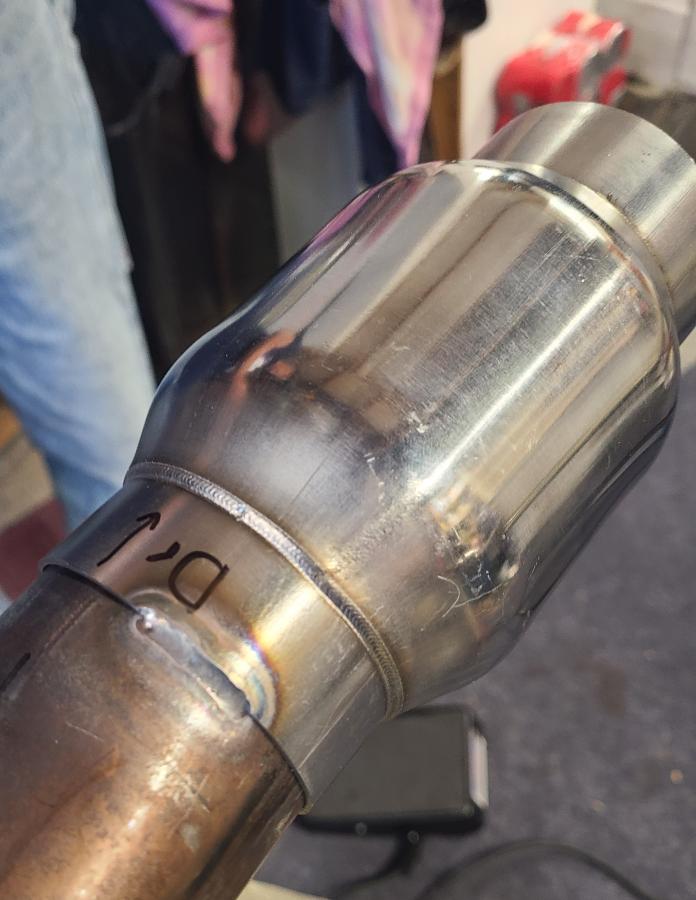

                            So last post, I had installed test pipes, paired with my 4 pipe muffler, and then tuned with Hassan @ HTEtuning. I really love the extra HP/TQ - very similar to S54 where catless headers + tune = about 40hp. Cost me ~$600 easily the best bang for buck on this car. Even cheaper than S54 as you don't need headers, just the downpipes. And the stock X pipe has secondaries, so no worry about emissions smells.
                            However, by deleting the massive primary cats, the exhaust note is cacophonous mix of rasp and a "droney" type of note that's awful right around 4k. This is with the 4 pipe muffler, mind. I put the stock muffler on and it's basically back to stock levels.
                            I had to remove the X pipe anyway, with my bi-annual smog test coming. I started to think about what I could do to "fix" the exhaust note, since now would be the time to make changes, with the piece being off the car temporarily. Bought new rubber hangers as the X pipe with test pipes was just touching the reinforcement plate.

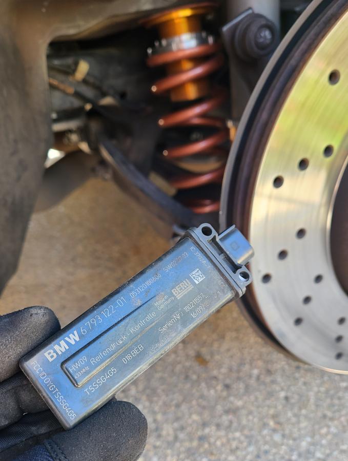

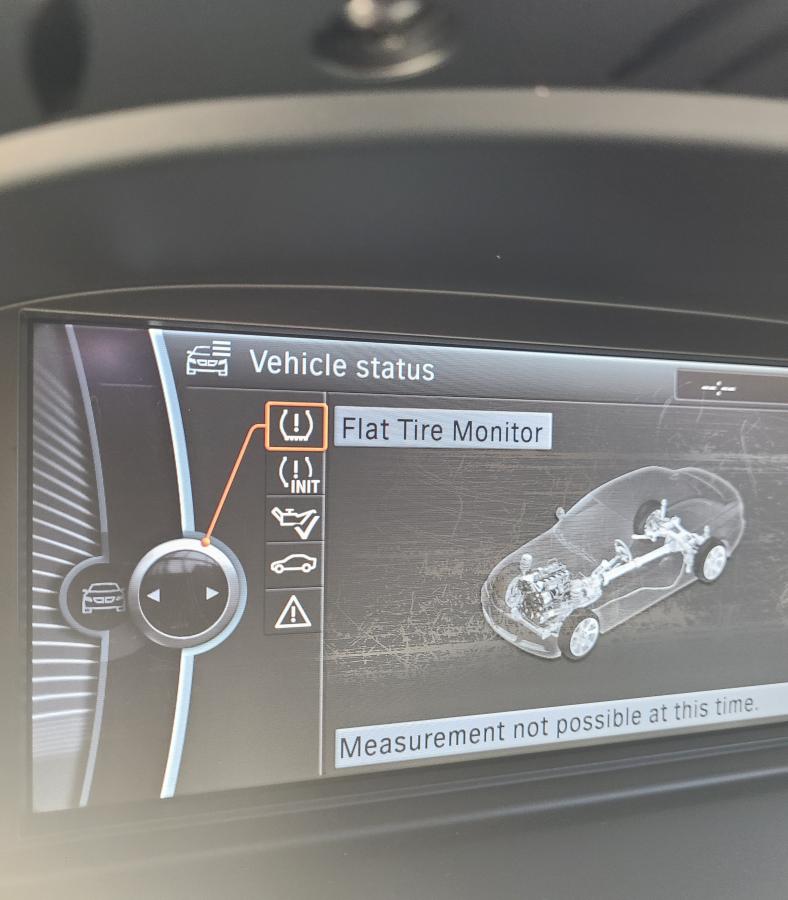

                            When I swapped over to the E88s, I lost the TPMS in the AG M359s. I don't really care for TPMS, and prefer lighter/simpler setups almost always, so I deleted the TPMS module, and coded the car to go back to E46 era flat tire monitoring.

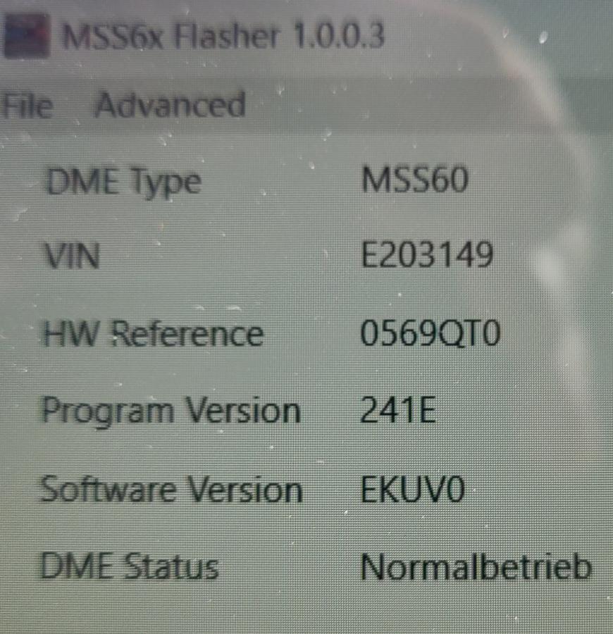

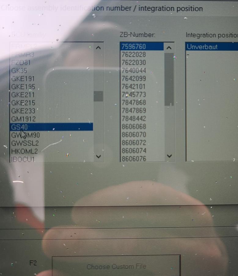

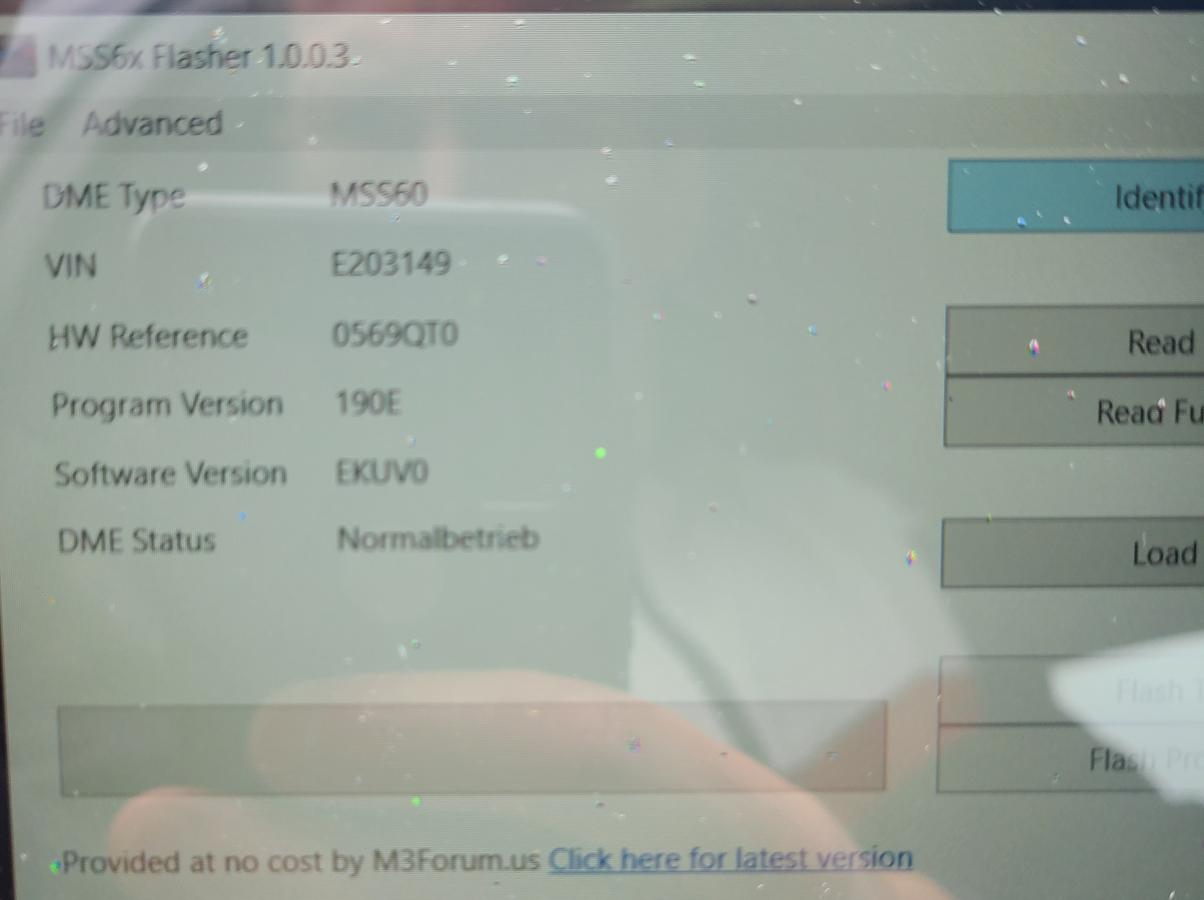

                            Before tuning with Hassan, I wanted to check was software I was on as many on M3post were saying that the last software 241E was a performance imporvement over the original factory softwares. I wanted to practice my coding/flashing skills anyway.
                            So I was on 190E (2011.5 model)

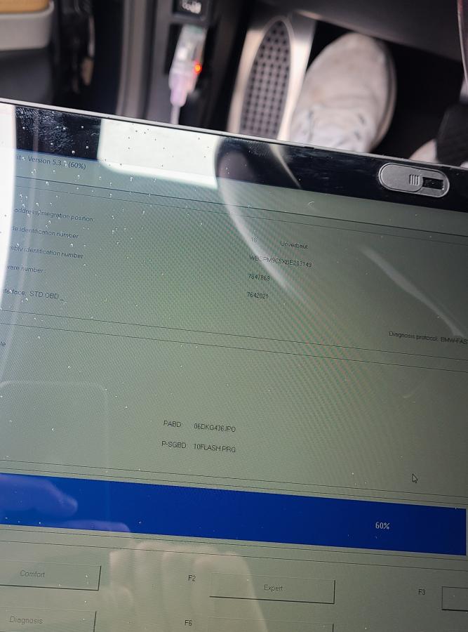

                            Now, 241E (used Winkfp)
                            Within that same Daten file, are updated DCT files as well. Updated U.S. and European plus GTS and CRT. Almost everyone talks about GTS, but there are some aspects I don't care for. I really liked stock u.s. just fine, other then how slowly it would get back into 1st after reversing. The updated U.S. file (7847869) made improvements on that and jerkiness. I'm really happy with it. I prefer it to European as euro starts in D(2) iirc, and I prefer manual 1 with DCT speed at 3. My MDM settings have DCT speed up to 4 so that I get the auto-blipping.

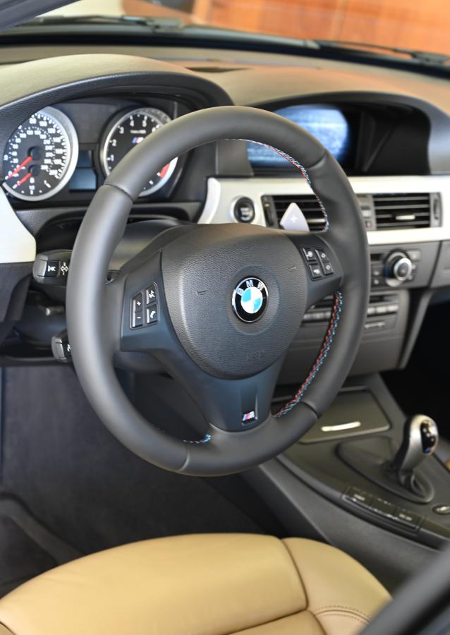

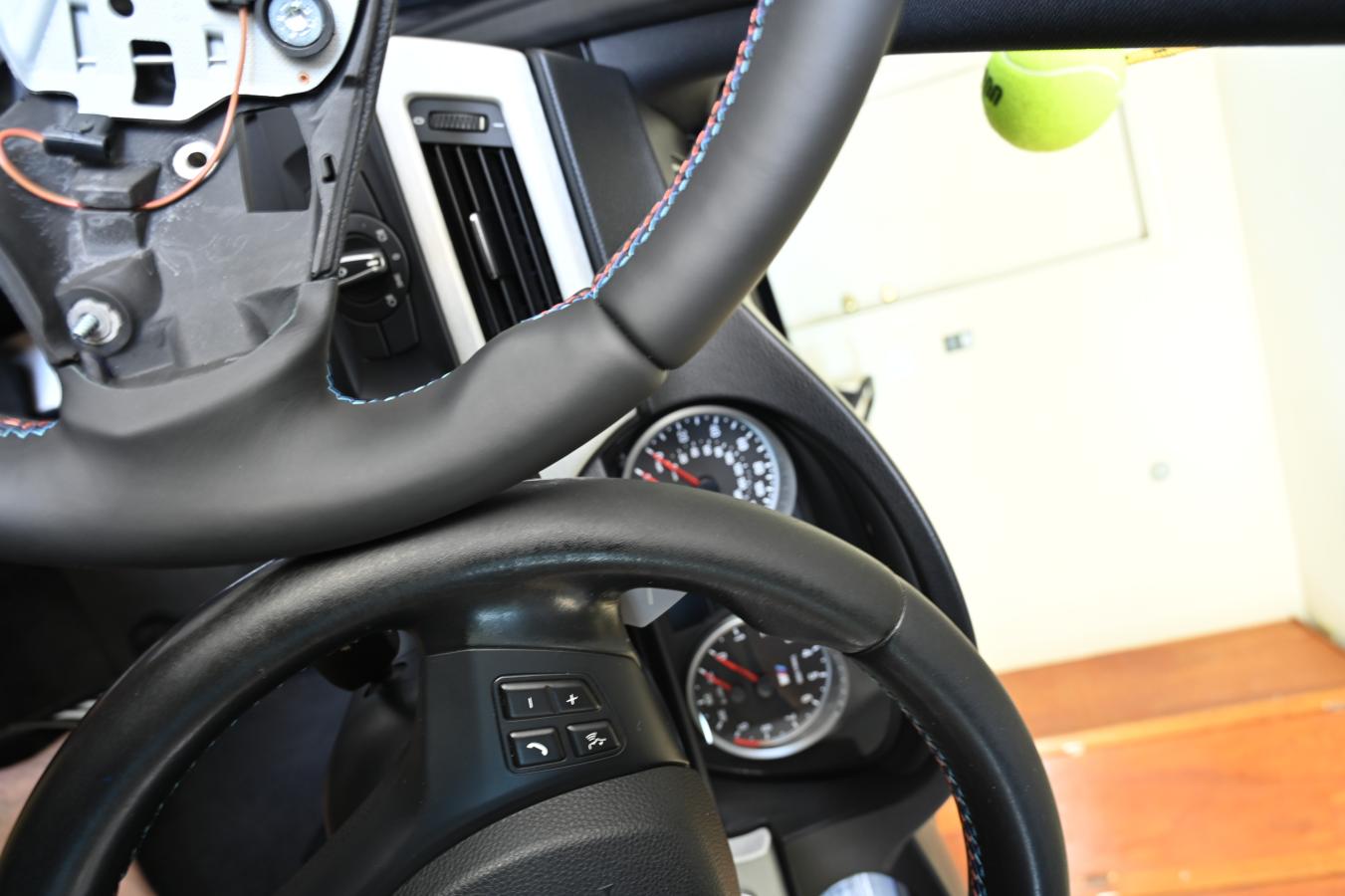

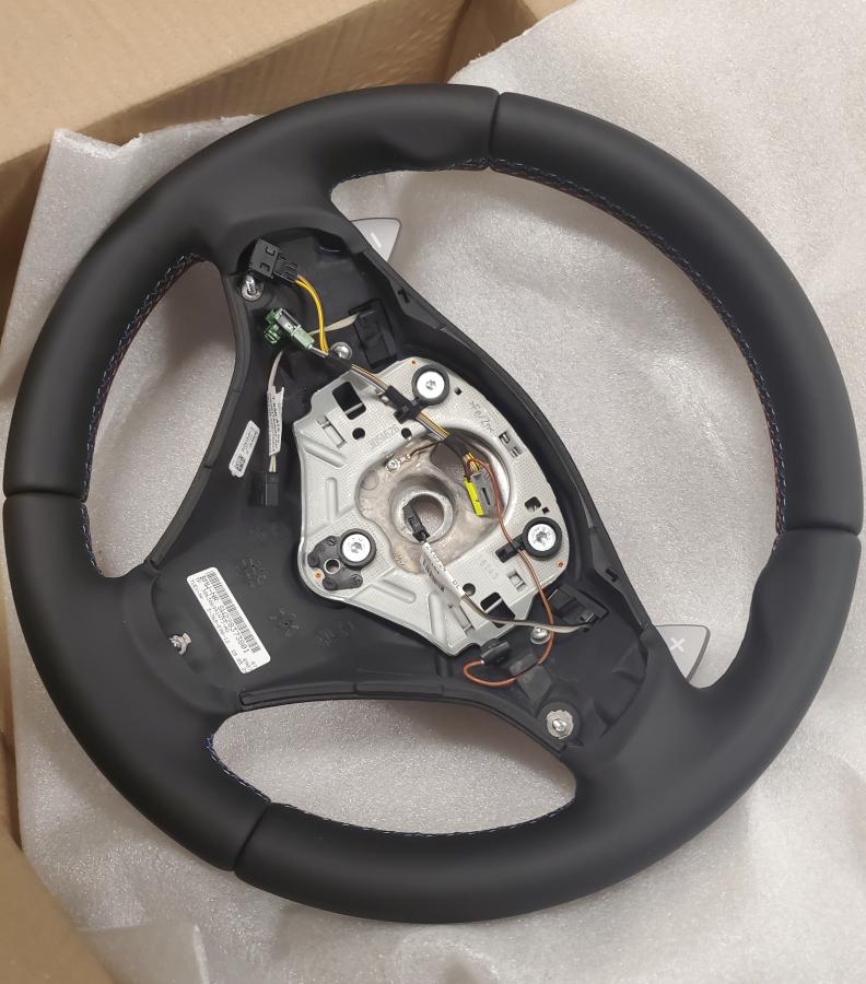

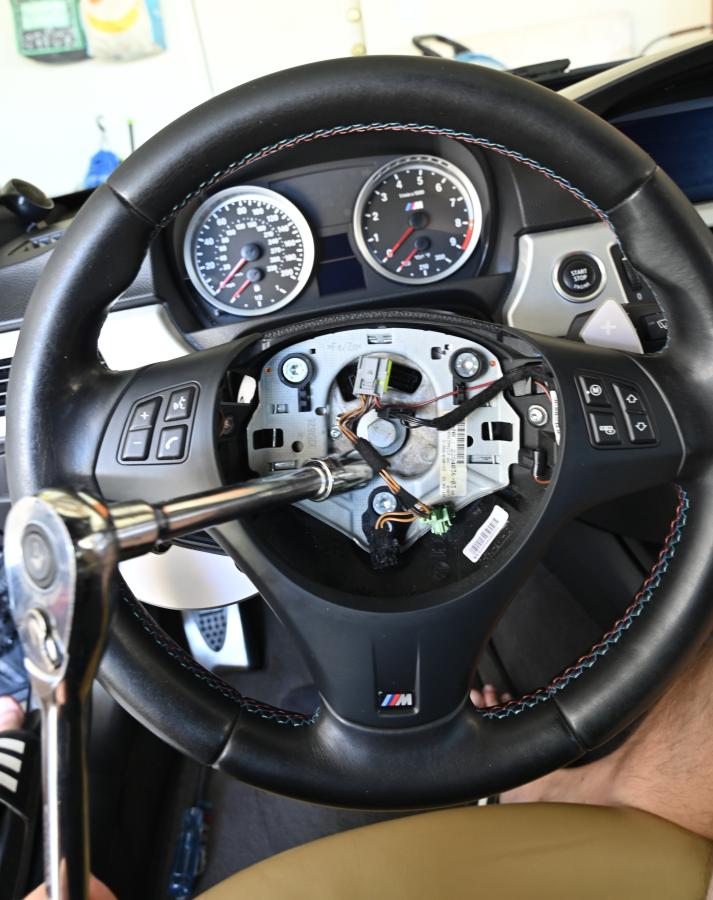

                            I had ordered a steering wheel at the end of 2023 for a pretty good price at the time, about $780 from a dealership (no tax, free shipping), but then got a notice that they couldn't get it, and they were backordered. I decided to let them keep the payment and wait till BMW made more knowing that this was a fairly common thing now, and didn't want to wait anyway just to have to pay considerably more.
                            Turned out to be a good move. They came back about 5-6 months later, and the price went over $1000! Crazy. Well, my luck didn't stop there
                            I open it up to revel in the fresh matte goodness and I notice some DCT paddles attached hmmm. I was pretty sure they're a seperate part. They are, and they're like $1000.
                            So I got quite a deal
                            I'll reuse my original paddles and hold on to these new ones should mine stop working. Used ones go for about $300 on ebay.

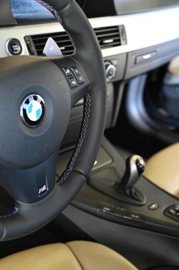

                            My 75k wheel didn't seem too bad, but once you compare to new, it becomes obvious
                            Removal/install is exactly the same as an E46 wheel, probably the same as all BMW wheels

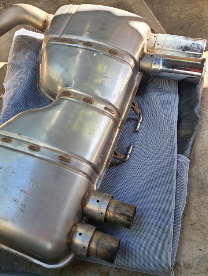

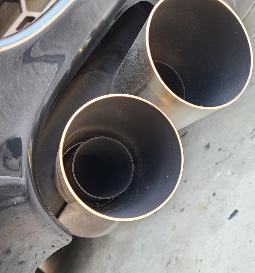

                              As I had mentioned, with the test pipes now fitted, my "4 pipe" muffler was just too loud and the rasp too gnarly, which I had anticipated, so I pivoted to my next plan of action: modify my original muffler lightly, something like a 1 to 2 pipe mod.
                              Here's a little compilation of the 4 pipe muffler with the test pipes. It sounds glorious on video, but IRL, it's too loud and too raspy. Even if you liked it loud loud, it's a nasty rasp (not quite caught on video). And I think this is pre-tune as the cold start is still there.

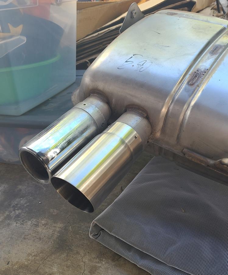

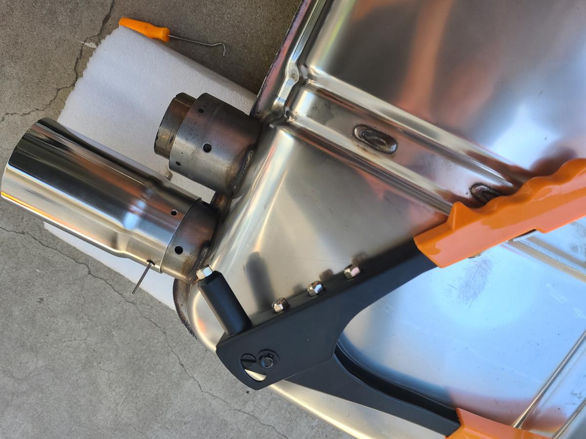

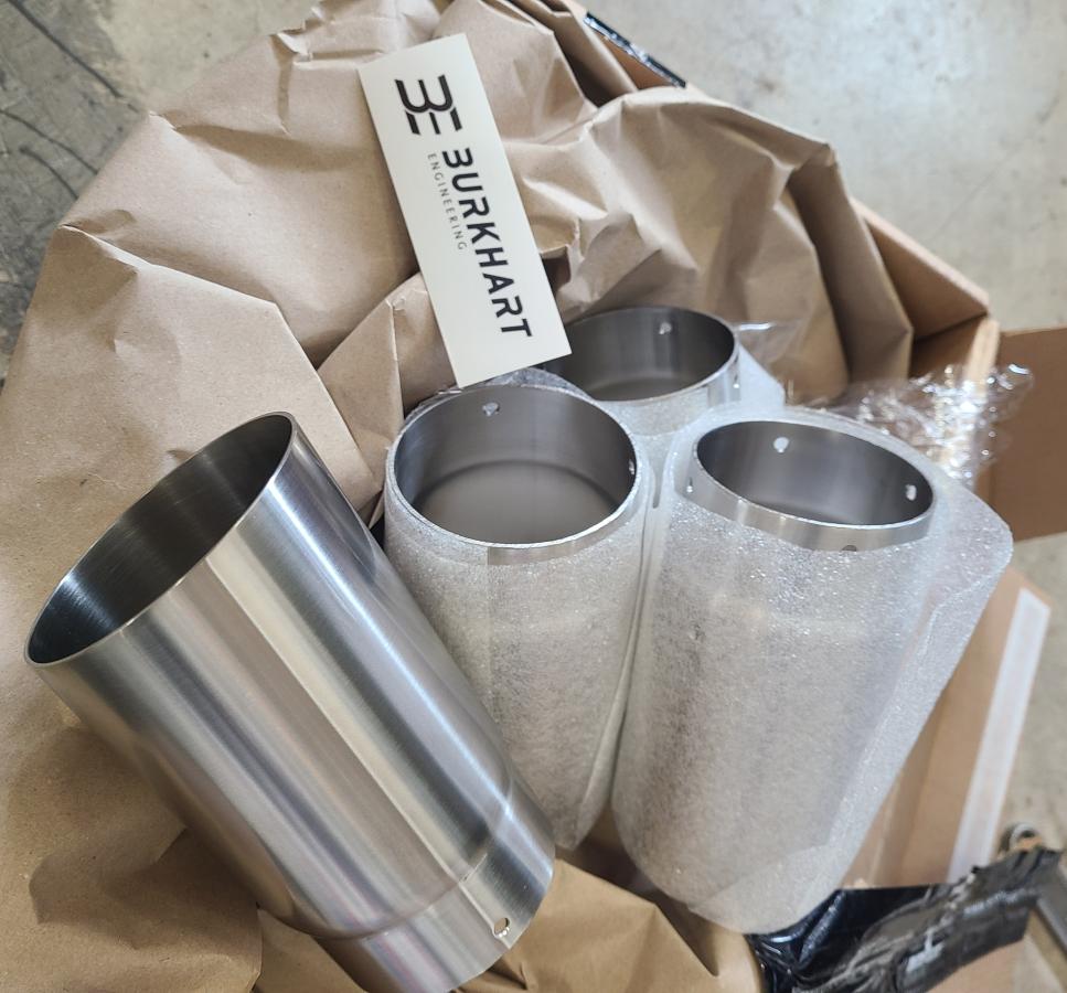

                              But before doing so, gotta get rid of the awful tips. I went back to Burkhart Engineering in Germany again, but chose the slashed cut tips this time. (80mm & e90 length)
                              Click image for larger version  Name:	20250331_135052.jpg Views:	0 Size:	96.5 KB ID:	353843

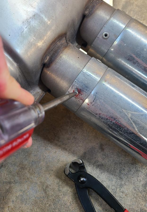

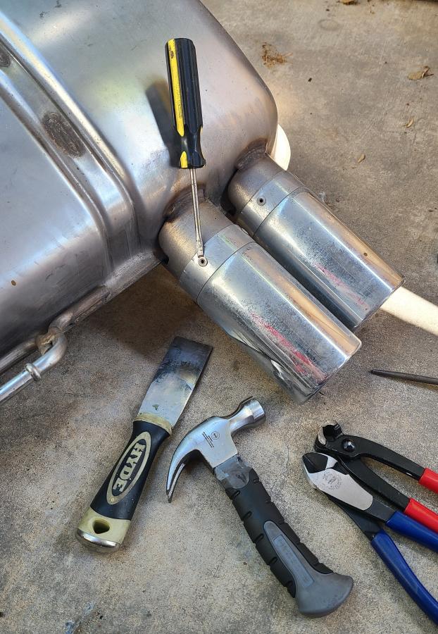

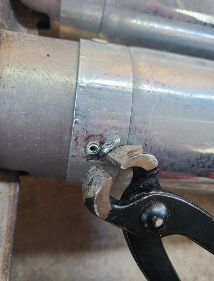

                              The rivets are hardened steel, and drilling them out took too long, so this is my fastest method should you wish to replace stock tips on a stock e46/e9x muffler:
                              Click image for larger version  Name:	20250520_151654.jpg Views:	0 Size:	120.1 KB ID:	353845
                              lift it up a little on opposing sides
                              Click image for larger version  Name:	20250520_152048.jpg Views:	0 Size:	66.9 KB ID:	353844
                              Nip off the "disc"
                              Click image for larger version  Name:	20250520_152109.jpg Views:	0 Size:	90.1 KB ID:	353848
                              Then punch the inner portion down and out
                              Click image for larger version  Name:	20250520_163501.jpg Views:	0 Size:	100.1 KB ID:	353846
                              Click image for larger version  Name:	20250521_165503.jpg Views:	0 Size:	114.4 KB ID:	353847
                              Much much better
                              You can see the slant here:
                              Click image for larger version  Name:	20250521_165518.jpg Views:	0 Size:	121.6 KB ID:	353850
                              I didn't like how visible the stock muffler's outlet pipes were on my 4 pipe muffler, so this time, I remembered to slice the outlets off enough so they're not really visible when it's all said and done.
                              Click image for larger version  Name:	20250704_135353.jpg Views:	0 Size:	76.2 KB ID:	353849
                              Click image for larger version  Name:	20250704_140149.jpg Views:	0 Size:	89.2 KB ID:	353851

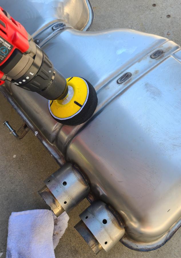

                              Also did a quick polish, mostly to clean it up and make it look new(ish), wasn't going for a true mirror-like polished finish
                              Click image for larger version  Name:	20250706_130415.jpg Views:	0 Size:	69.9 KB ID:	353853
                              Click image for larger version  Name:	20250706_130817.jpg Views:	0 Size:	73.4 KB ID:	353854

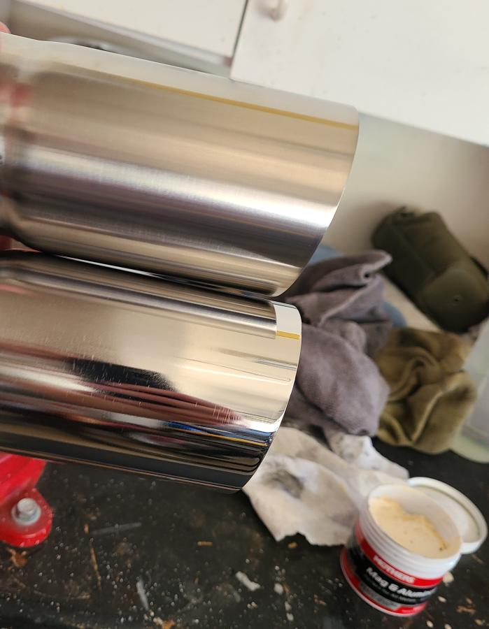

                              I also don't love the brushed finish of Burkhart's tips, so I high-polished them:
                              Click image for larger version  Name:	20250705_140932.jpg Views:	0 Size:	62.0 KB ID:	353852
                              Ready to fit (Burkhart includes correct rivets)
                              Click image for larger version  Name:	20250706_133242.jpg Views:	0 Size:	121.3 KB ID:	353855
                              My goal was to replicate what I did to my E46's stock muffler, i.e., clean it up & add single wall, slashed cut tips 80-83mm size
                              Click image for larger version  Name:	20250706_133516.jpg Views:	0 Size:	84.8 KB ID:	353856

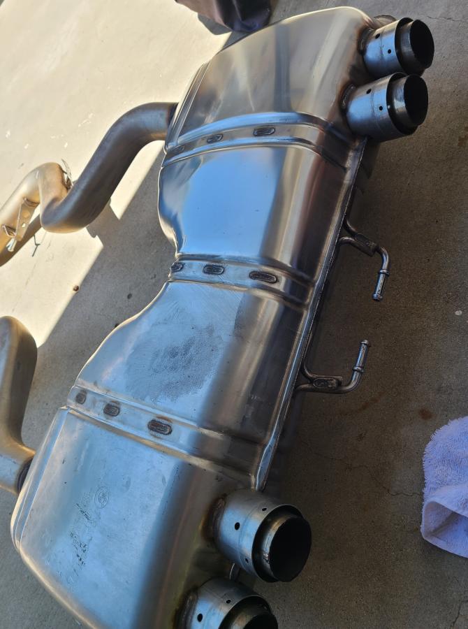

                              So it's just the stock muffler with tips at this point, not modified internals yet.
                              Click image for larger version  Name:	20250709_134329.jpg Views:	0 Size:	120.7 KB ID:	353857
                              Click image for larger version  Name:	20250709_153614.jpg Views:	0 Size:	125.8 KB ID:	353859
                              Click image for larger version  Name:	20250709_153635.jpg Views:	0 Size:	135.0 KB ID:	353858

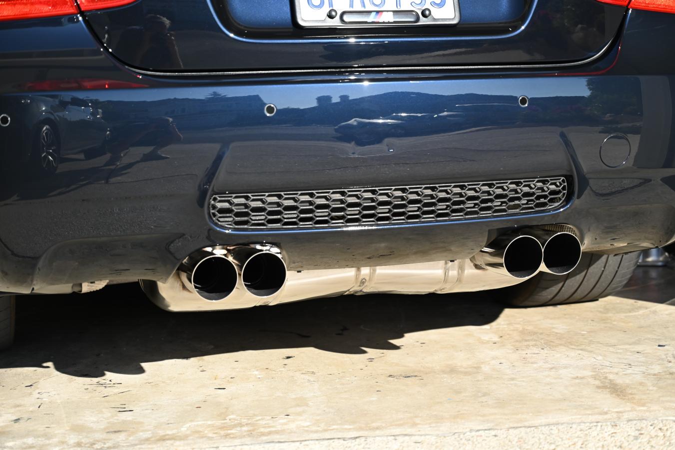

                              Click image for larger version  Name:	E90muffler1pipe (14).jpg Views:	3 Size:	137.3 KB ID:	353864

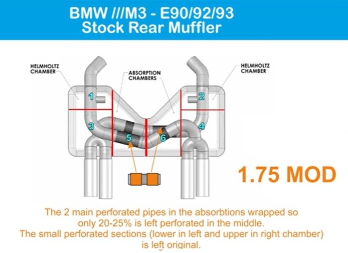

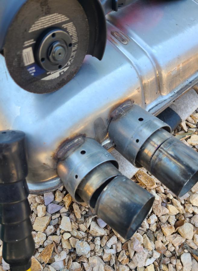

                                I decided I'd start with a "2 pipe" job, using an exhaust pipe repair kit - fiberglass wrap. That way, if 2 pipe is too loud, I can peel back the wrap until I reach my desired amount of coverage.
                                Here's a nice diagram I found that shows a partial cover-up of the 2 main perforated pipes (the ones fully covered in a "2 pipe" mod job)

                                The big primary cats really temper the note down, so much so that even a muffler delete doesn't sound too crazy. But as soon as you lose those big cats, it gets very loud and raspy. I wasn't too interested in buying an aftermarket X pipe, didn't see any real benefit, stock is already 2.5" and has nice secondary cats in there which I want for smell control. So I started thinking of how I could add a pair of resonators to the stock X pipe. I anticipated needing to be quad resonated if I was ging to be opening the muffler up more because getting more volume via muffler mod also introduces more rasp. Resonators seem to be the way to keep the volume up, but control the rasp.

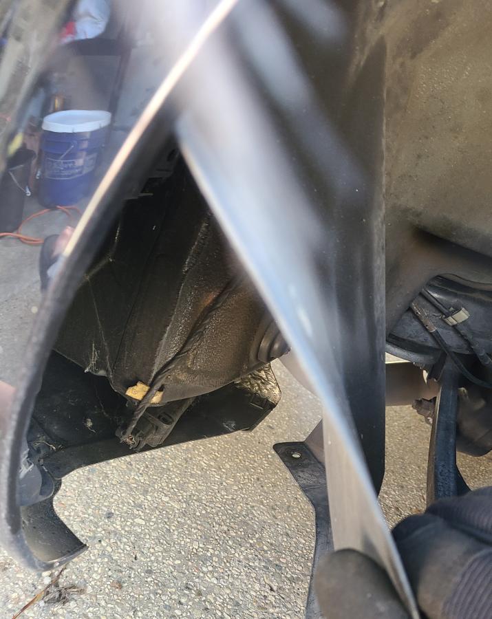

                                I got under the car and confirmed there's a ton of space where the primary cats would be. Though, there's not a lot of ground clearance. Interesting note * BMW's resonators and cats are offset, with more of their body going upwards into the vehicle to create more ground clearance.
                                Click image for larger version  Name:	20250928_160701.jpg Views:	0 Size:	109.6 KB ID:	353874
                                Click image for larger version  Name:	20250928_160709.jpg Views:	0 Size:	75.2 KB ID:	353875
                                Ok, so I was confident I could fit resonators in there, but was mindful to keep the body diameter under 4" as the stock primary carts are about 3" thick at this point. Well, many res are 4" body, but not offset. And I couldn't find a spare pair of stock resonators to buy, so I kept looking. I eventually found some nice 3.5" diameter "bullet" resonators from Total Flow that I thought could work. It wouldn't result in less ground clearance, if I moved them forward just a bit where the pipes naturally go upward to meet the headers.
                                I'll get into the fab job in a later post, but here's a pic of them:
                                Click image for larger version  Name:	20251210_100710.jpg Views:	0 Size:	65.0 KB ID:	353876
                                The plan is to mock it up next to my stock X pipe, take measurements, and cut the test pipes down to accomodate the resonators, weld it all together while still maintaining the correct dimensions as stock. Without a jig, this was gonna be a bit tricky.
