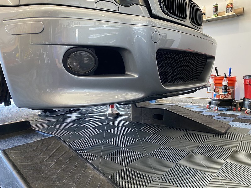

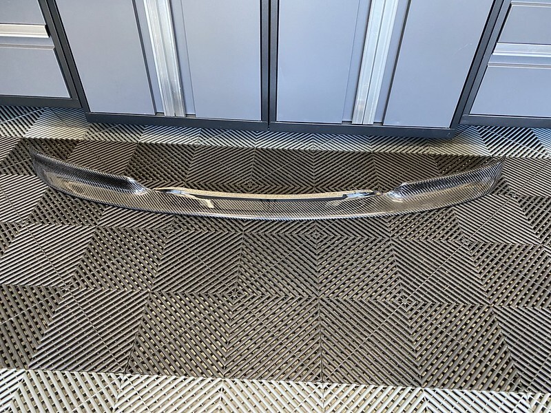

          Continued the Spring of Service by flushing the brake fluid and replacing with Pentosin Super DOT 4 fluid.
          Also removed the front lip to re-fit it better, as I was never 100% happy with how I installed it.

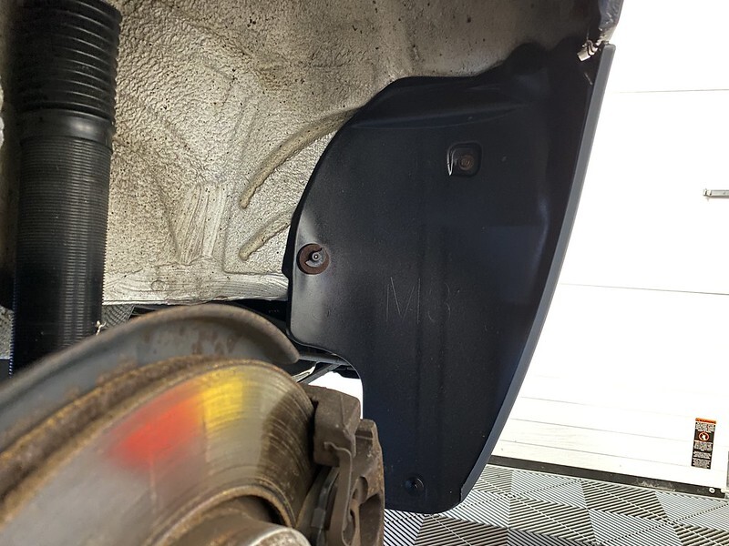

          While the wheels were off for the brake fluid flush, I took that opportunity to try and bring some life back to the fender liners. Horrible lighting led to some crap photo quality, but you get the idea.
          Before:
          After:
          I used Adam's Rubber & Tire Cleaner along with a tuff shine tire brush, followed up by Meguiar's M39 Mirror Glaze Heavy Duty Vinyl Cleaner and the tuff shine tire brush. Wiped off with clean microfiber towels, then applied Solution Finish, waited roughly 2 minutes to let it set, then wiped off with microfiber towels. Pretty happy with how they turned out.
