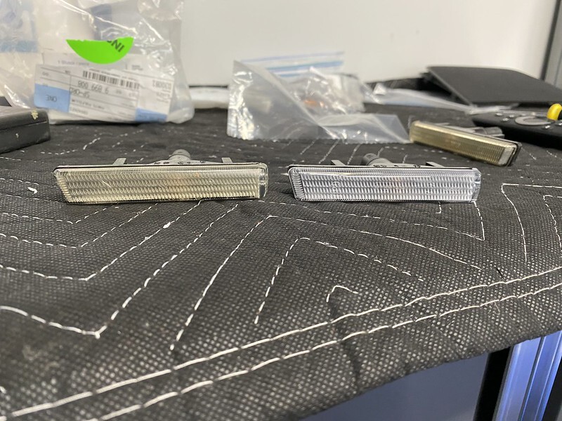

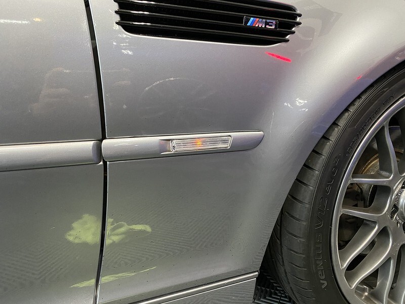

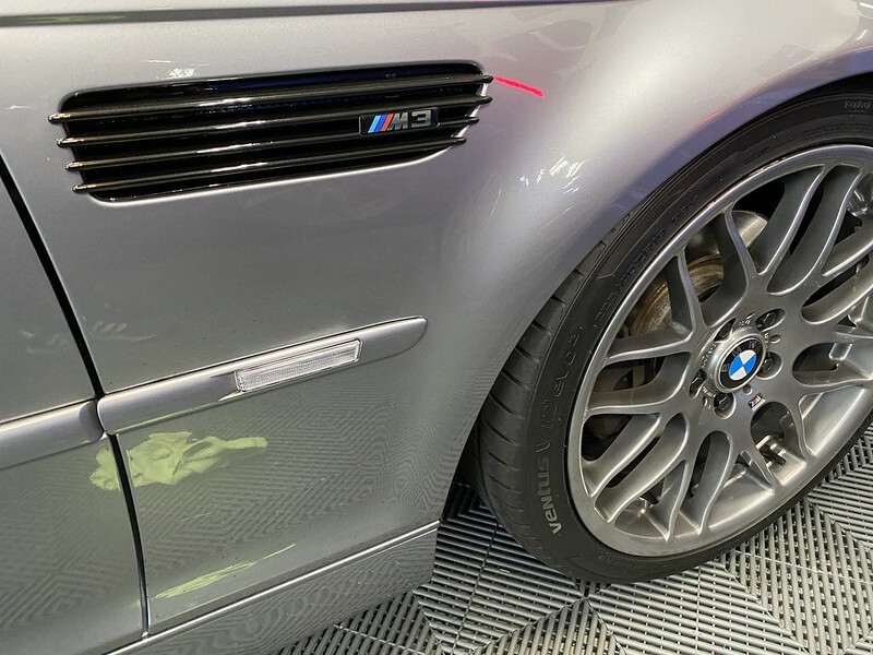

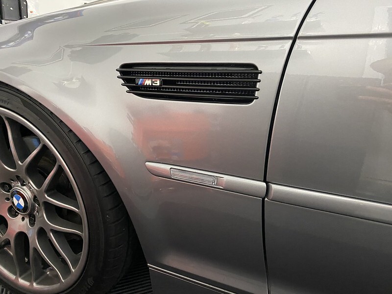

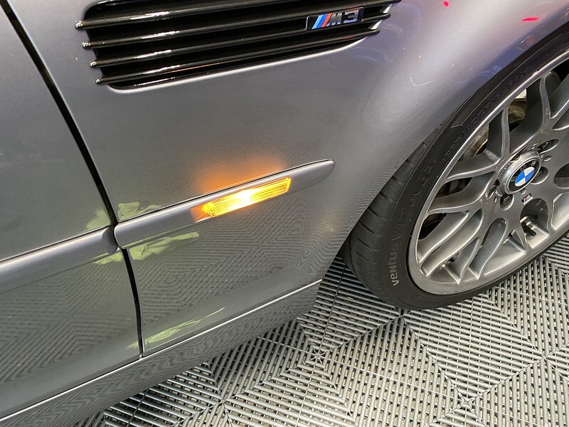

                            A few days back, I replaced my side markers with some new OEM bits. Crazy the difference these little guys make when they aren't old and faded. Little by little, slowly getting my car refreshed.
