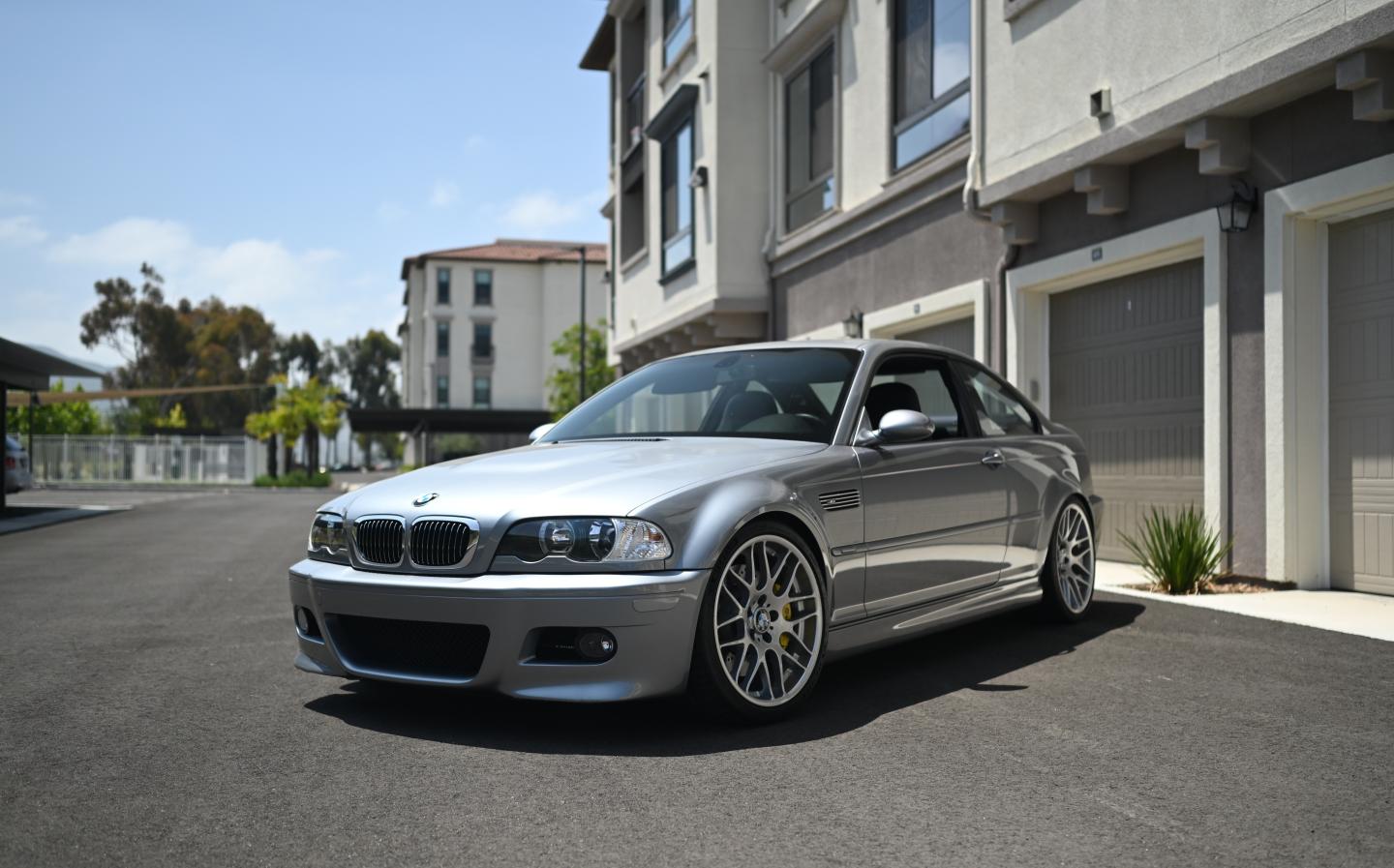

                    Polished the car (1 step) with Griot's Boss perfecting cream, then applied Gyeon Pure Evo coating. No pics from the job, just some pics soon after that, hopefully, show off the finish.
                    Click image for larger version  Name:	Postgyeonpure.jpg Views:	0 Size:	162.9 KB ID:	353172
                    Click image for larger version  Name:	e46gyeon25wash (23).jpg Views:	0 Size:	205.1 KB ID:	353173 Click image for larger version  Name:	E46GyeonPure (14).jpg Views:	0 Size:	144.9 KB ID:	353174
                    Click image for larger version  Name:	E46Mesa (2).jpg Views:	0 Size:	258.9 KB ID:	353175
                    Some videos below. They show off the gloss more than static pics:
                    https://www.youtube.com/shorts/4OrvmSfTgmQ
                    https://www.youtube.com/shorts/VcwflpMnqIo

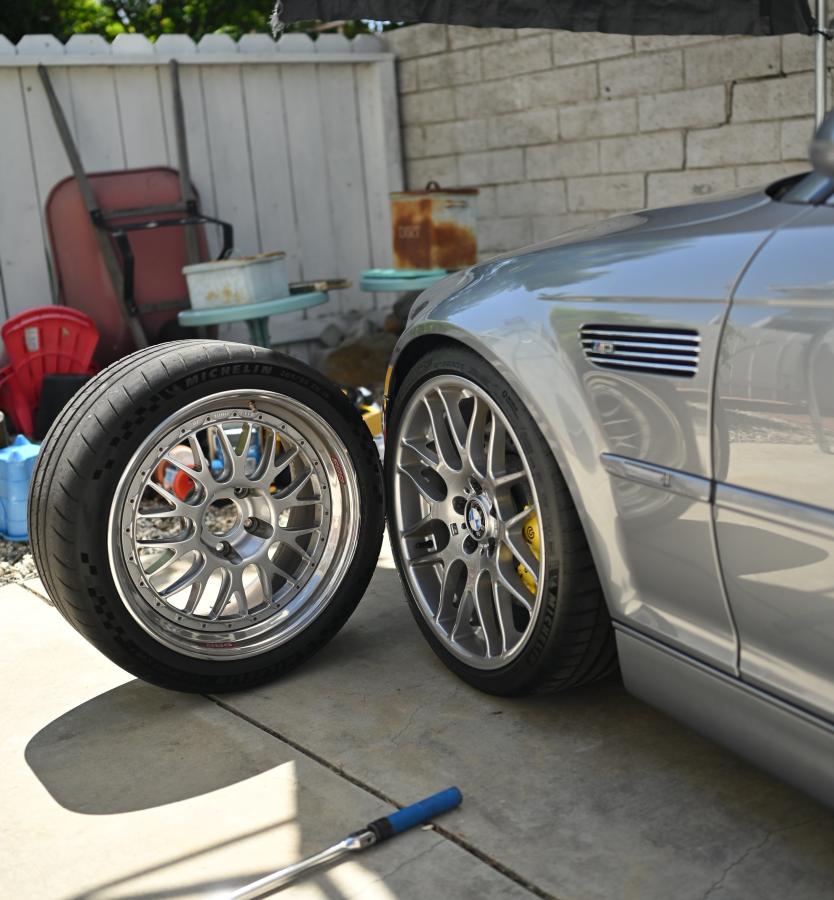

                          I started mounting the Cup2s in preperation for the swap, wanted to take this pic as a cool teaser:
                          Click image for larger version  Name:	E88.jpg Views:	0 Size:	95.4 KB ID:	353233

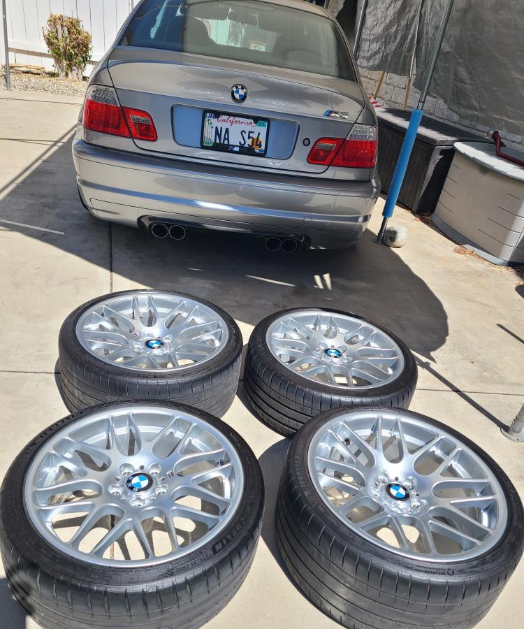

                          But who doesn't love OE CSL???
                          Click image for larger version  Name:	20260323_135543.jpg Views:	0 Size:	124.6 KB ID:	353237
                          Click image for larger version  Name:	20260323_135554.jpg Views:	0 Size:	95.5 KB ID:	353235
                          Click image for larger version  Name:	20260327_104634.jpg Views:	0 Size:	99.5 KB ID:	353236
                          In order to fit over the 996 calipers, you need a 10mm spacer minimum. I knew I wanted a a 12mm spacer for the E90's front 9"et31 ZCP wheel, so I bought a set now to use on the E46 that will get swapped over.
                          Click image for larger version  Name:	20260327_104645.jpg Views:	0 Size:	96.0 KB ID:	353234

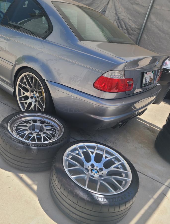

                                Alright, so I grabbed the ZCPs for my E90 last weekend, and since they had tires, I was able to install them on E90 quickly and then immediately move to the E46. I don't know what type of DIY alignment I might have to do to fit the E88s, but I'm assuming more neg camber up front and probably have to bring the toe in. Now since I knew for a fact that a michelin 275 rubbed badly on this car (Good_M3's if anyone remembers that chap), and he had to mod his fenders, I thought about a stretched tire. I'd rather not touch my fenders. And I think having a square set of tires would do the car good (versus a 265/275 split), so I decided to fit a pair of the 265 Cup2s on the 10.5" E88. I was fairy sure that would be enough stretch for the wheel to fit and not rub. Maybe kiss the inner fender, but still be fine. We'll see in the near future when I report back! For now, just some pics up until this point, and some parting shots of the car for its last time (I think) on OE CSLs!
                                My fav wheels and tires (3 diff Michelins - PSS, Cup2s & PS4s)
                                Click image for larger version  Name:	E46.jpg Views:	0 Size:	85.5 KB ID:	358972
                                Japan vs Germany. Man, Cup2s are FAT
                                Click image for larger version  Name:	E46E88 (2).jpg Views:	0 Size:	93.7 KB ID:	358973

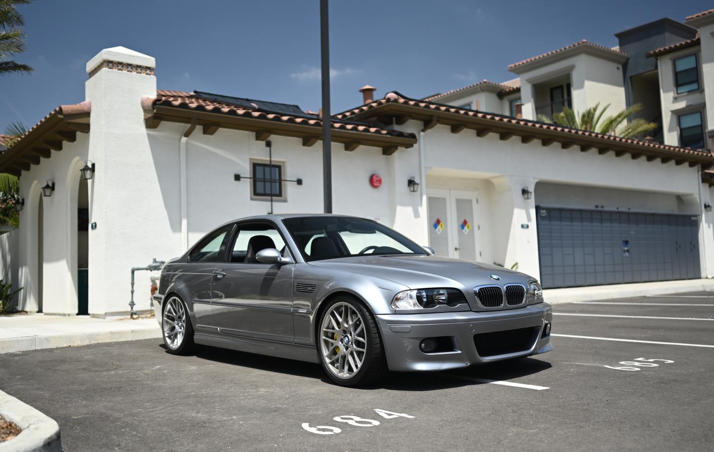

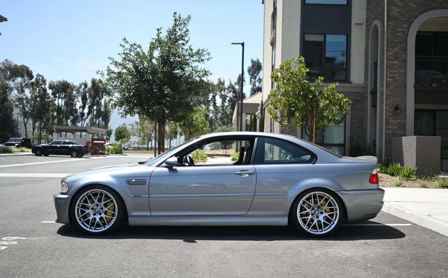

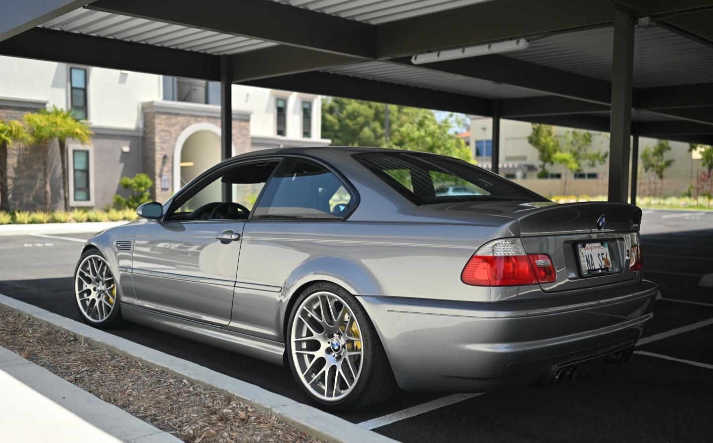

                                And some of my fav shots from the last couple of months wearing the CSLs:
                                Click image for larger version  Name:	E46Calixo (24).jpg Views:	0 Size:	143.7 KB ID:	358977
                                Click image for larger version  Name:	E46Calixo (14).jpg Views:	0 Size:	190.3 KB ID:	358978
                                Click image for larger version  Name:	E46Calixo (18).jpg Views:	0 Size:	139.6 KB ID:	358975
                                Click image for larger version  Name:	E46Calixo (10).jpg Views:	0 Size:	147.5 KB ID:	358976
