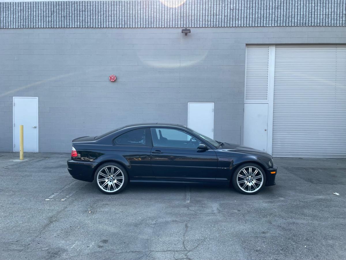

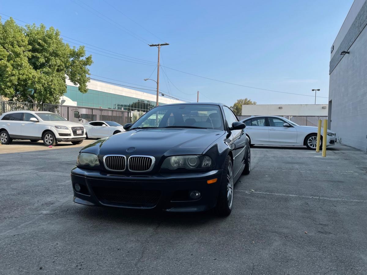

    One e46 m3 was not enough so I purchased another with the intention to restore it to new condition. Picked up this 2002 carbon black smg with 88K miles on the clock.
    Car was clean mechanically with no accidents but in terrible cosmetic condition due to being outside for a few years in the California sun not a big deal for me considering the price I paid since most parts would be changed.
    This car is meant to be minimally modified focusing more on restoring the car to new condition over modifications.

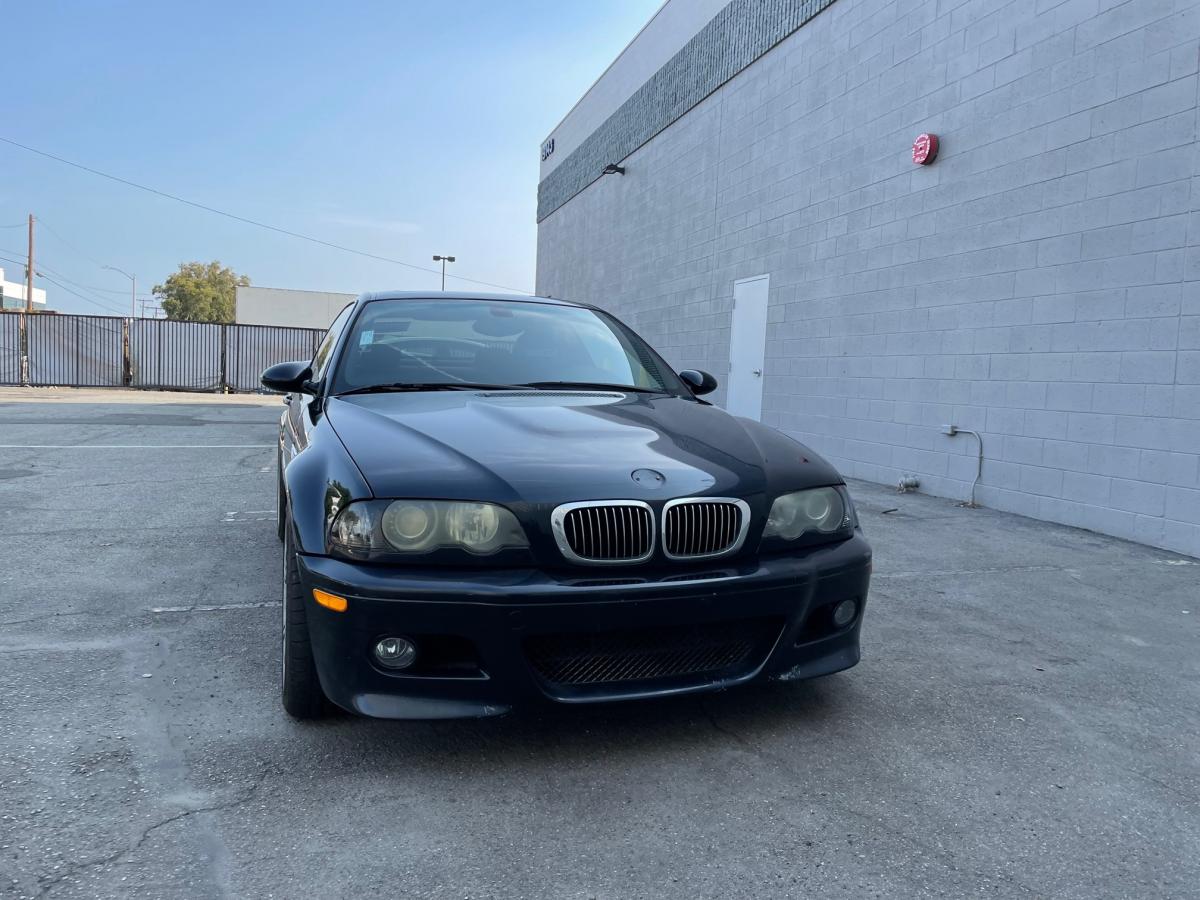

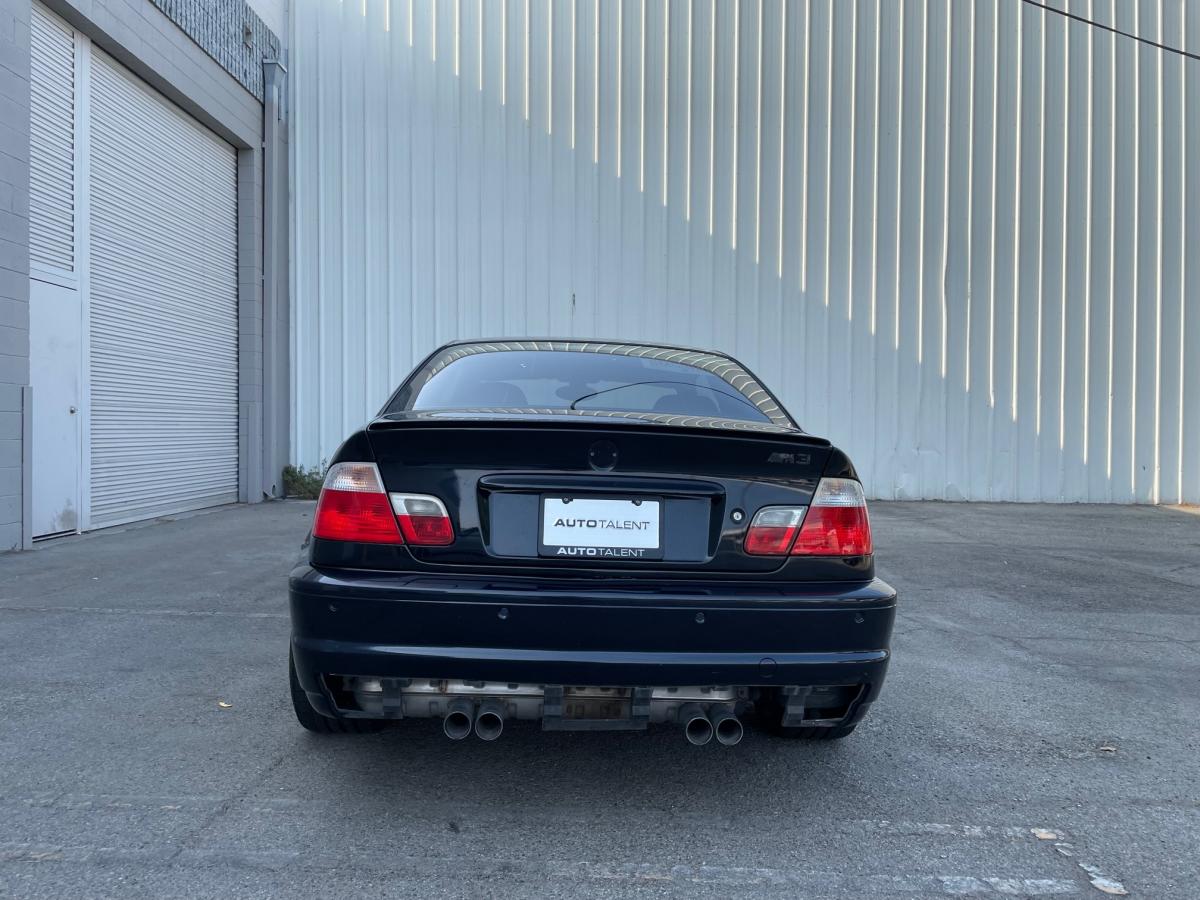

    Pics of car the day I brought it home.
    ​ Click image for larger version  Name:	1.jpg Views:	5 Size:	134.5 KB ID:	197885
    Click image for larger version  Name:	2.jpg Views:	5 Size:	152.2 KB ID:	197886
    Click image for larger version  Name:	3.jpg Views:	5 Size:	165.8 KB ID:	197887
    Click image for larger version  Name:	4.jpg Views:	5 Size:	153.0 KB ID:	197888

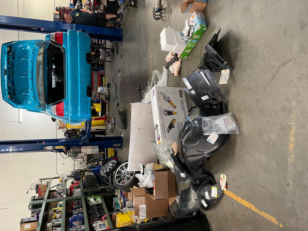

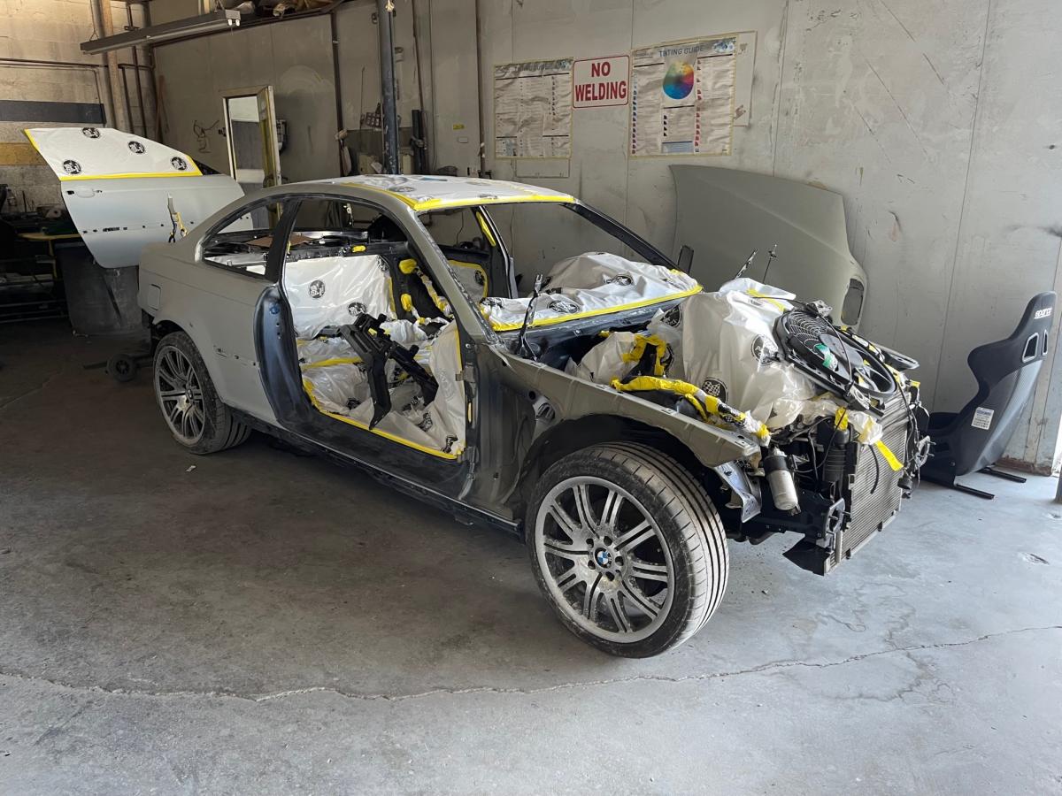

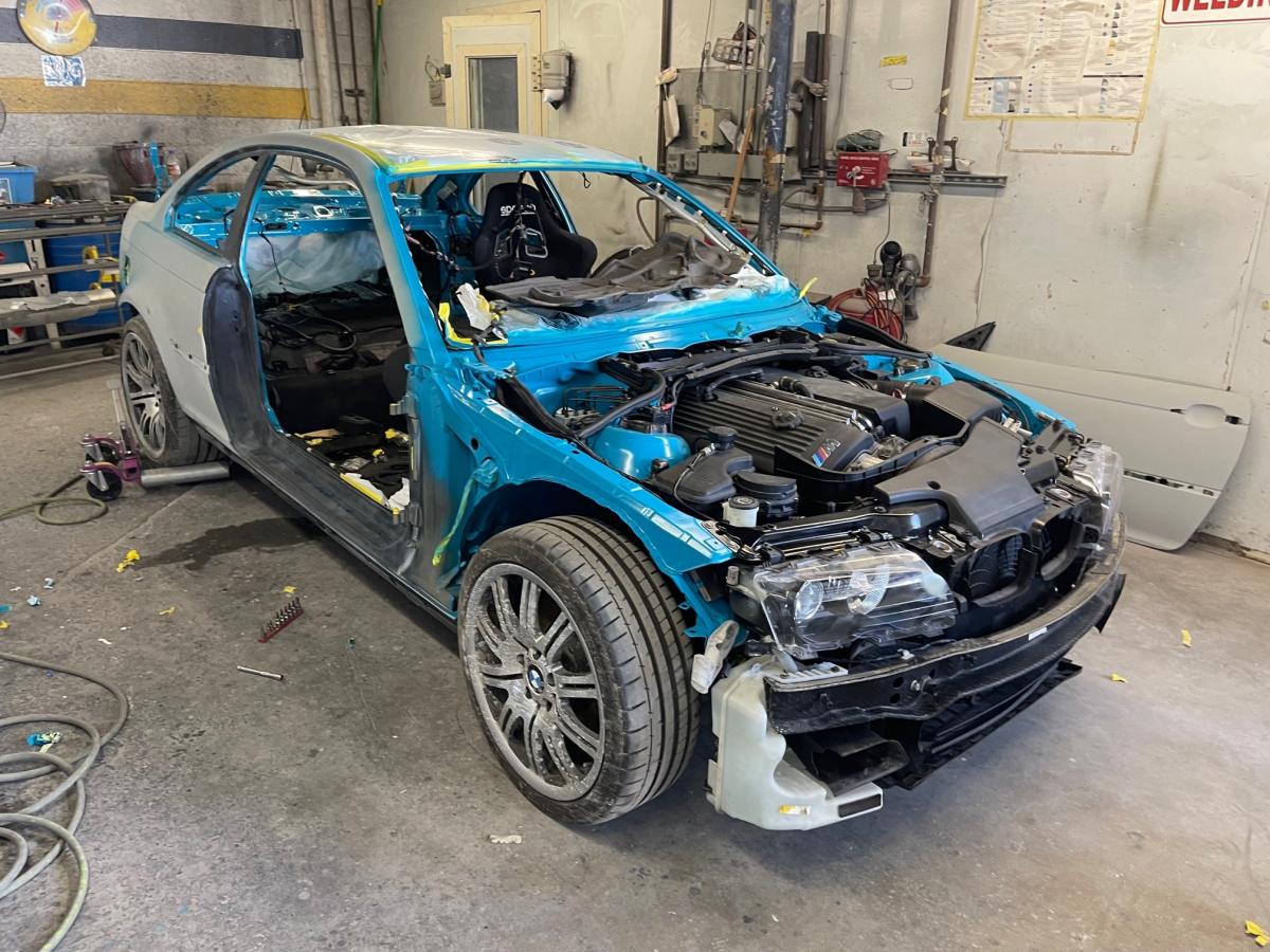

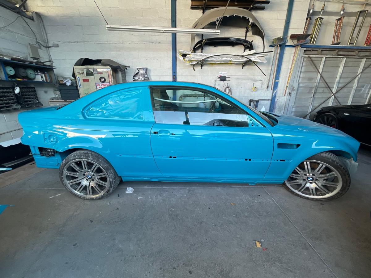

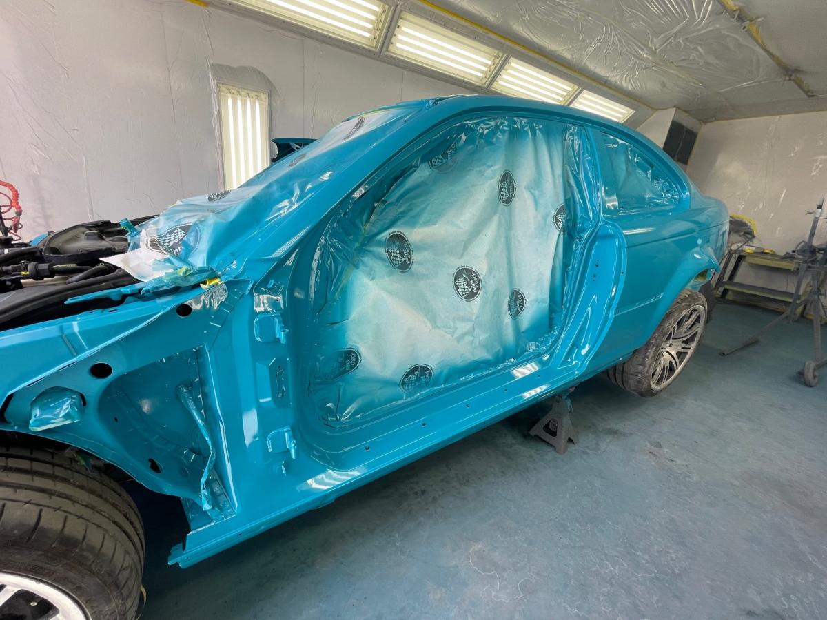

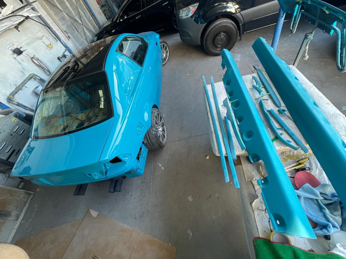

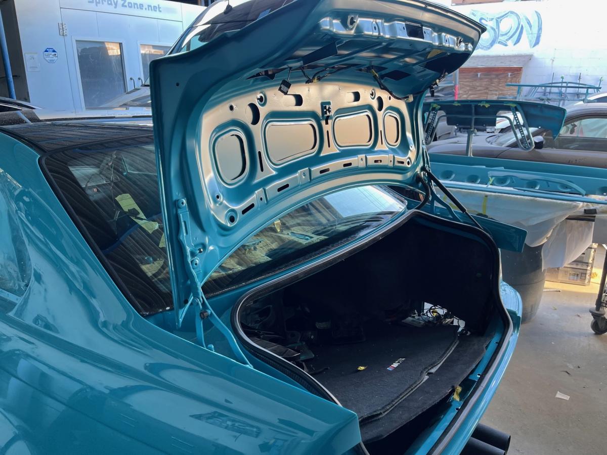

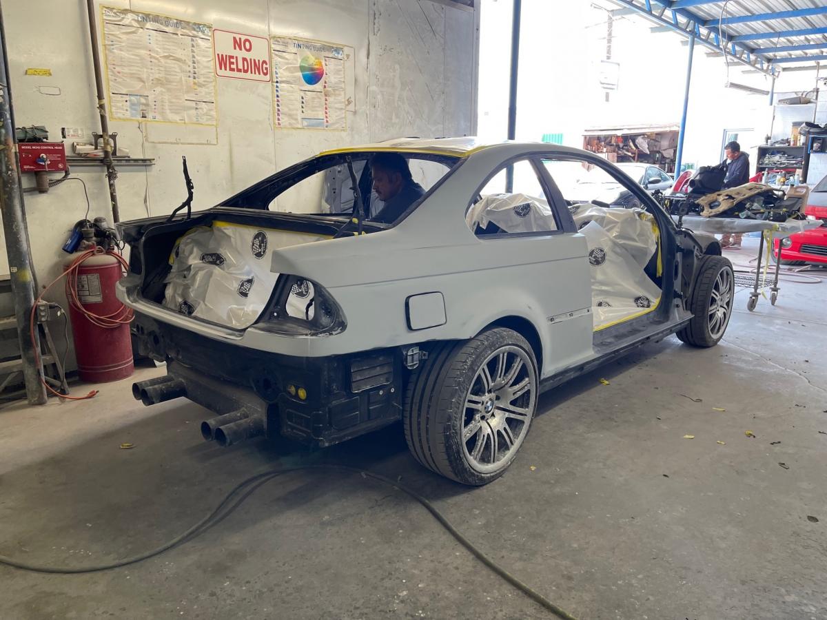

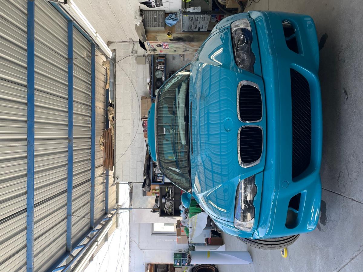

    Lets get the party started
    Click image for larger version  Name:	6.jpg Views:	0 Size:	161.1 KB ID:	197890
    Click image for larger version  Name:	7.jpg Views:	0 Size:	144.6 KB ID:	197891
    Click image for larger version  Name:	8.jpg Views:	0 Size:	189.1 KB ID:	197892
    Click image for larger version  Name:	11.jpg Views:	0 Size:	140.0 KB ID:	197893
    Click image for larger version  Name:	13.jpg Views:	0 Size:	155.7 KB ID:	197894
    Click image for larger version  Name:	15.jpg Views:	0 Size:	153.3 KB ID:	197895
    Matte underside just like OEM
    Click image for larger version  Name:	16.jpg Views:	0 Size:	151.8 KB ID:	197896
    Ready to go!
    Click image for larger version  Name:	17.jpg Views:	0 Size:	182.3 KB ID:	197897
    Click image for larger version  Name:	20.jpg Views:	0 Size:	163.3 KB ID:	197898

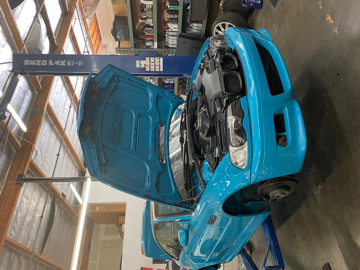

    Anyone know how to make the pictures not sideways?

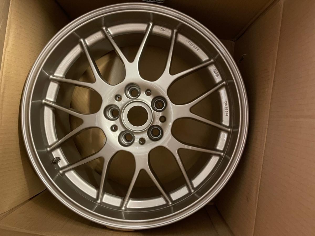

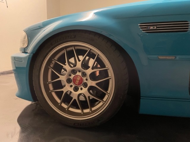

      BBS RGR from the white car painted in porsche white gold metallic

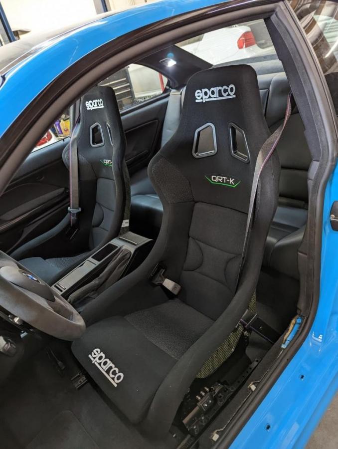

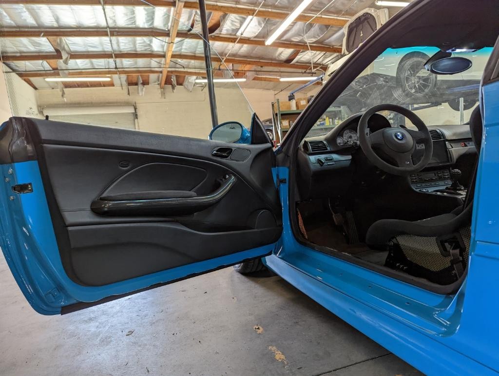

      Borrowing the seats from the white car.

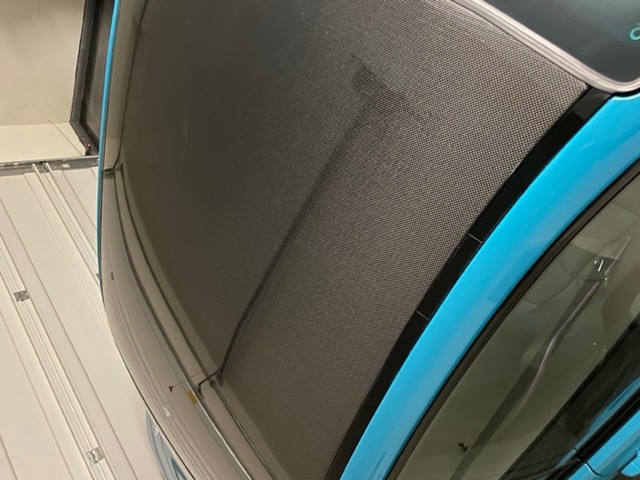

      RKP Roof with stock sunroof rails painted black.

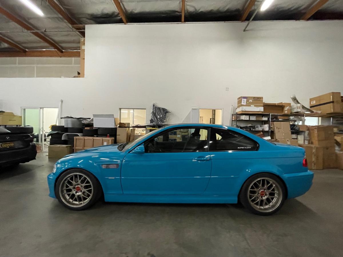

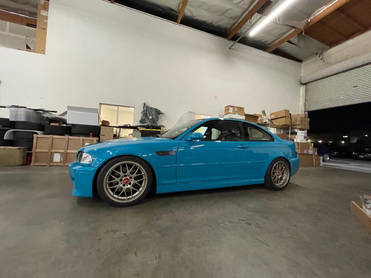

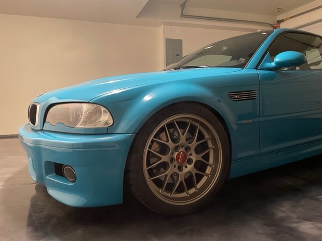

ID:	197911 Color is very difficult to capture in pictures. Almost looks fluorescent in person.

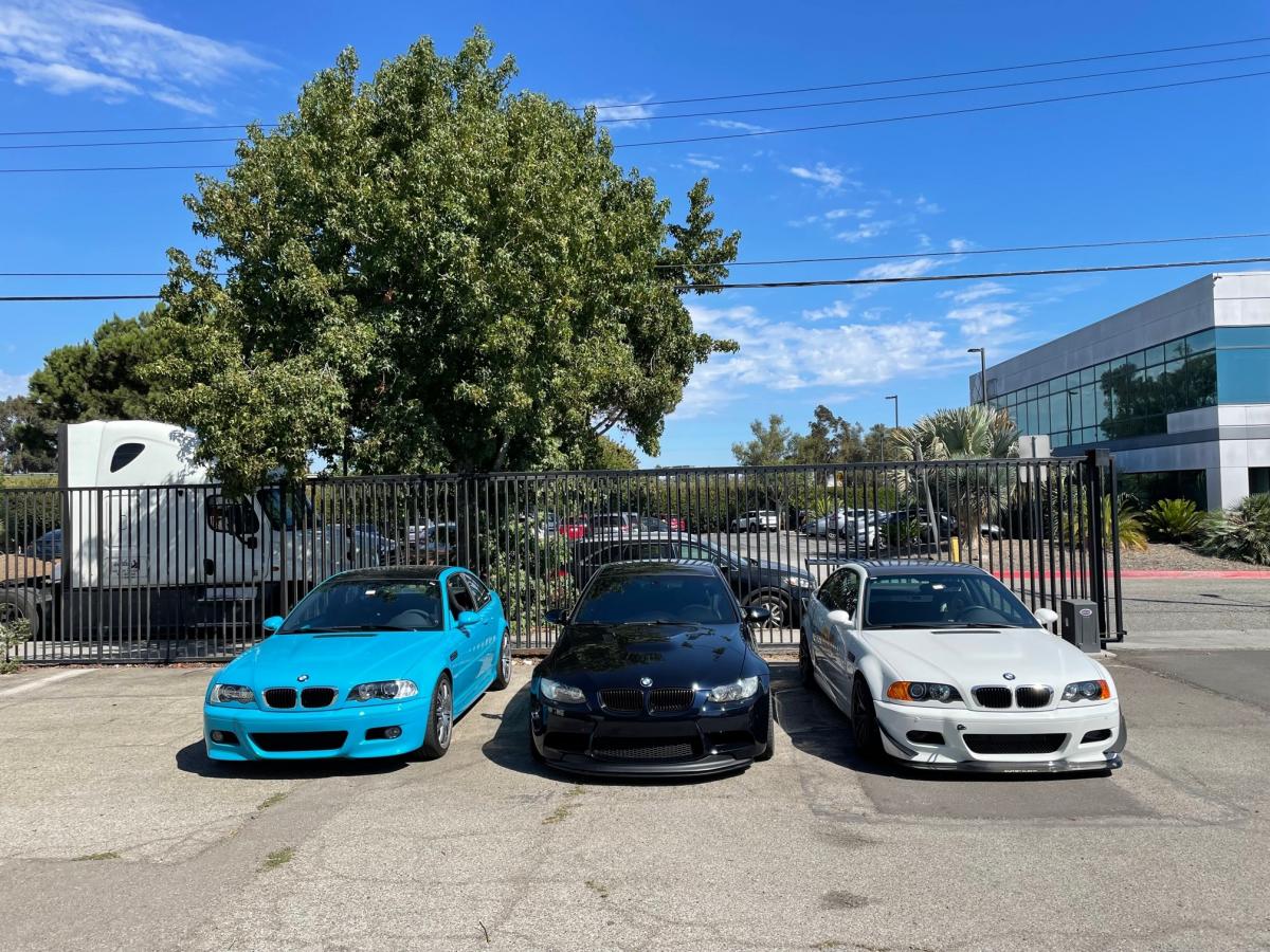

        Pic with all 3 of my carbon slick top m3.

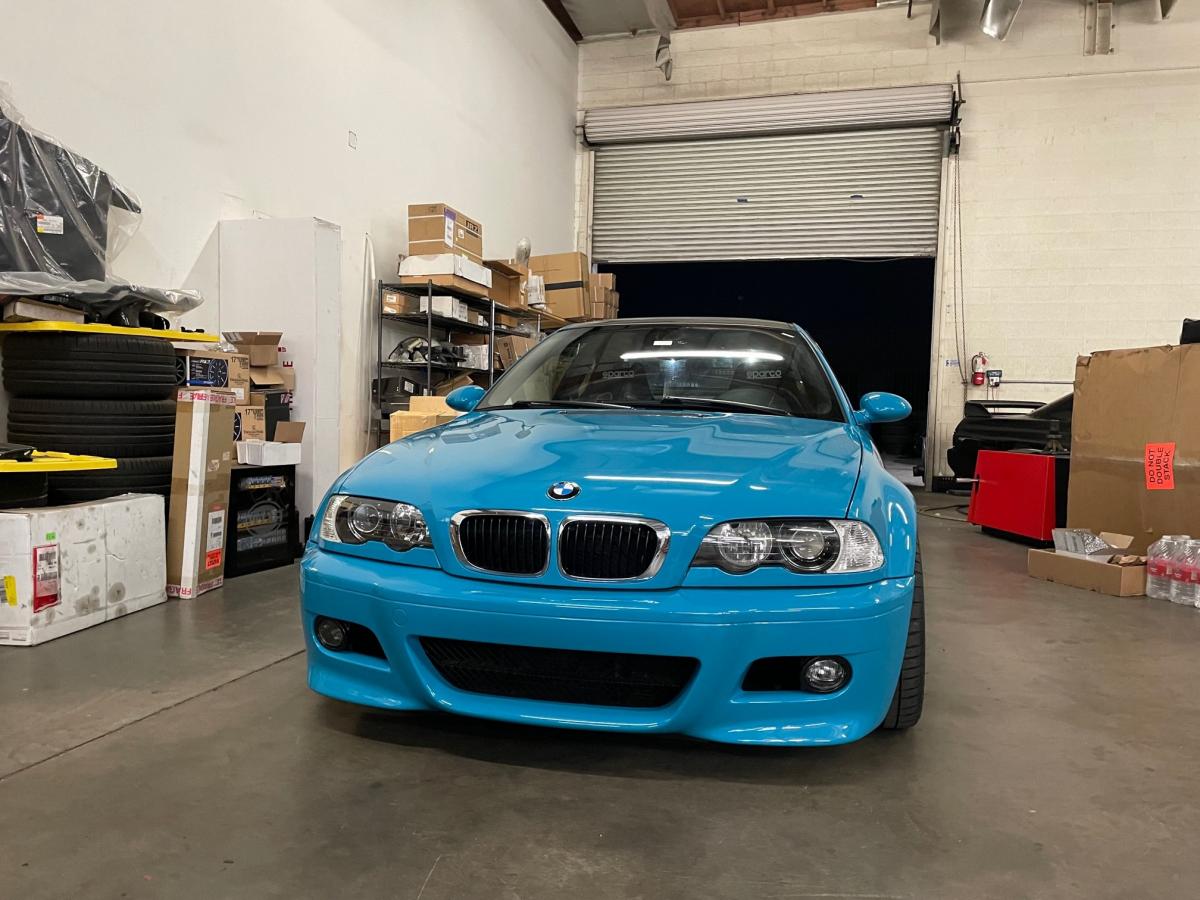

              The full color change members on this forum first to post. Any more? Really enjoying the m3 in a different color. Rosso and shark blue are also very great color choices. Enjoying the cosmetically new car.

                        Updates. Rid bearings and recaro ABE with some dry ice and laser cleaning.
