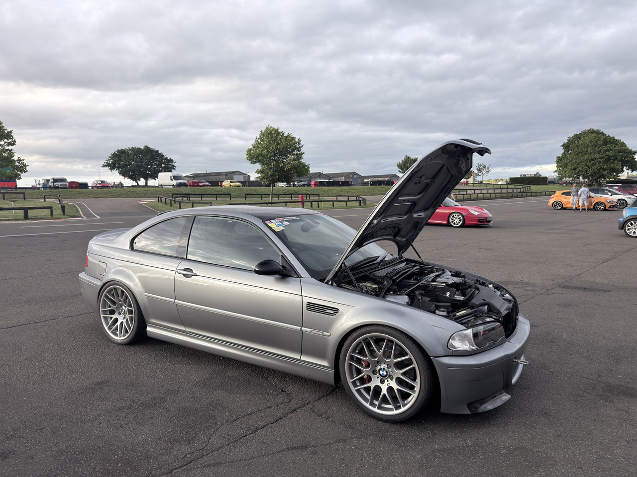

    Just some more pictures showing pictures of the different screens - still in the process of building one with all three screens on display at once, because as previously mentioned, scrolling between screens is not ideal.
    These temps were achieved after a short forray up to an indicated 140mph (rev limiter in 4th):
    The diff and gearbox never get into the green (above 80°C / 176°F) unless on track.
    For reference on the CSL, the last oil light on the rev counter goes out when the oil is at 65°C (149°F), which is a smidge above 75°C on the gauge (165°F on the US gauge)
    I forgot to post the track temperature data (too busy enjoying the day to take photos):
    Some interesting temperature data figures from the above track day.
    27°C (81°F) ambients
    Longest session: 20mins
    Number plate removed for max airflow.
    Aircon on max all the time.
    On track peak water temps 89°C (192°F)
    Air intake: 32°C (90F) (spiked at 78°C (172°F) queueing for the noise test).
    Transmission: 118°C (244°F)
    Engine: 116C (241°F) (dash gauge showing just over 3/4 - 125C(257°F))
    Diff: 114C (237°F)

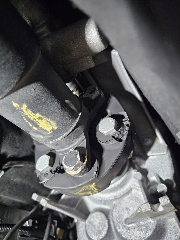

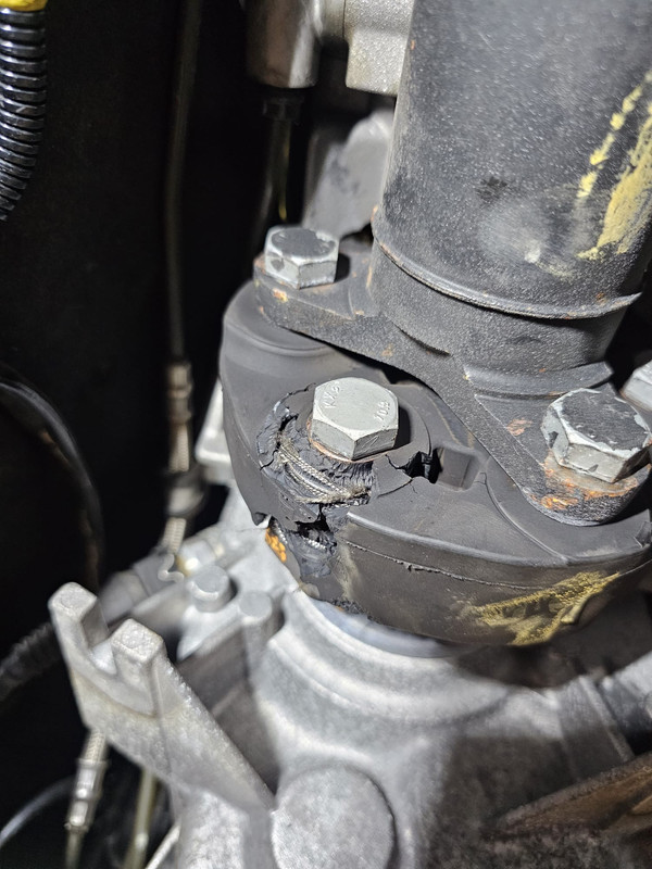

              I have recently been having some gearbox lag issues that felt like the clutch was being briefly dipped when getting back on the power after hard braking. It seemed to get worse the hotter the transmission / diff oil got, so at first I thought it might have been the diff (see video for symtoms - ignore the short-shifting on the back straight, this was because I could feel that there was some fuel surge (not the symptom)). The worst case of it was just after 8mins, where it pitched the car into a slide (like you get when clutch-kicking wjen drifting):

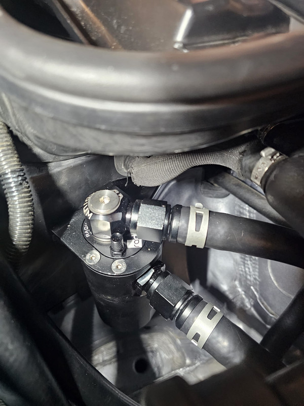

              I took it in for a check-up and to have my Radium catch-can fitted, where I discovered that the centre prop doughnut was completely shot:

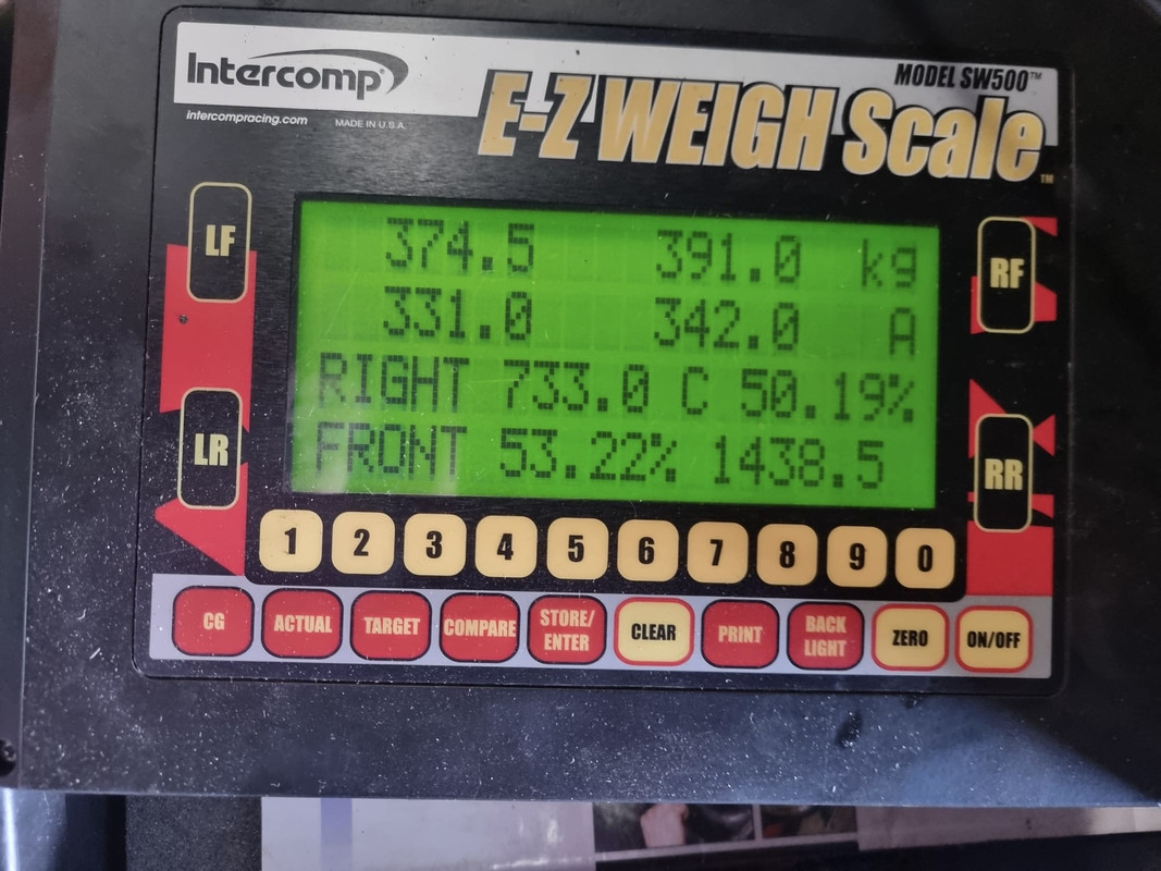

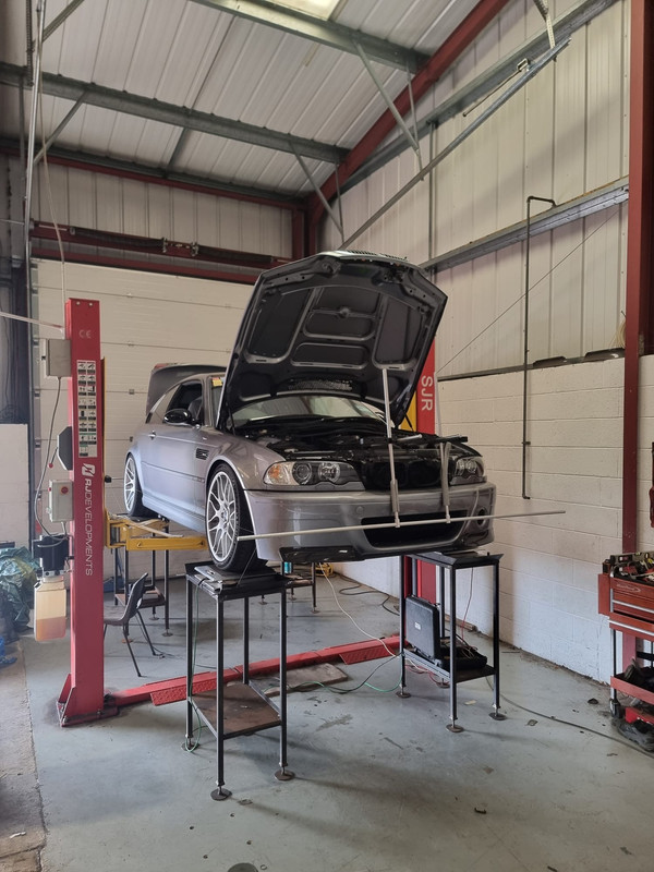

              I run an E36 M3 Evo plated diff, and checking the oil, it was perfect (I change it at every service). One of the dampers needed a service, so I did all four and took the opportunity to redo the geo to be a bit more aggressive, as I could see I still had more to go from the tyre wear. Now running 4° on the front and 2.5° on the rear.
              Corner weights with full tank of fuel (absolutely brimmed):

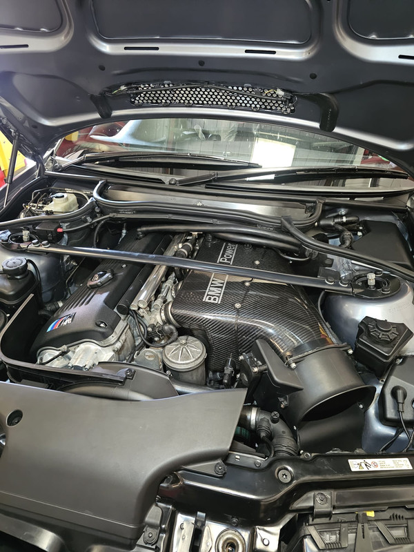

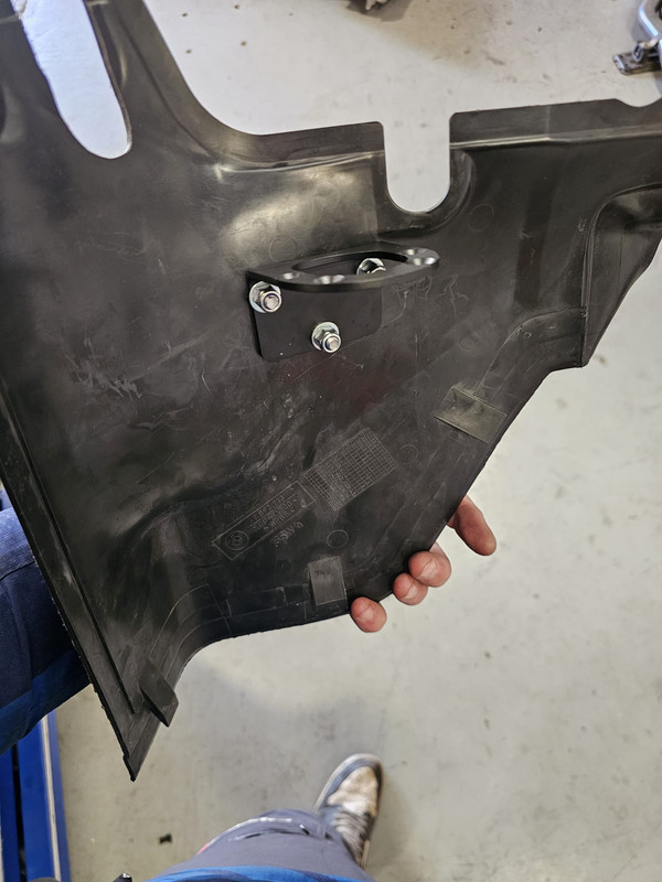

              I've added some weight back in the car with the Radium catch tank and Bry5on 's exhaust brackets (I also forgot I had a litre of top up oil in the boot, along with the first aid kit that I usually remove, which would account for a a couple of kilos ).

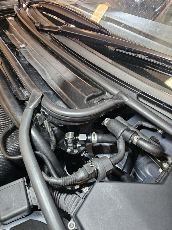

              The Radium catch can - being designed for LHD cars only, I bought the universal fitting kit and installed it here:

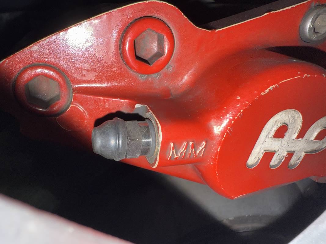

              I also fitted some titanium bleed nipples on the AP brakes, as I had a couple sieze on me last time, which actually cracked a caliper getting it out (excuse the state of them, picture was taken before the car was washed ).

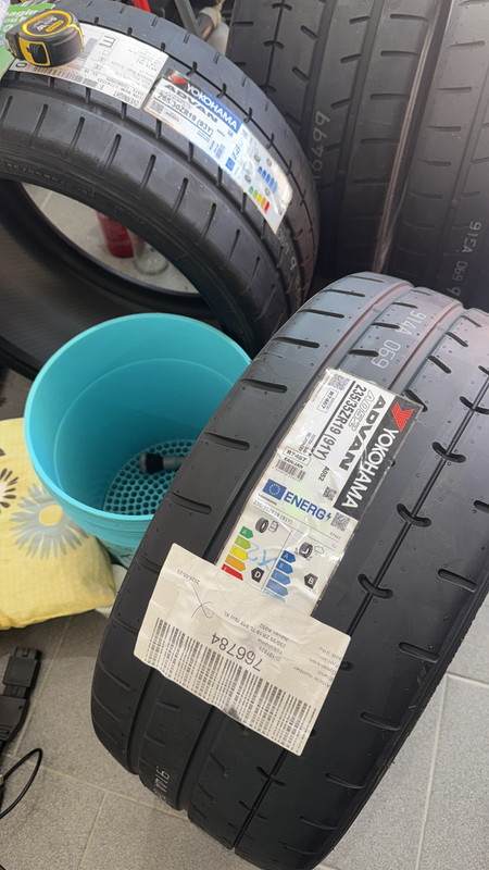

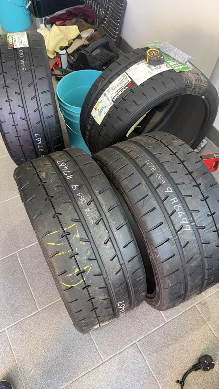

                    Nothing much going on apart from still enjoying the car. I've switched to AO52s for track to gain some grip, but having done just one track day with them, I have yet to really lean on them, but initial impressions are that they are much better than Cup 2s, but have zero rim protection.

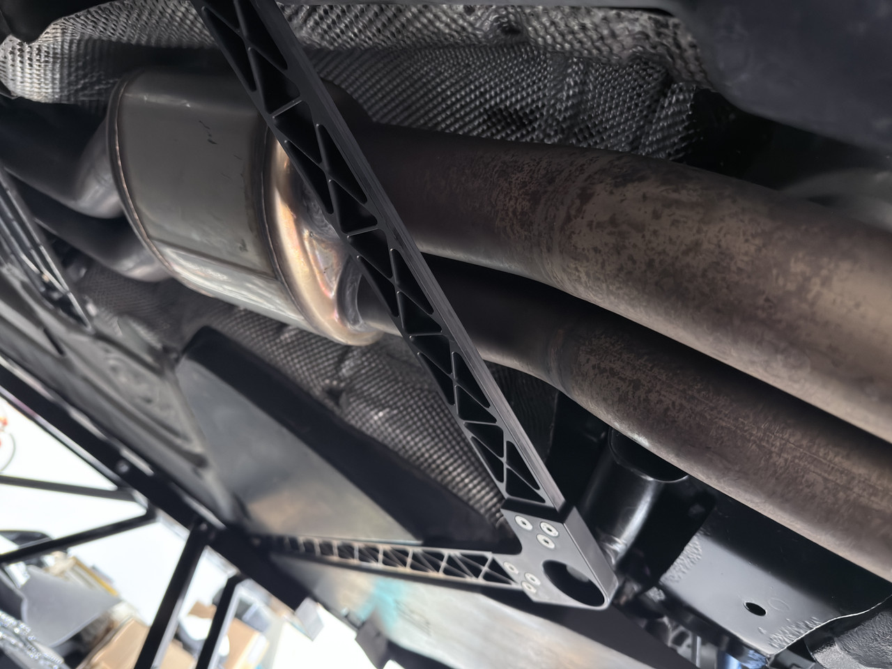

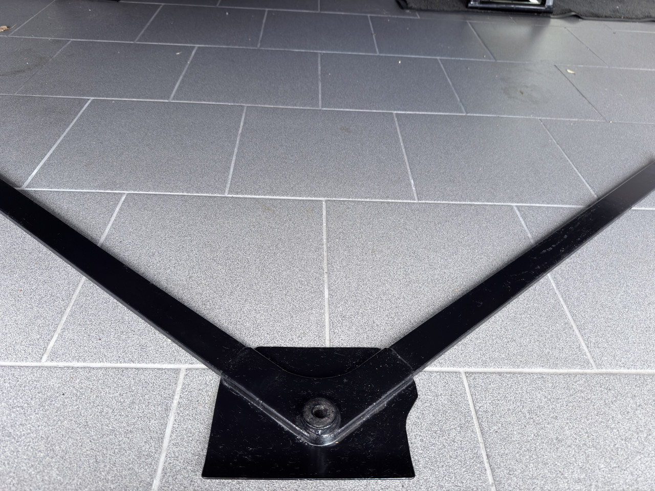

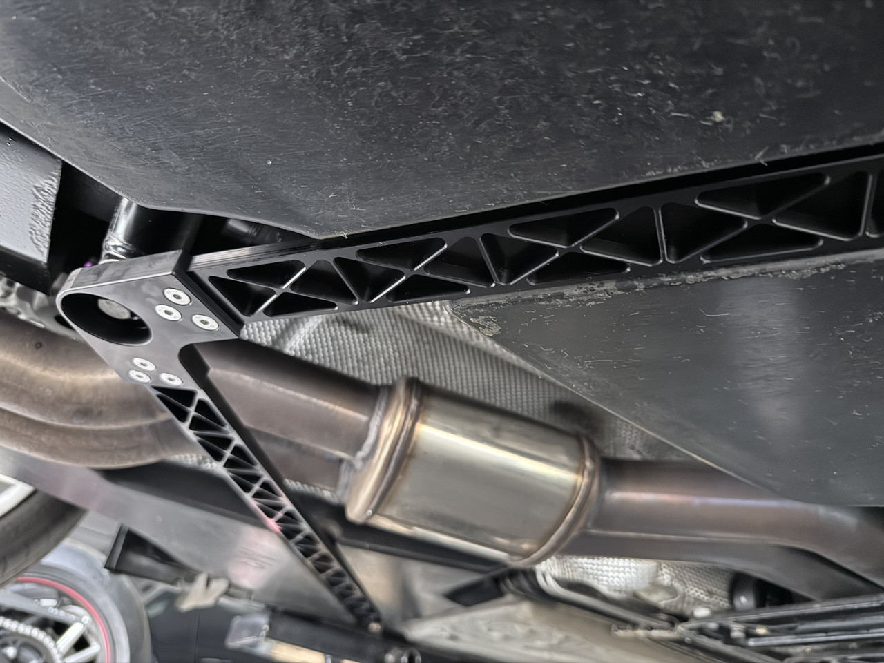

                    In my mission to keep dropping the weight down, I have subtracted another 1.6kg with a billet alluminium Y-brace, replacing the OEM steel item:
